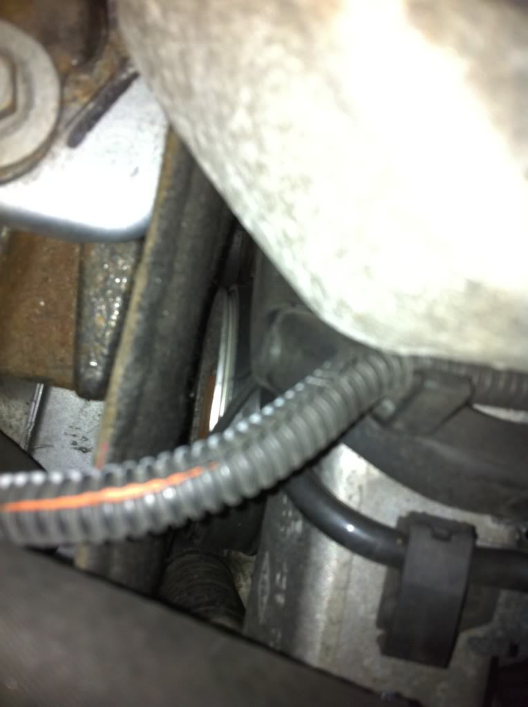

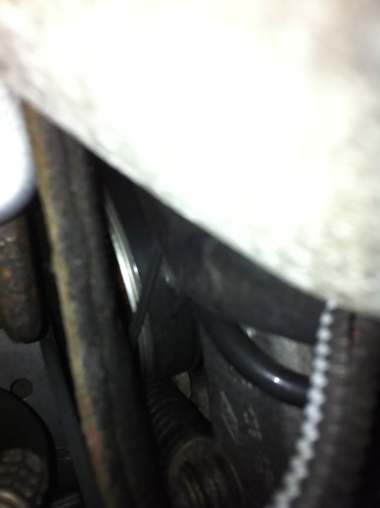

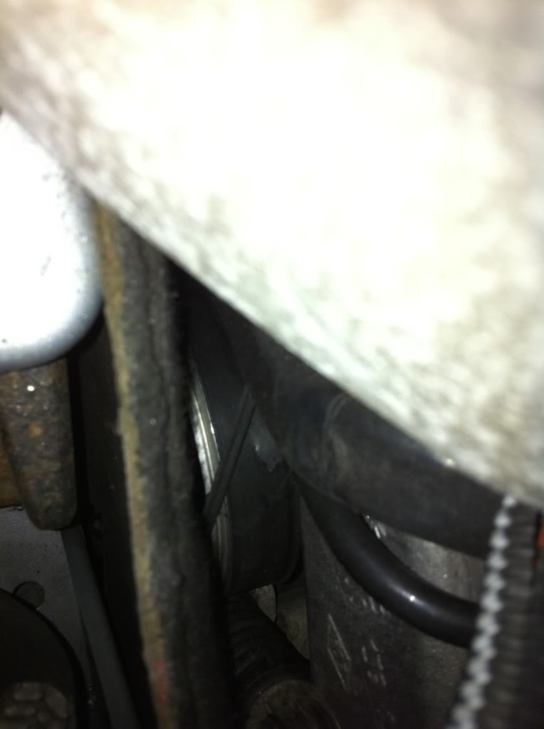

Just started Erving my car test the Decat and something went wrong and it now sounds like a bag of stones inside the engine!
What can it be?!?

Aux belt has shredded, i had this on mine.
hopefully it hasnt done damage.
when was the cambelt/aux belt done?

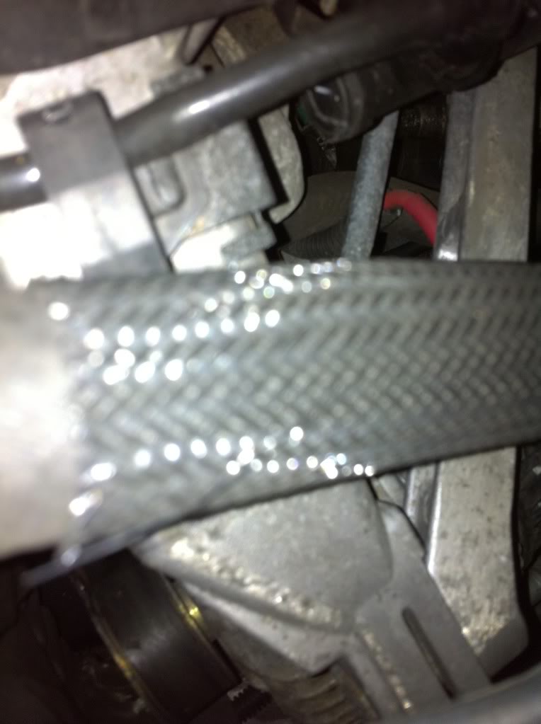

first i would want them to look at what caused the belt to shred in the first place rather than just replace it for it to happen again.
  BlackGold 182
well i just read on yours karl about having a loose alternator bolt? one of my bolts isnt completly in but it wont seem to go in, so maybe thats what caused it?

I'd cut that belt off and do a compression test on it to see it hasnt jumped into the cambelt and skipped a tooth. You say it sounds liek a bag of spanners, that cant be healthy
