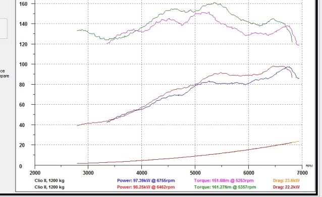

V6 airbox power lost
  A dieppe product
Red line is stock airbox,blue line is v6 airbox
I don't understand this:dapprove:
Isn't this covered in the sticky at the top where the conclusion was that to just replace the air filter itself, not the box, is the best option? As it's already very well designed.

You may not necessarily see the benefits of an induction setup without a remap to suit, are you running the standard v6 internals or similar to the jms setup? whats the induction noise like?
This is quite a valid test i might see what losses my itg maxogen gives me lol, never thought to do back to backs using the rstuner.
just noticed that the drag is higher on the run that made less power so wind may have been half your problem.

when i put one on my car i was not convinced either
swapped back and stopped with the standard setup
as said yo may need a re map for it to suit the change
