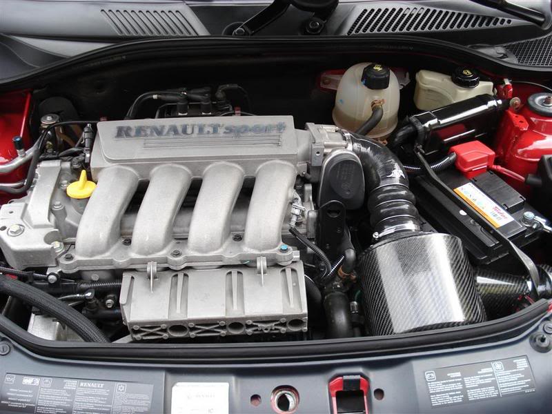

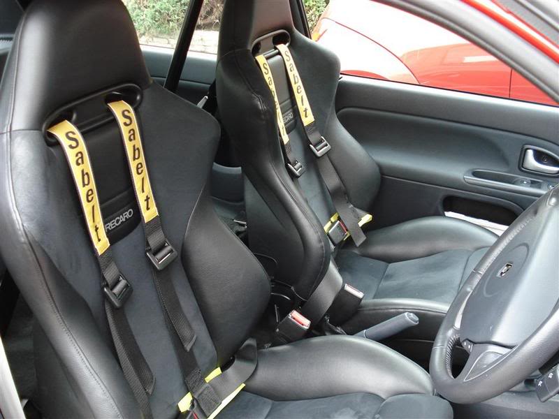

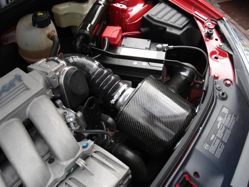

Had some toys fitted today and am happy as a pig in sh*t with the results, the ITG Maxogen complements the exhaust really nicely, fairly quiet until you bury the pedal then the sound is immense, and after tucking my chunky bits into the harnesses had some fun on the 115 mile journey home.

Can feel so much more through being pinned to the seat than before and I wasn't afraid to push harder into corners than I ever had before which is a big plus for me.
I wasn't at all tired during or after the journey unlike normal, another benefit of having these fitted, all I can say is bring on the ring as soon as possible :)

Maxogen is a brilliant bit of kit! Bought mine about 3yrs ago and i still regard it as one of the nicest mods i made...
Not a fan of the harnesses, same as we've got in my dad's classic, but in the clio it looks really out of place. epc over the lovely recaro's!

You'll get flamed for having a maxogen.
According to the tap room specialists on here you'd be better off with a ph1 airbox and a panel filter. I mean, what does Mark Fish know :rolleyes:

So loving those seats!
Whats the name of the maxogen IK, and where does the air feed go to on it?

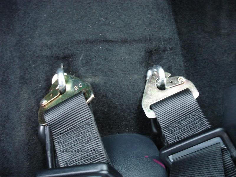

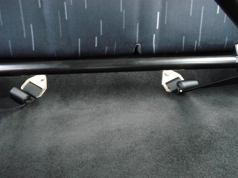

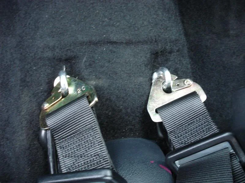

if your harness is connected to the rear seatbelt bolts then i will be seeing you in a wheelchair after you crush your spine in an accident.
note to self: don't get harness fitted by mark fish.
  182 inside
harness should be fitted with rear restraints 0-30 degrees angle from shoulder/over seat. no more angle otherwise when pressure is forced( accident) the belt pull at an incredible angle which crushes your back/spine.

So Mark's 20+ years experience is wrong eh, what would he know?

can see the the logic in it!!!
