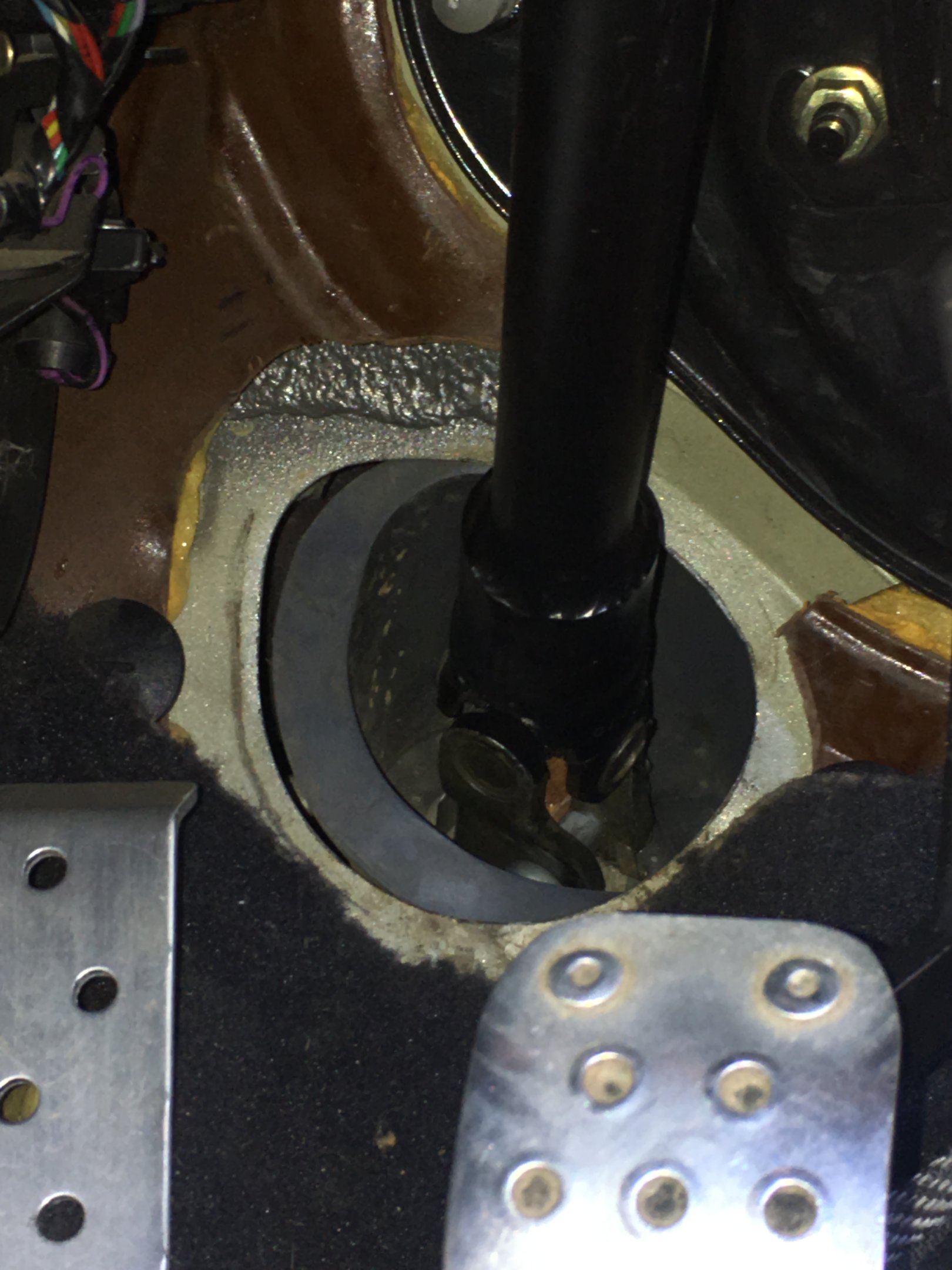

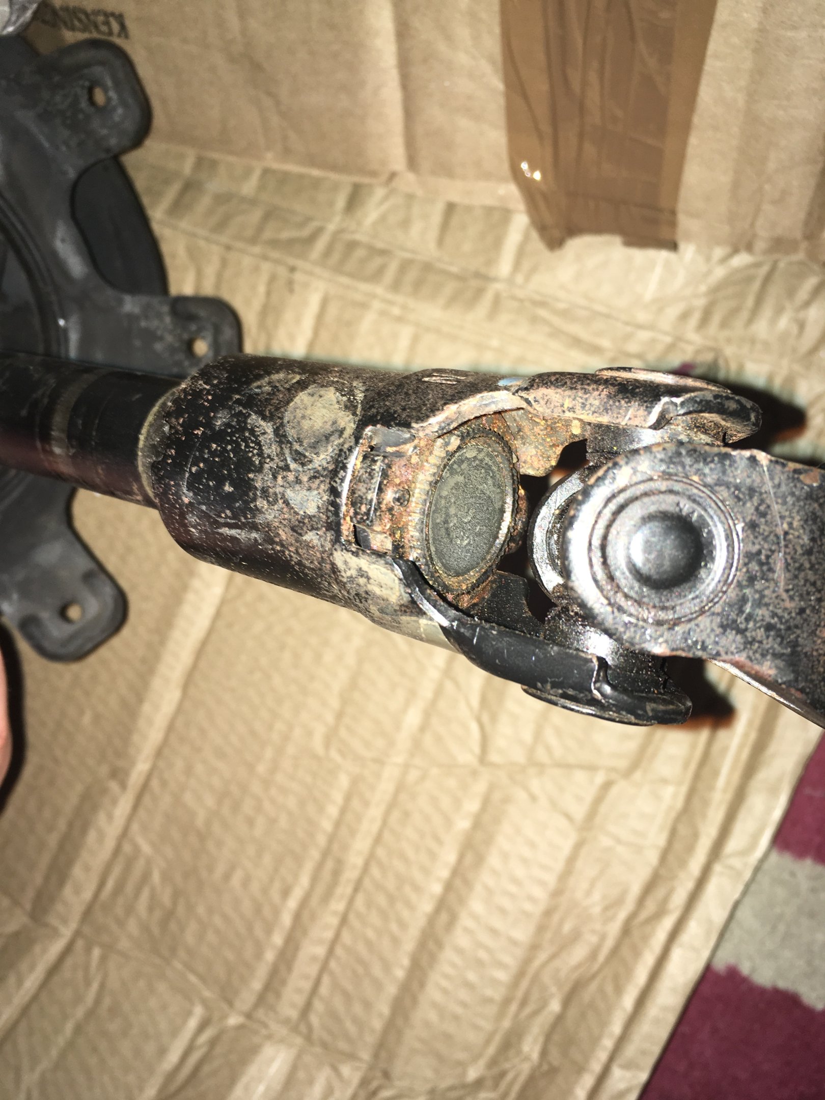

I’ve just bought a column off eBay but its clear that there would be play in the steering as even though its not a lot you can twist the joint slightly from the splines or whatever it actually joins on to.
Has anyone welded or got the joint welded and has it lasted? My 182s not even on 80k yet and its dreadful, cant imagine what some are like upwards of 100k though dont really see much talked about this?

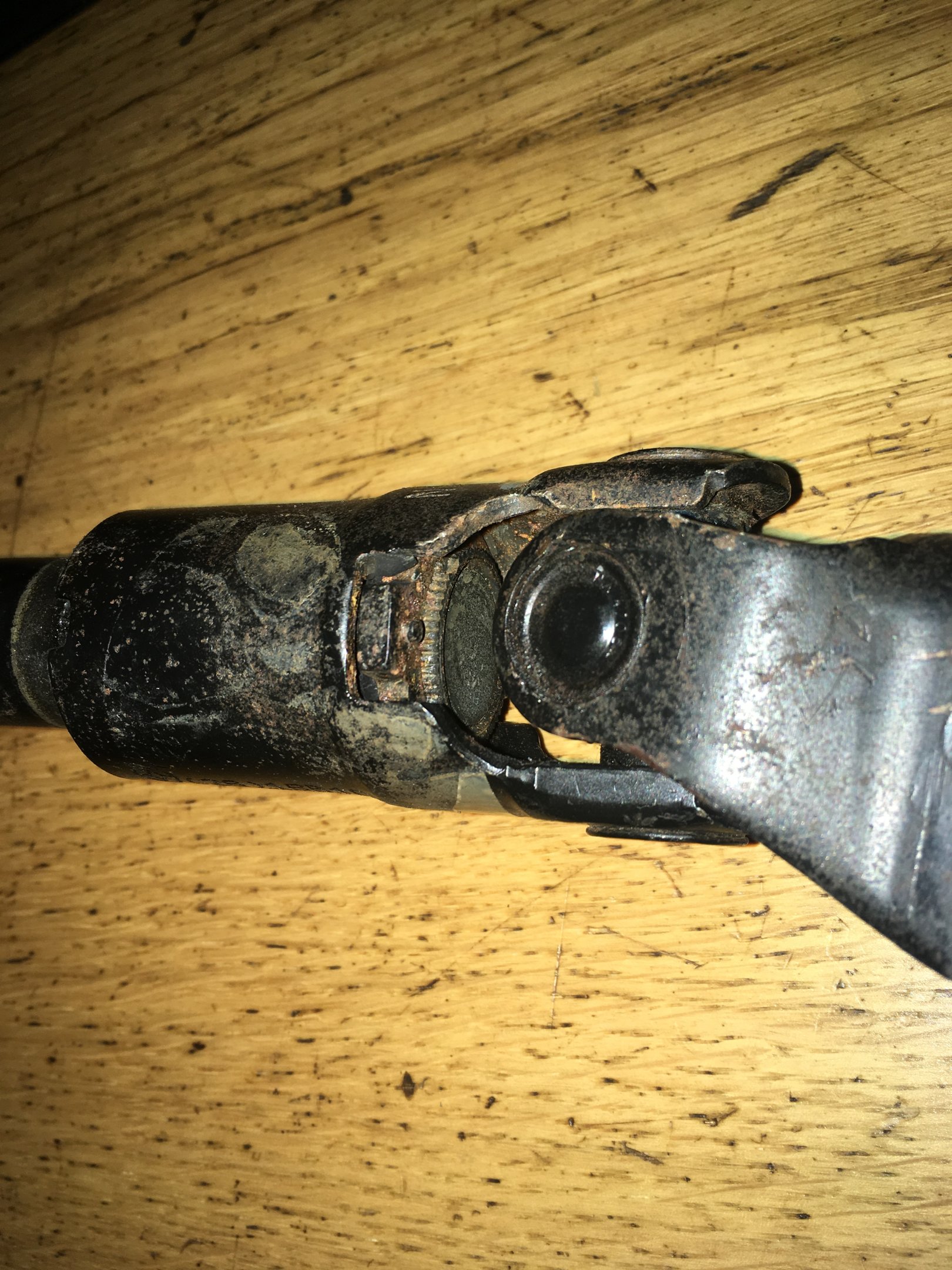

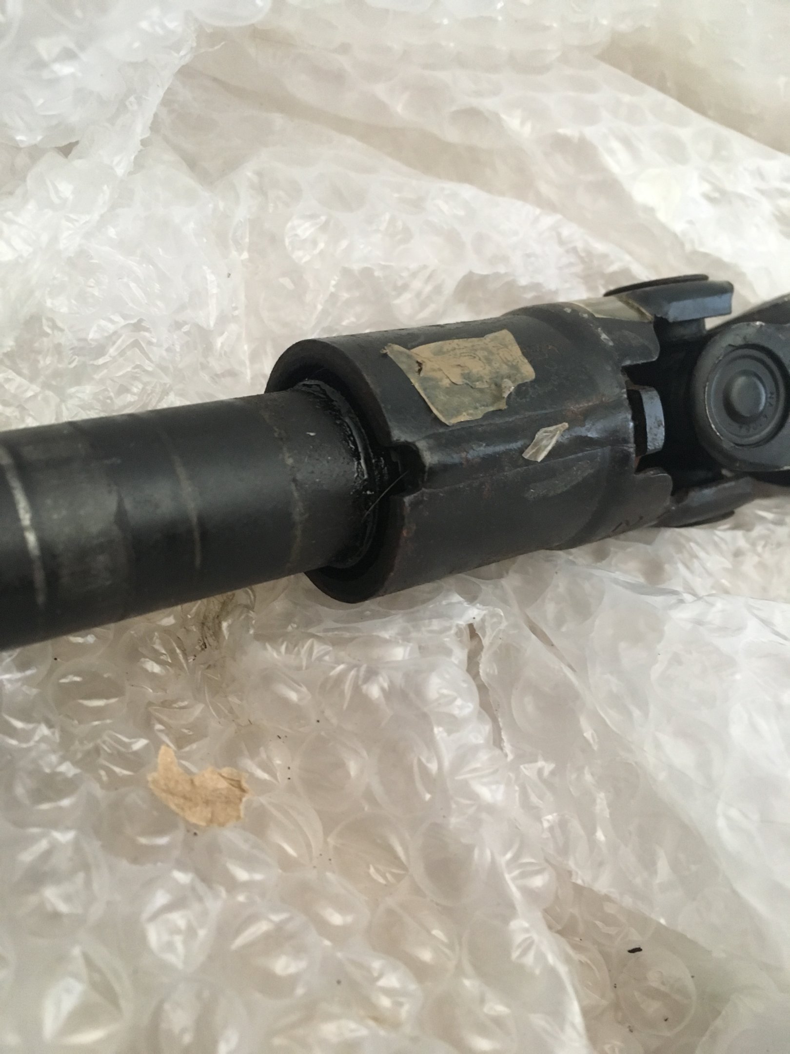

I just had another look and think it is bushed.. Its glued on with some rubber, nice and stronk ?
Do you reckon it could still be welded or is there anything else that could be done? I originally looked at new ones but they were 200 quid odd
Id do a video of my current one while driving but just had a cv boot burst. its unreal though, about 30 degrees of steering does nothing..
  dan's cast offs.

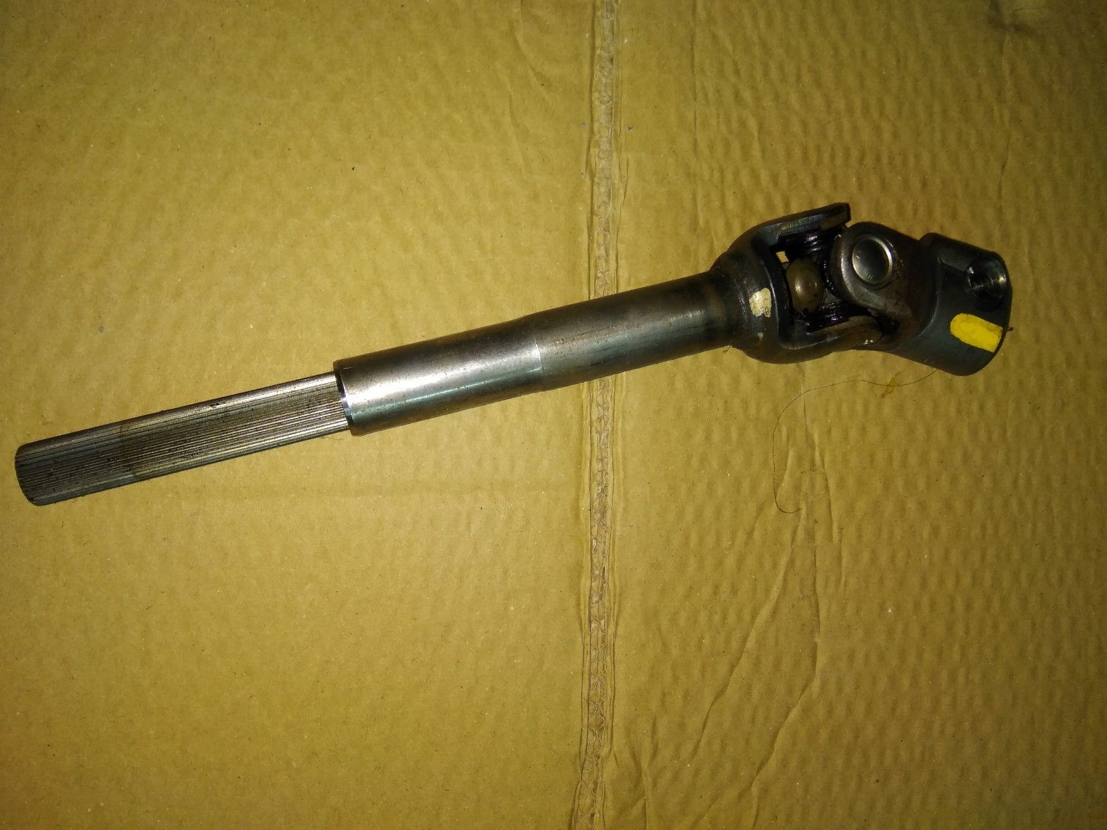

you can't weld it, fwir it's in a sleeve of rubber so would be a nightmare to do. why not get a uj, chop the bottom of the column off and weld it on?

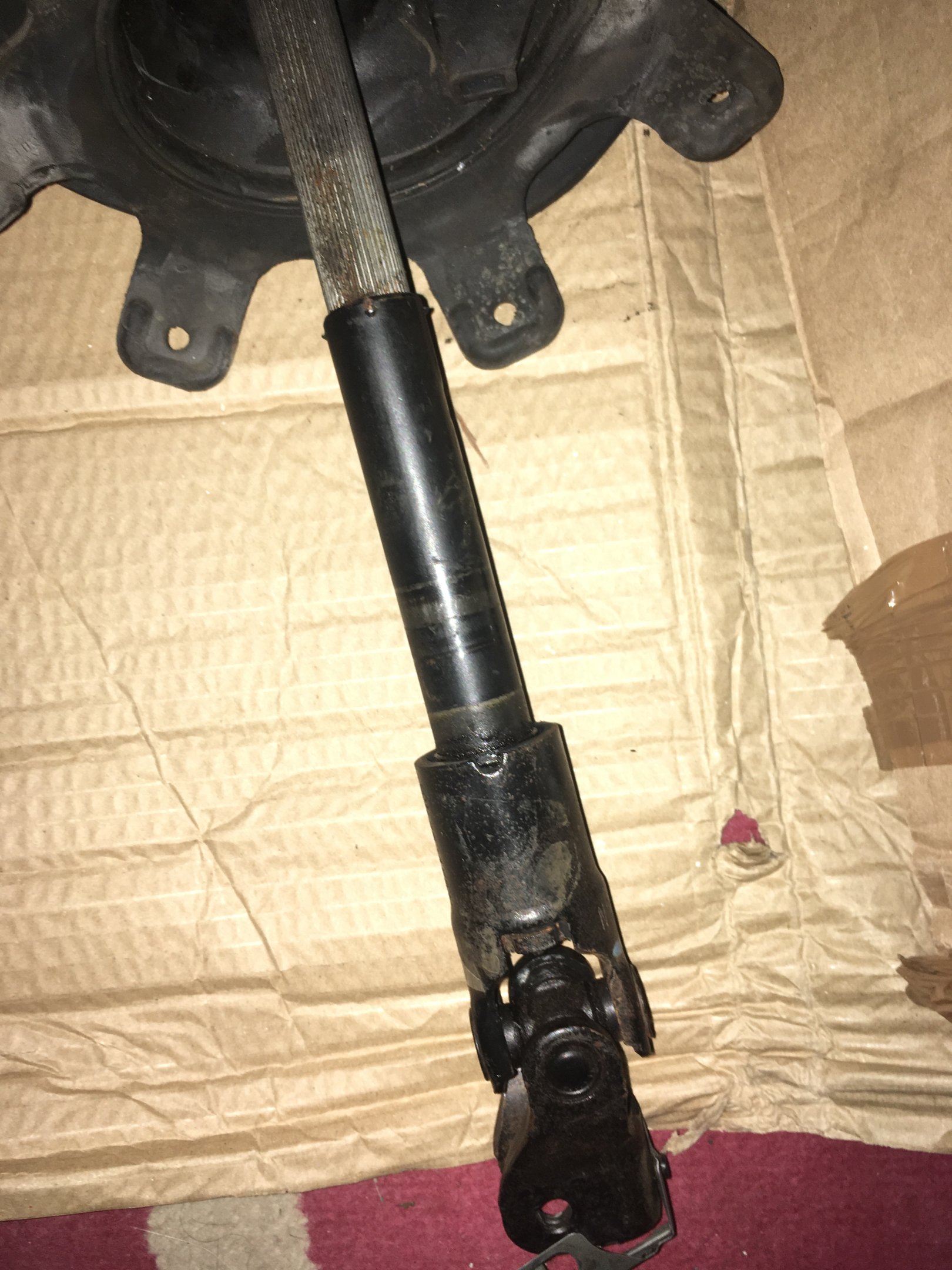

Unfortunately this sort of thing is out of my hands and am new to all this as well. So the uj is attached onto this sleeve with the bushing and the sleeve goes onto the splines.
If I understand this is the sort of thing you mean? joint welded straight on?

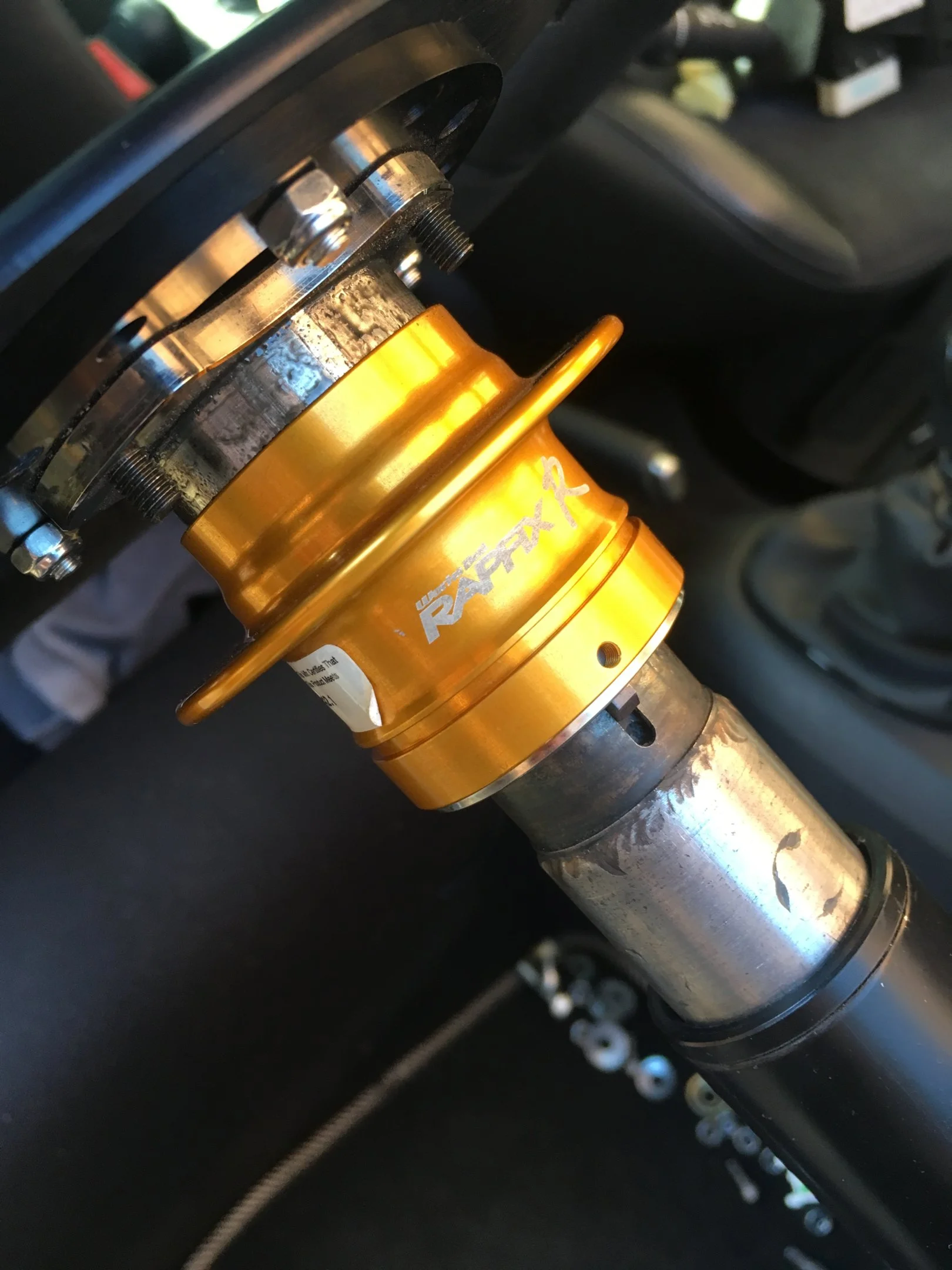

Common to weld these up on mk1 clios so don't see any reason you couldn't weld a mk2 column

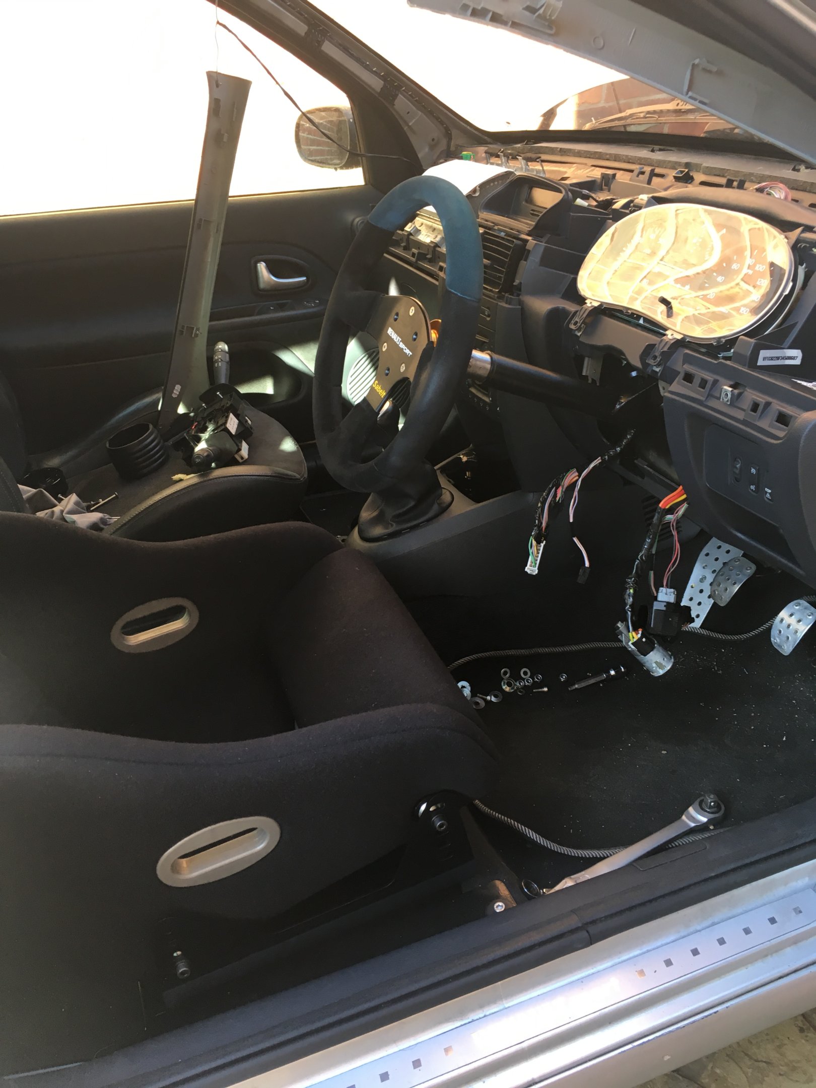

Well was gonna call up a couple of people the other day but called pms first and instead of getting mine welded i bought a complete custom one from their old ph1 complete with a weld on quick release. Spoke to nick who was great to deal with and who drove the car aswell so knows his stuff. If it’s the rack aswell then least Ill have a solid column and a better design anyway
Well, so far so good, havnt drove it yet ? but looks to be instant reaction when turning the wheel so definitely an improvement. Will test later after traffic.

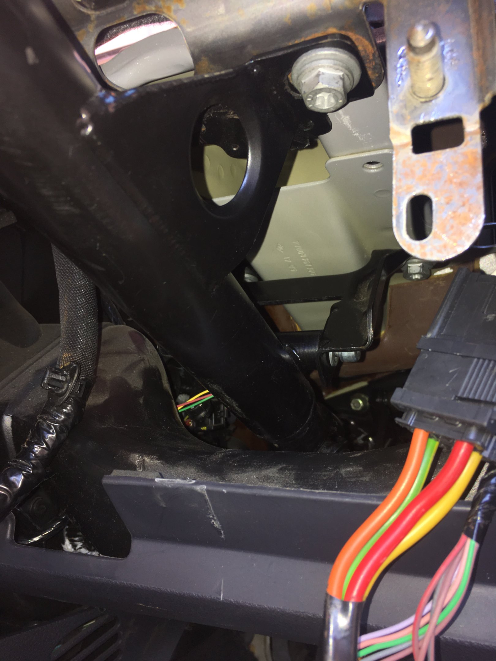

Will have to either bodge the ignition somewhere or thinking of getting a basic spec dash light dimmer panel to cut out and have the key there which I think will look quite good
