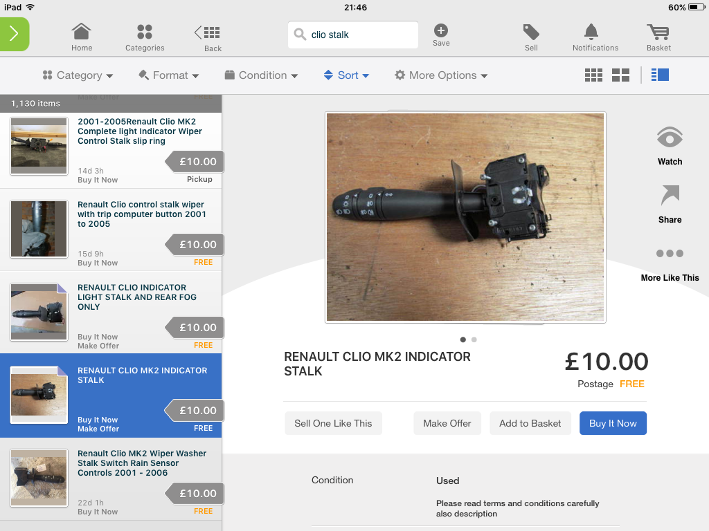

It sounds like you have had an aftermarket steering wheel on at some point and some body has removed the front fogs or done a pikey move on the wrong type of horn stalk - you can get 2001 stalk with horn and both fog switches.
And yes a piece of p1ss to fit.
mossyv6
  Trophy,V6,5GT,AG200
Put an offer in on this and possibly £8 delivered mate.
