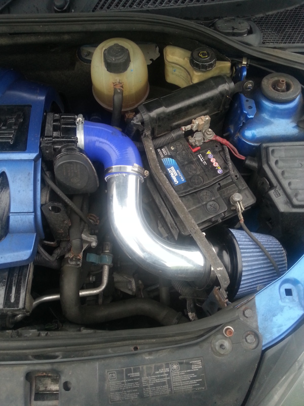

i got mine of ebay, was 18 quid for an alloy elbow, 70mm diameter, 90 degree bend and 150mm leg lenght, although some people might want shorter, but you can cut it
  Changes to often
egnor the green extention on the filter, i cut the elbow short because im getting a slim but long green cotton filter to go in rather than that horrible dirty blue thing lol

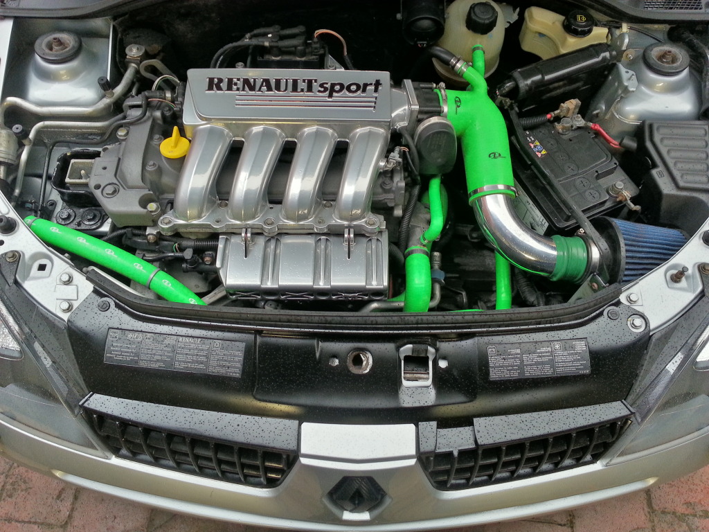

Bought off Danith for 45 bucks. Best money ive spent on the car so far!
The elbow is a Hillpower one with th fitment there for the breather.

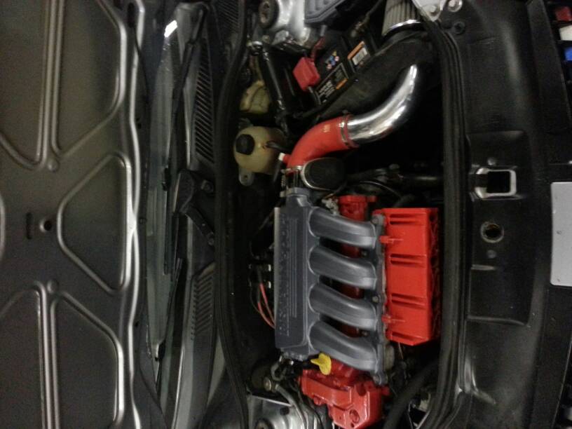

Im using the standard plastic elbow, that alloy bend and that twin cone filter.
Sounds crazy, not sure on performance, hard to tell if theres any changes lol.
Fitment is a bit tight, I need to sort mine out properly and get the fusebox cover back on.
