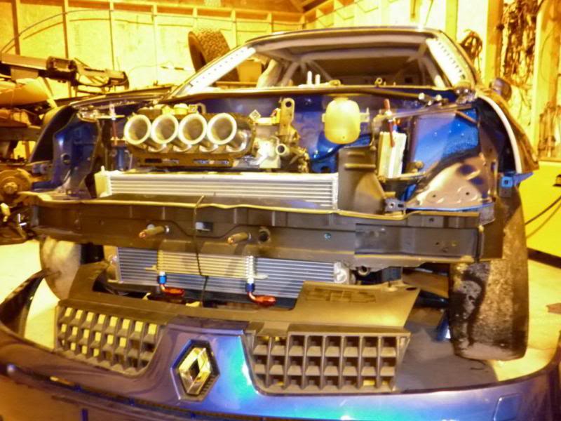

This is a mk3 golf rad as you can see it sits low and covers the front of te car meaning it will get the best airflow possible. Just a shame the power steering pipe will get in the way , electric rack is an option but the saxo pump is a couple of wires and two pipes to join.

I got one with my ITB's with full intentions of using it for it to arrive and be totally underwhelmed by it. As Neil has posted my pic above shows the rad covers from chassis leg to leg. That is the biggest one available on eBay but if you check the measurements (there's loads on there) then you can get all sorts of sizes of the alloy golf mk3 rads that have no issue with touching the PAS pipe and cup alternator bracket. Also there is differing Clio ones in there now which I haven't looked into.
For reference I changed my alternator and bracket to a cup racer setup (which is essentially a Renault 5 bracket, Volvo also I believe) to clear my rad. IMO removing the standard PAS system is the best thing I have done for working on the car, everything becomes easier plus the ePAS systems are penny's and don't use fluid (bonus)

Is that your car in the pic above then?
Your ITBs seem to angle up in that picture? What kit do you have? Just trying to compare to what I have.

Yeah that's my car, they are Jenvey individuals on the mr28 manifold (or whatever its called) which is the basic off the shelf Clio setup. The only way they angle up is due to the engines inclination and the fact the rad is so low which makes it look worse.
I would just buy one of the smaller alloy golf mk3 rads in your case which doesn't cover the full front and will allow the standard PAS. It will still be more efficient than the plastic (cheap) ones that are used due to core size.
