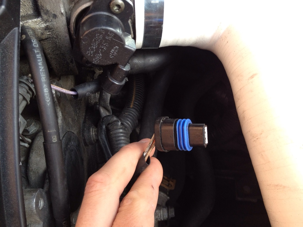

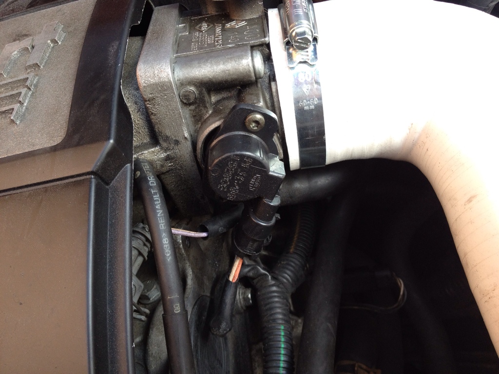

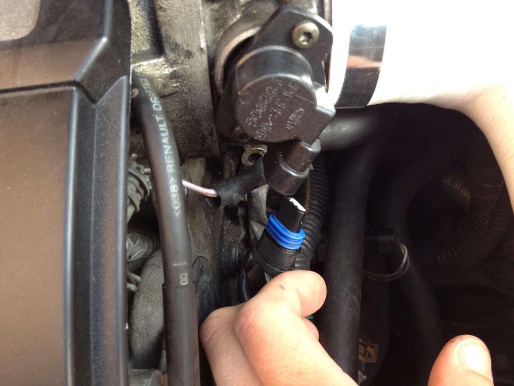

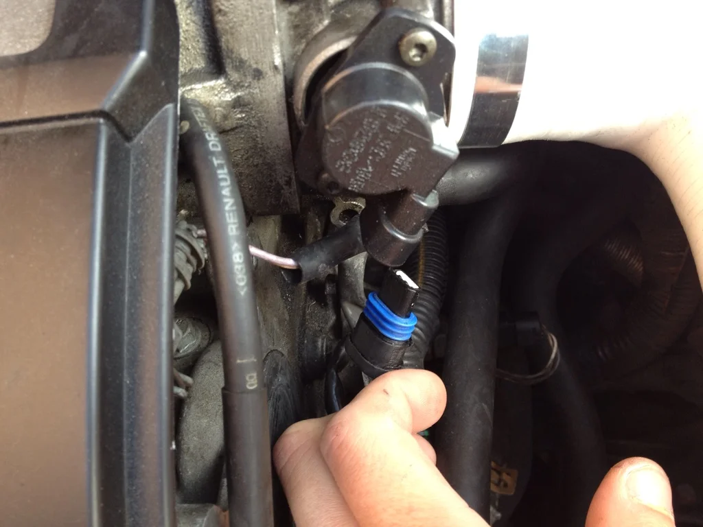

what sensor is this??
  Ph1 T
The clips snapped off the back of this sensor so its coming loose and came out earlier when was checking...
  Lots of Alfas

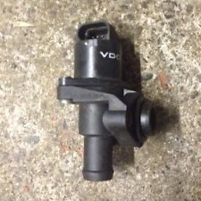

Its not the idle valve, its the throttle position sensor. The idle valve is on the back of the plenum chamber.
  182, SQ7, Trafic
It's your throttle position sensor.
Half of my Ph1's have had the clip broken. It should still stay in though, can you cable tie it in at all by going through the wires and then up over the sensor?
