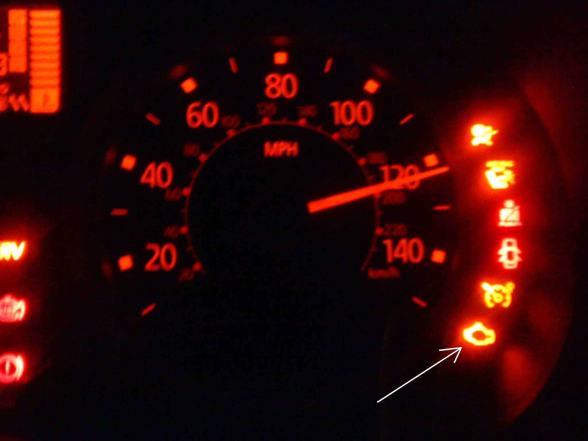

Driving home today and the SERV light came on, and this little light started flashing. Is this the check engine light?
The car felt very rough on idle and under accelleration (limp home?) and now was really lumpy when I just started it, the exhaust is puffing like a diesel and stinks something terrible.
Any ideas? :dapprove:

Its called a MIL light, useualy means there is a problem with the engine.
For example, my vectra used to get this one on all the time because the fuel pump was on the way out.
Deffo needs diagnostics, local mechanic should charge around a tenner... then you can start pricing up the damage ;P

Thanks mate, really helpful. Getting it towed tomorrow to where I bought it, it's still under warrantee so want them to check it first!
I was jetwashing it ealier and the petrol cap blew open, the hose was only on the fuel filler cap for a couple of seconds so it wouldn't have been a lot.

My flashing light is intermittent so I started it with the indicator stalk button pressed down to take the picture, which is why all my dash lights are on.

Car's fixed now, was just the bloody coil. Could have fixed that myself. The AA let me have an aftermarket coil for £25 though so it's not all bad.
