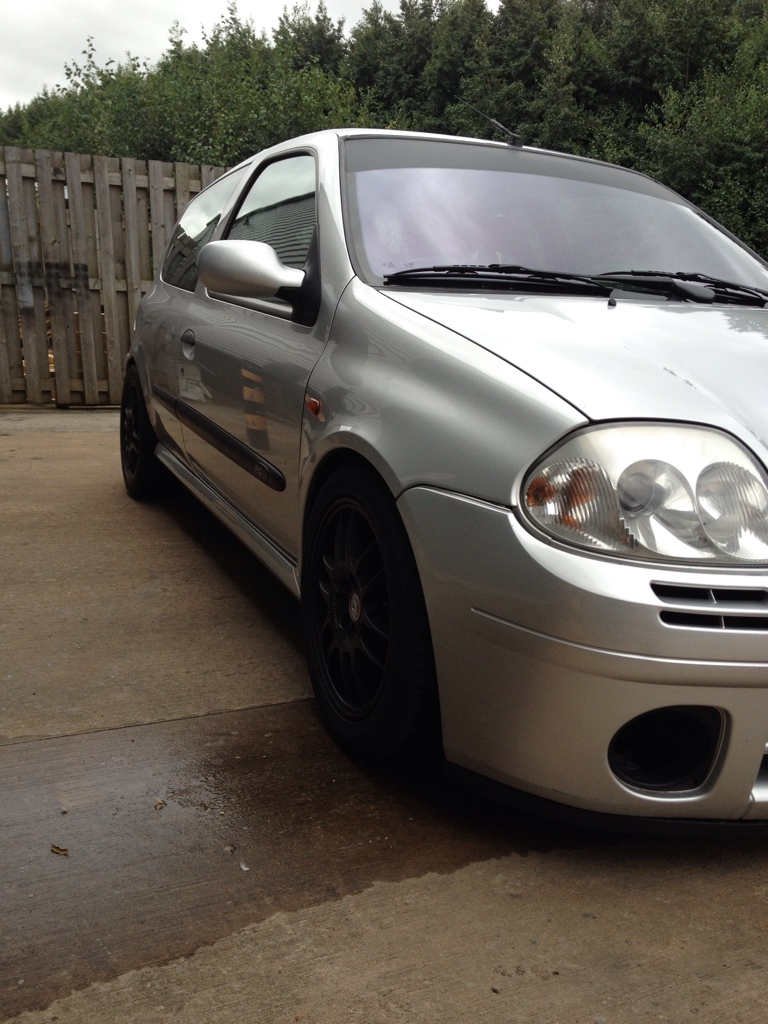

you can go 20mm on the front depending on height with that wheel combo and tyre and 15mm rear mine is quite low and i only get minour rubbing when really pushing the car (only on tight corners and ast coilovers tho)

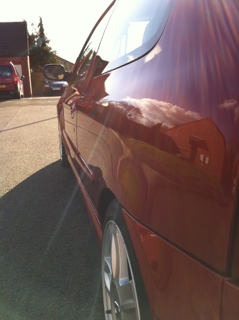

15mm all round on mine (see below), but agree with Dan - FK or Eibach only. Mine are Eibach. I get very minor rubbing on track days when its close to getting out of shape, quite a good indicator ;)

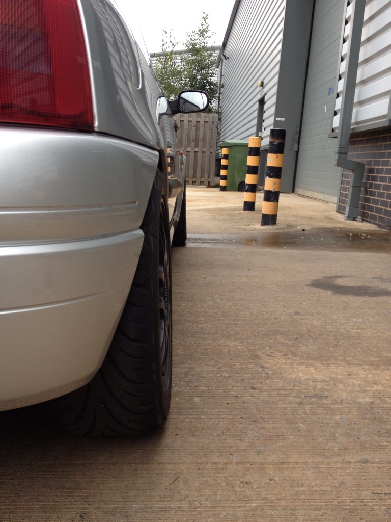

I cant go more than 5mm front or rear or they rub like f**k, had 25's at the front before coilovers so obviously the extra drop that has alot to do with it :( Need to bash my front bumper mount out of the way to help things and I need my rear arches rolled to go any lower, which I won't anyway as its sitting perfect :) Had 15's on the front of my old ph2 with 2 different types of coilovers before without an issue, very strange as it seems to differ from car to car :S
