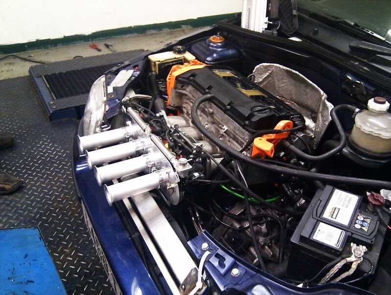

It will all depend on if they are direct to head, taper bodies etc. There are a few different types of trumpets. I have Jenvey 45mm parallel ITB's but I made 48x120mm trumpets fit by opening out the mouth of them to fit, I could have got 45mm mouth but upgraded slightly.

I think I have 45mm. Is there any benefit in opening up the manifold to fit bigger diameter trumpets?
Probably just stick with what I've got already to keep it simple.

More air the bigger you go, suits a higher spec engine but I have built so I have scope to forge etc in the future. Its worth porting everything together as the Jenvey castings are pretty poor tbh. I mistakingly bought the 48mm trumpets to begin with not knowing the differences but it now means I have 48mm taper bodies which is something Jenvey don't sell afaik.
Sorry this is getting very confusing
Clio bodies are 48mm
They are tapered 45mm at the head and 48mm at the trumpet.
I read your post in a rush and though you meant you'd opened up the head end to be 48mm
If you've got 48mm at the trumpet tapering down to 45mm at the manifold/head - then that's a standard Clio 172 kit from Jenvey
They use SF48 bodies
CKRT03 Renault Clio 172 -SF Taper throttle body kit

But everyone doesn't have a Clio specific kit on their car. Mine were 45mm parallel which were then opened out 48mm at the 'mouth' to meet up with the 48mm trumpets I bought.
Best to measure what you have as there's a few combinations kicking about, Jenvey will do all sorts sizes custom for you on there CNC.
The problem is with the emeralds is they have a very narrow opening and are parallel the whole way through
You lose a fair bit of torque without that taper
The 120mm trumpets taper from what I think is around 60mm down to 48mm then the bodies themselves taper from 48mm to 45mm - so you get a nice tapered inlet all the way to the head. Great for torque delivery.

Yep chrispy's setup was identical to mine - individual SF48's on a jenvey clio manifold
So the ones I linked you to will fit.

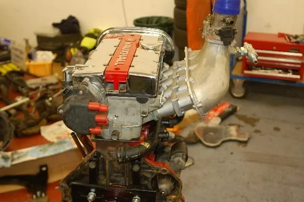

Why don't you get spacers from jenvey rather than get trumpets? Cheaper and don't need a larger filter.
  182/RS2/ Turbo/Mk1
How do these work then? Off to look for pics now
Like this mate:
(the bits between the manifold and the plenum, look kind of like bodies but without the spindle)
On an ITB setup you can use them to add length either between the body and the manifold or between the body and the trumpet
