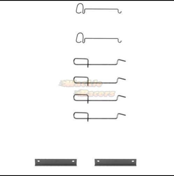

  PH2 Flamer
That's what most people miss out.
I'm not sure, but you can buy this complete kit from most places. Got mine from Allparts.
  PH2 Flamer
£30?
Think I payed about £6 mate. All I needed were the two retainers your after too. But used it all anyway.
  PH2 Flamer
£7.50 ish from euro car parts. But it's showing the older design in the picture. Should be the newer revised design though

​Im going to buy a rear bad fitting kit and fit it this weekend to see if this helps any
  182 Trophy
I've never seen the top two clips before, either.
Mine have shims and spring clips and they've yet to fall out in 2.5 years/25k miles.

What are the washers and things for listed in the Renault Kit ?
  Cup In bits
That kit is like £35 from Adam, I bought it thinking it was just the needed parts for securing the pads, I very much doubt you will need most of it (pointless)
