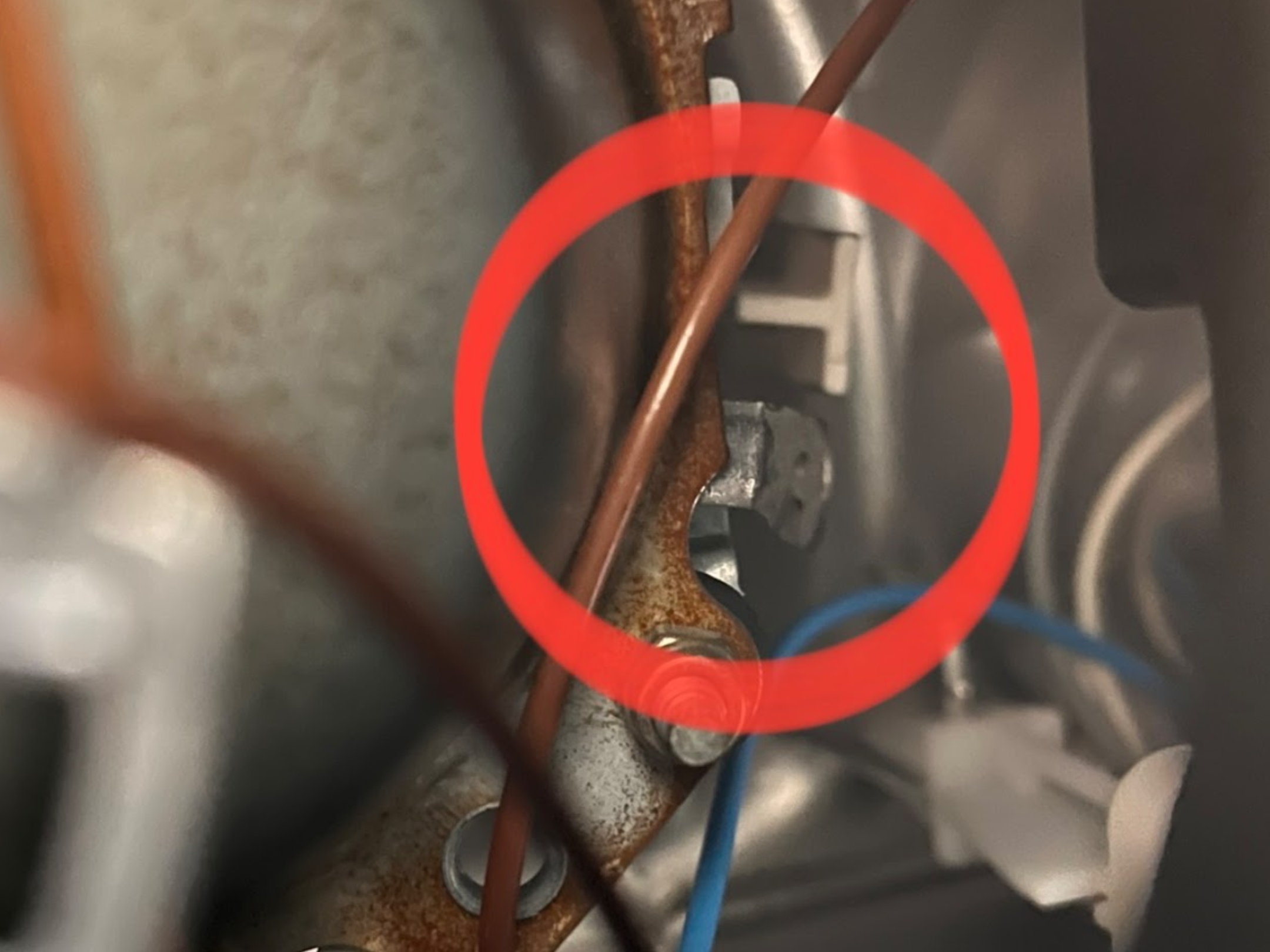

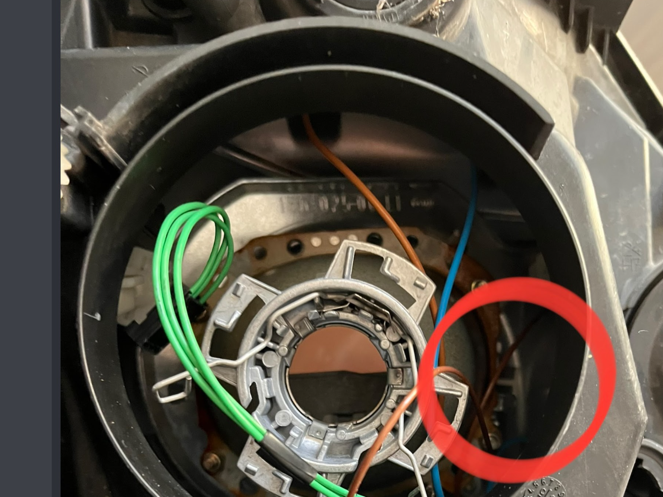

Don’t worry about the beam aim there is a little switch inside that changes it to rhd

I thought I read somewhere that was the case but I also seen people question it so wasn't 100%
I swopped my pair on the RB while in Spain and she passed that part of the ITV.
Had to switch back now she is home. It does work as I checked beam aim before and after on a wall.
ajracer
Move the small lever in the pictures.
