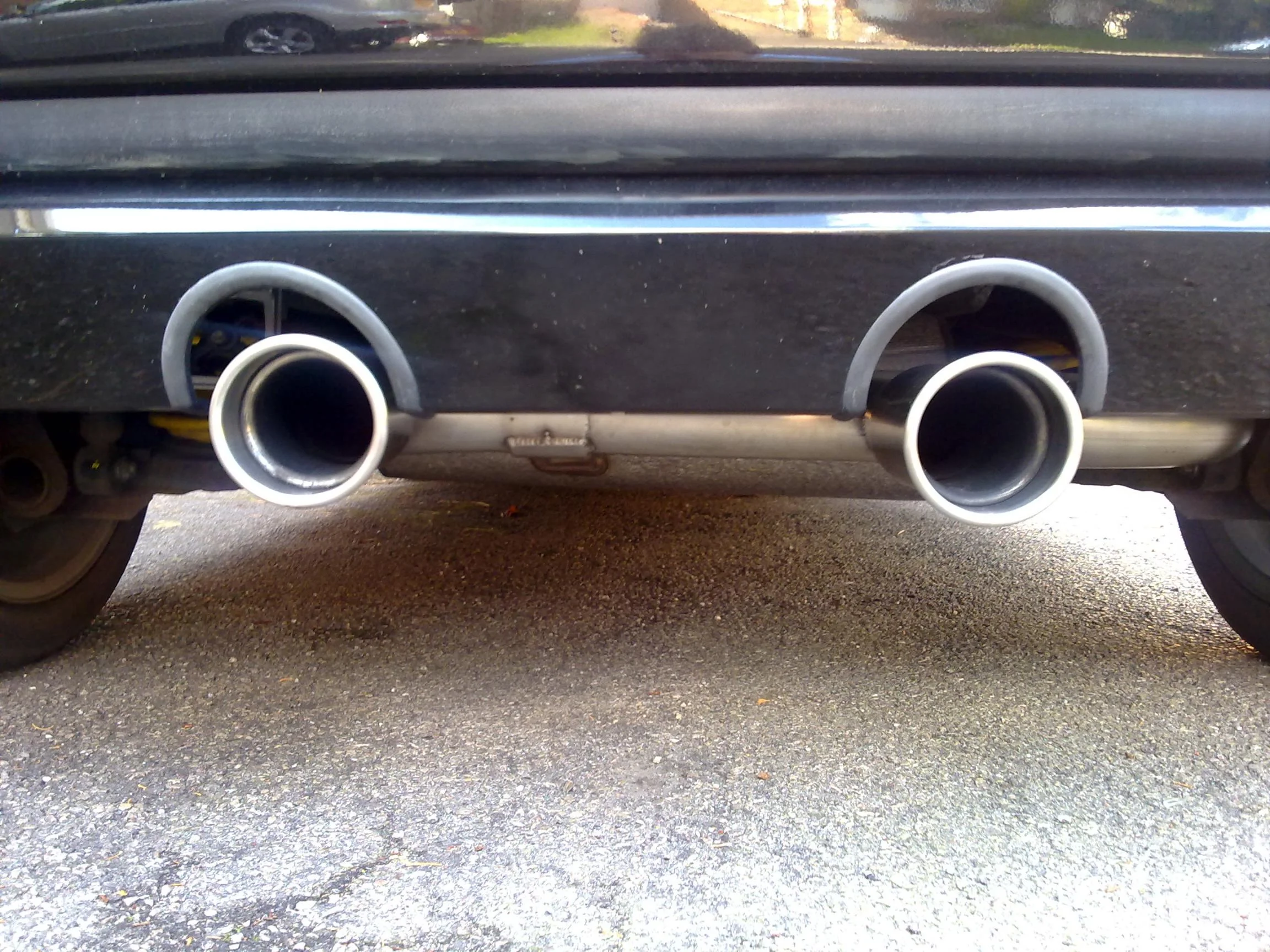

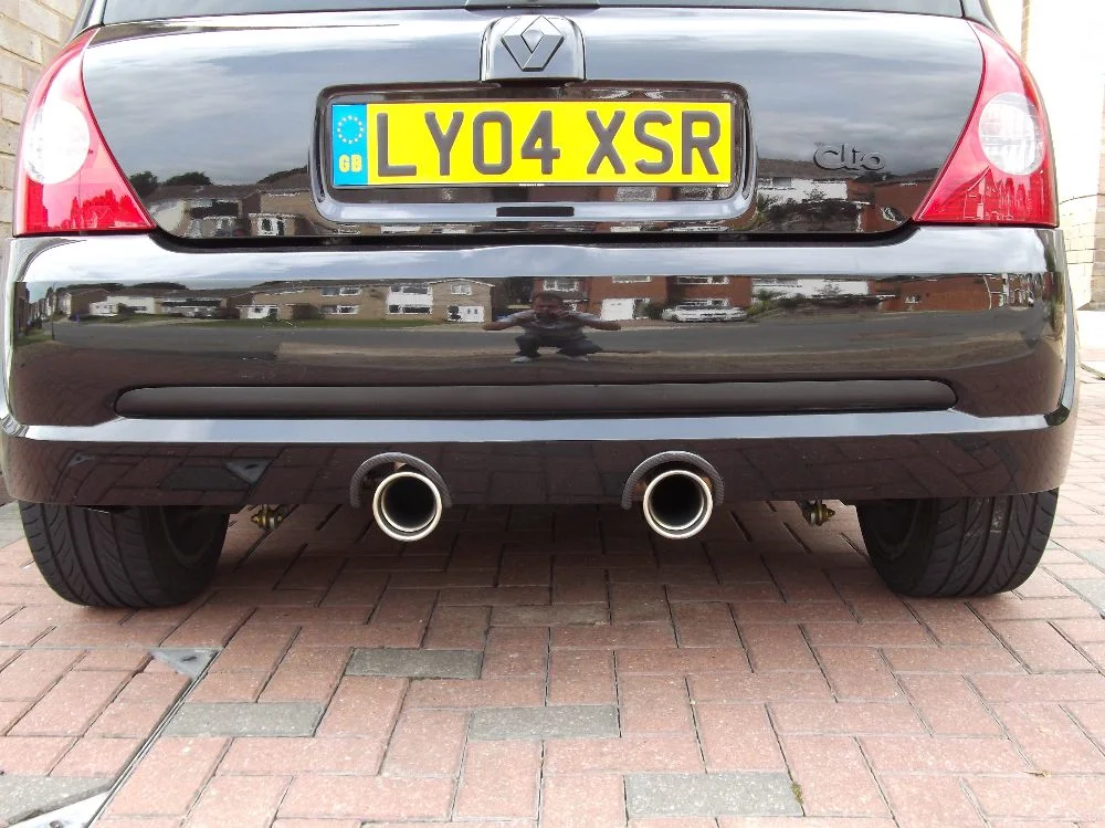

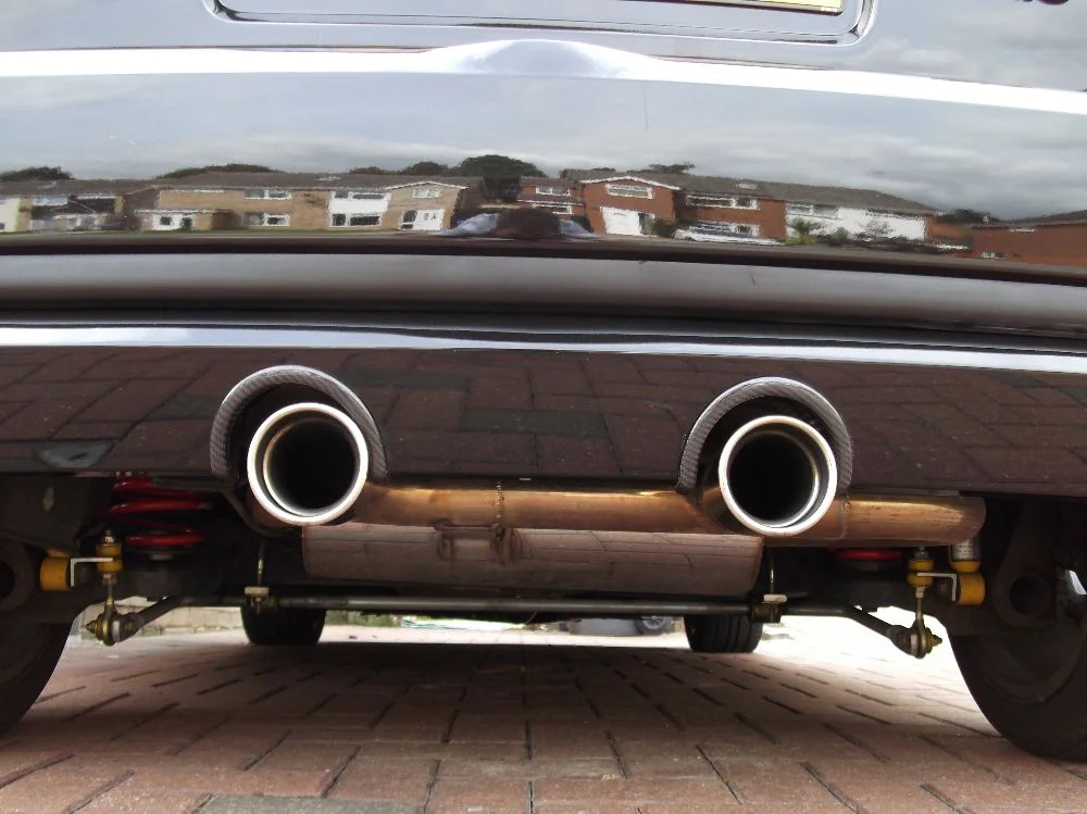

Looks like dodgy mounts, even with my shagged mounts it fitted absolutely spot on when Fred fitted mine
how is it that far off? has the car been in a bump?
My Yozza was sitting low like your's one thing you can do is remove the washers that the mounts sits on,should get it up higher for you,the left had side on yozza's always sits a bit funny over to the right a bit and is even worse when you have been giving it the beans.I have fitted prima racing mounts on mine with washers removed can post up a pic if you like.
Take a pic from underneath so we can see the mounts ect,might help to see what is wrong,have a look at the centre mount if is fooked then change it Renault have made a better quality one now as well,I wouldn't think it would make that much difference though.Have you tried removing the washers?
