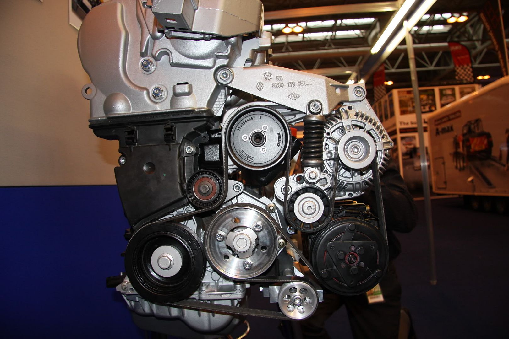

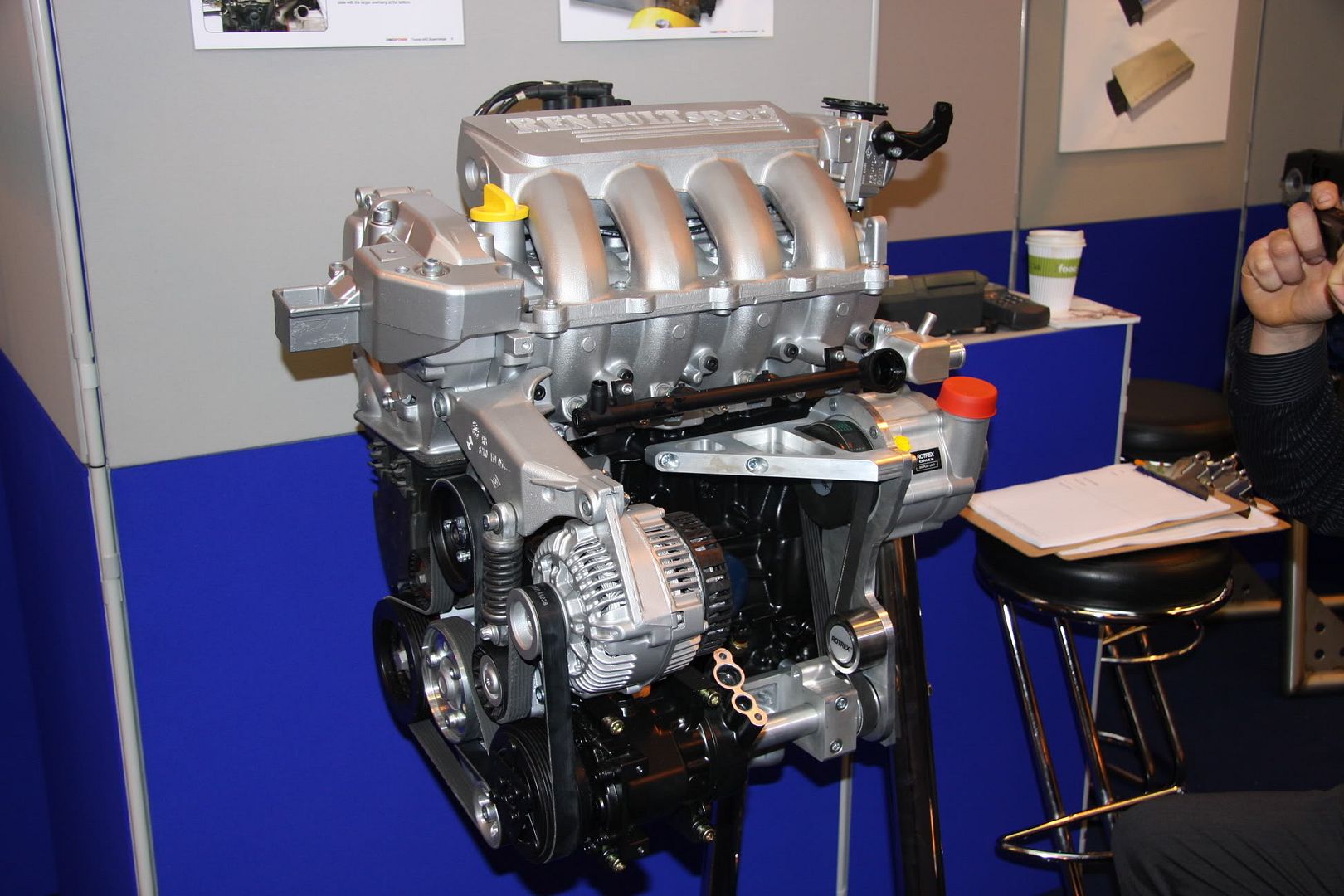

Over Xmas Our engineer Darren decided to create a little monster... (bit of CAD design and alot of machining)
With the aim of keeping the air conditioning for the 182 and having a SUPERCHARGER....
AT THIS STAGE NO TESTING OR POWER FIGURES OR COSTS ARE AVAILABLE.
We are going to run it for a few months and properly track and road test it before it gets released..

IS that a brand new motor! Looks spanking!

no its just a dummy show engine, all been painted up :) tends not to look to good having a rusty engine block on the stand. :S

Thats an impressive bit of engineering work there.
Am I right in thinking that you have basically detached the alternator, A/C compressor and water pump and connected them to your bracket (though bracket seems to small a word to describe that huge mass of alloy) to extend it all out to get the Supercharger shaft drive into there?
the super charger pulley is where the aux belt idler would have been, everything else is in almost stock position, but on a machined aluminium bracket
