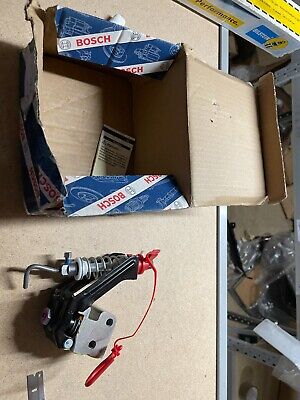

I have ordered the compensator - Bosch from ECP - £50, cheap enough to replace and rule it out.

You jammy b*****d!! 🤯🤯🤯 I desperately wanted to call bullshit on finding the compensator for £50 so went on ecp & there it is at £49.49 😲
Tried to buy 1 just because I previously paid £160 for the same one & it's out of stock 😭

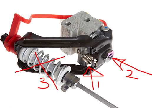

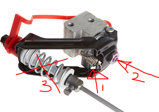

The spring & lever is supposed to be disconnected on a Cup, the braking effort to the rear is fixed which is the reason for the MOT bulletin thingy.
You can adjust the braking effort by undoing the big lock nut on the bottom of the compensator then wind the threaded bit in or out with a 5 or 6mm allen key but I doubt that will solve the unevenness side to side

The lever is disconnected, the spring I refer to is only 15mm long, (#1) at the base of the lever that makes it return to vertical, ie minimum rear bias, the larger spring (#3) that is shown on the ECP part is not there as you would expect.
I wanted to work the valve in case it was sticking, bit of crud etc.
All this might be a red herring given my latest theory that the issue is the front brakes, not the rear!
The nut and allen key, is that #2? Which way do you turn to reduce rear effort?
Aaahh gotcha! Yeah number 2 is what adjusts it, as for which way? I couldn't tell you as I haven't tried it yet. I was about to have a go at it trial & error style but ran into a problem of losing compression on cylinder 3 so been concentrating on fixing that & not bothered playing with the brakes

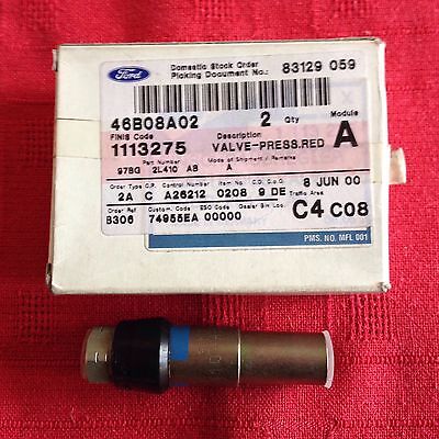

When I did the ABS delete on my 172 I used a Cup/Kangoo master cylinder and a pair of Ford Mondeo pressure reducing valves for the rear. Did away with the compensator completely and had much better rear braking.
I would think winding out (lengthening it) the central allen key bolt will increase rear bias, and visa versa as pulling the lever down has the same effect, which I understand to increase rear bias.

That's why I changed to different valves for a slightly increased rear bias. Made a world of difference to braking and stability.

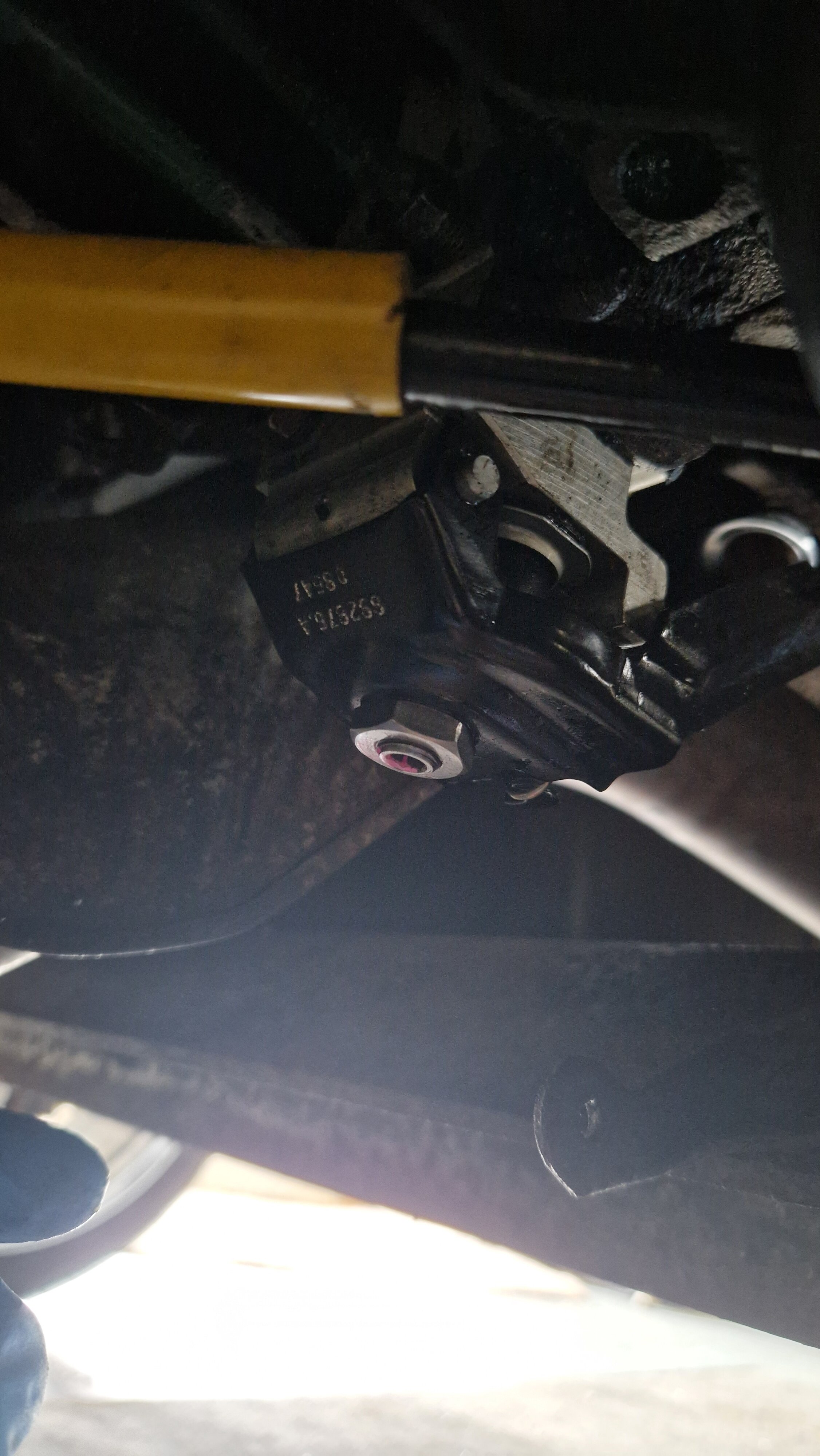

Slight bump on this for anyone following.
My Compensator or bias valve is leaking from the nut at the bottom. Is that common? Will tightening it stop it or is it likely failed internally.
Anyone have a link to a new valve?

bowen86
Cheers @16v_paddy bought that part you linked to. Fitted it but I'm not sure if it's leaking from the same place.
Replacing the compensator leaked alot of fluid and I've had to bleed the brakes a number of times.
Does the compensator need bleeding? Does the nut at the bottom do anything of do I leave it?

Yes you need to bleed the rear calipers for the compensator
The nut on the bottom is a lock nut for the threaded bit in the middle, that adjusts the bias - I left it as is on mine & haven't had chance to play around with it yet.

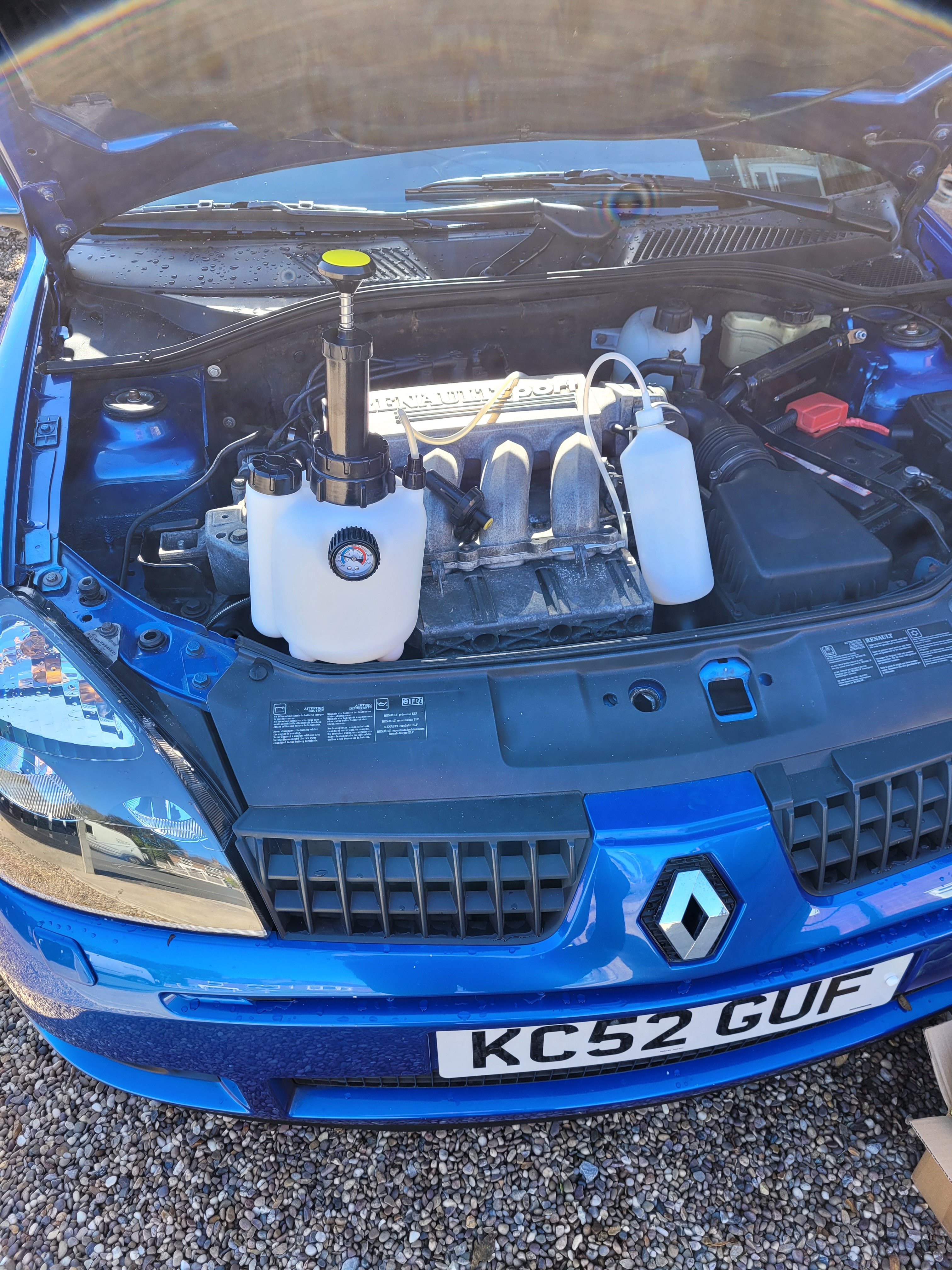

I also had to bleed it with this kind of pressure bleeder as pulling a vacuum or pressing the pedal didn't quite do it properly
