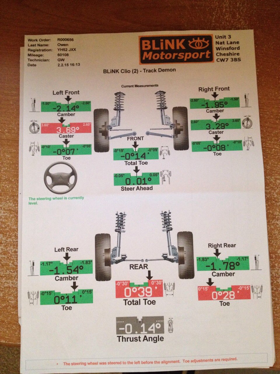

  Track 172 Cup
This was my setup from Blink using their Track Demon setting, They are very helpful and I will be going back soon to have some more work done. I did have to get a shim for the rear where you can see it's out.
