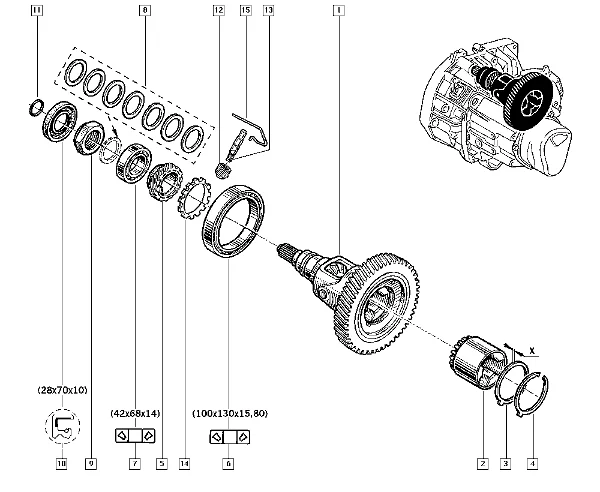

Late 172's and 182's have the plate. We hear of it quite a bit. Once its popped the clip once it will keep coming out. All our rebuilt ones will soon have a plate but the engineering chap never gets round to machining them for me.

Wheel spinnage and jumping off kerbs will pop a shaft - easy fix ( buy new dont fit used ones ) they cost a couple of quid.
3 - 7700720854 ( 1.8mm width ) £4.98 + vat or 8200790496 ( 2.8mm width ) £9.80 + vat
4 - 8200295074 £1.87 + vat
