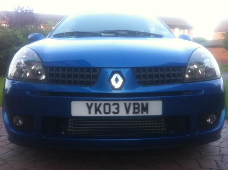

Anyway that was that until i seen a Ktec turbo kit for sale at a decent price (gt28, manifold and downpipe) this was purchaced along with a set of r26r injectors, a gen90 ecu and intercooler kit, With Lots of help from Andy (andyrg, by lots of help i mean he done the entire thing;)) the results are fantastic!

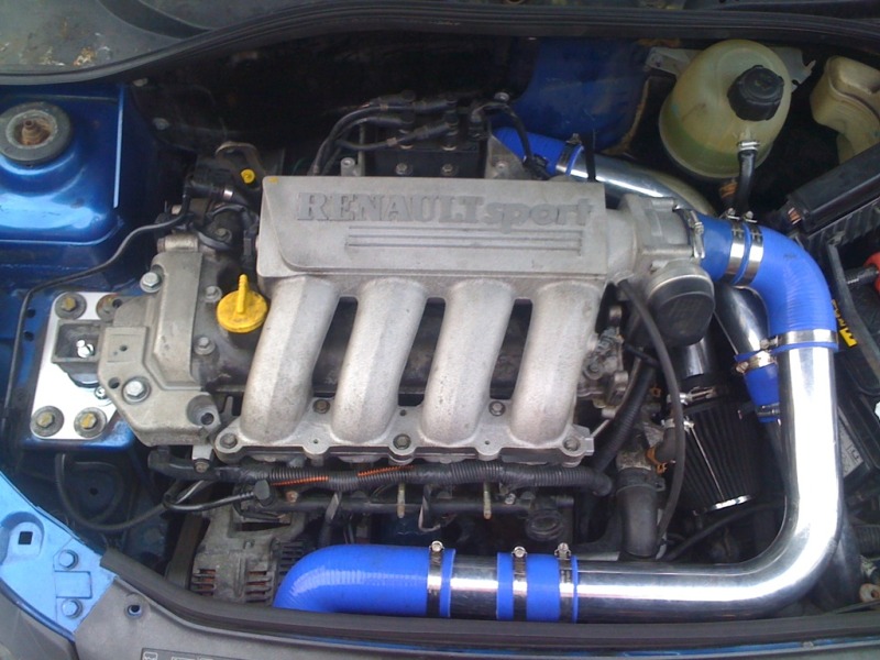

Engine bay needs a few little bit's, the battery will be getting moved to the rear so the ecu can lay flat and they'll be plenty of room for the air filter to sit in the current battery location
also running solid engine mounts which are no where near as harsh as people make out,

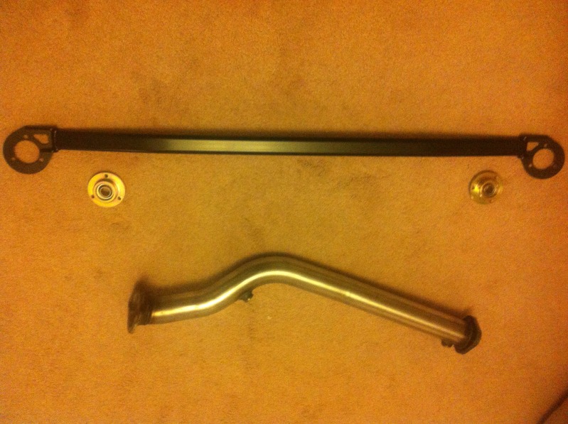

mapping tomorow so a new decat was in order, the brace and topmounts will be installed in the next few weeks along with all the new suspension goodies;)
