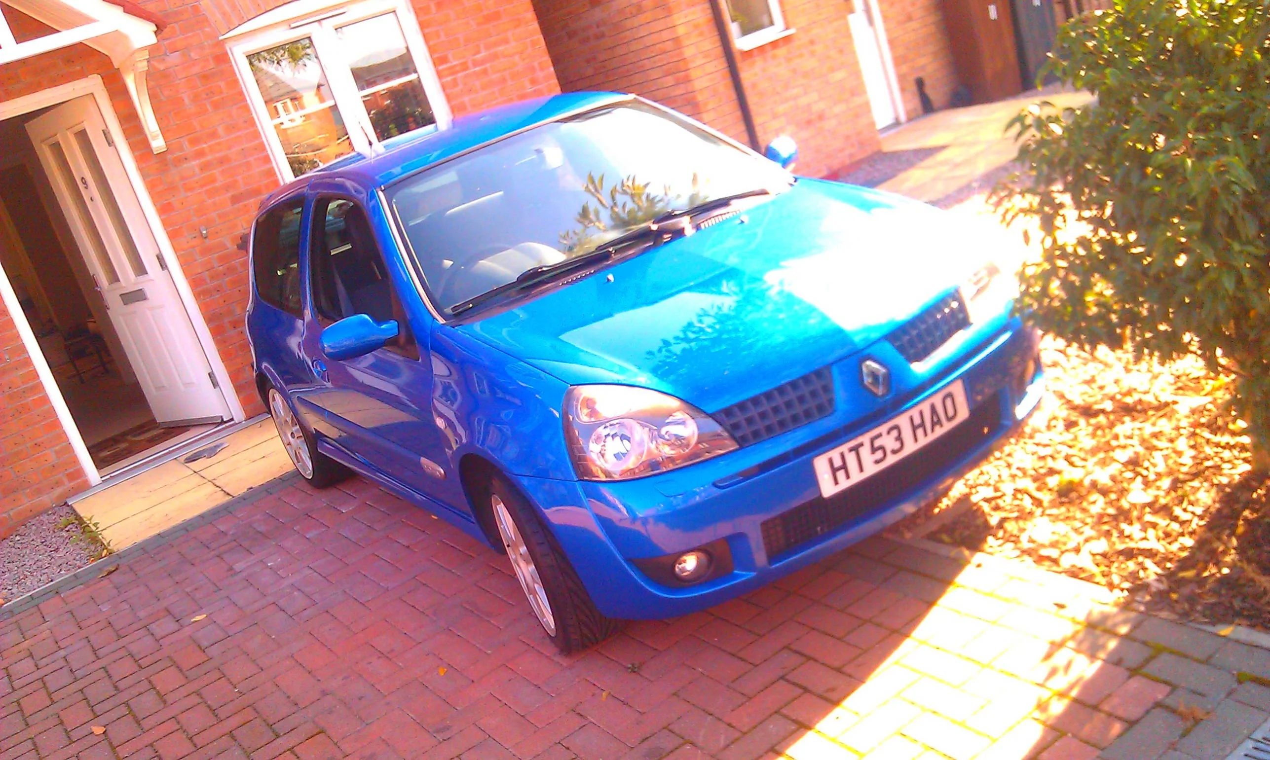

Thought I would get a project thread started as my car is now running lovely after a cam belt service and a few problems that come up.
Owned the car a few months now and so far i've had the cambelt changed and a pipercross panel filted. Aswell as a large puddle of oil meaning the rocker cover needed re-sealing and new spark plugs (thanks to Danny @ 519 automotive)
So far I have done the following mods...

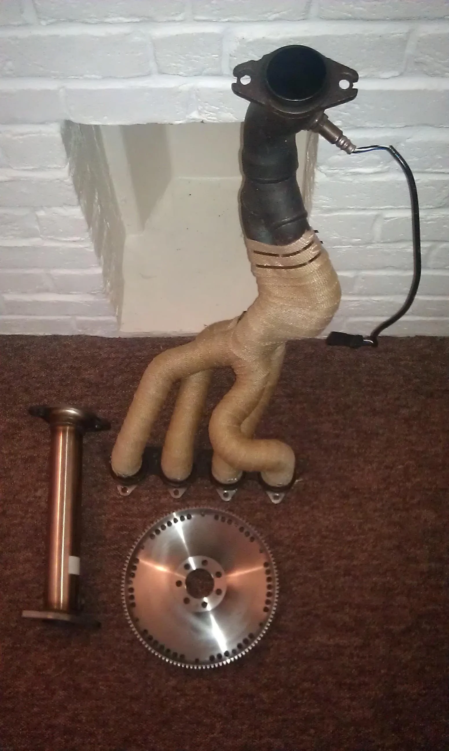

New lightened flywheel with new valeo clutch.

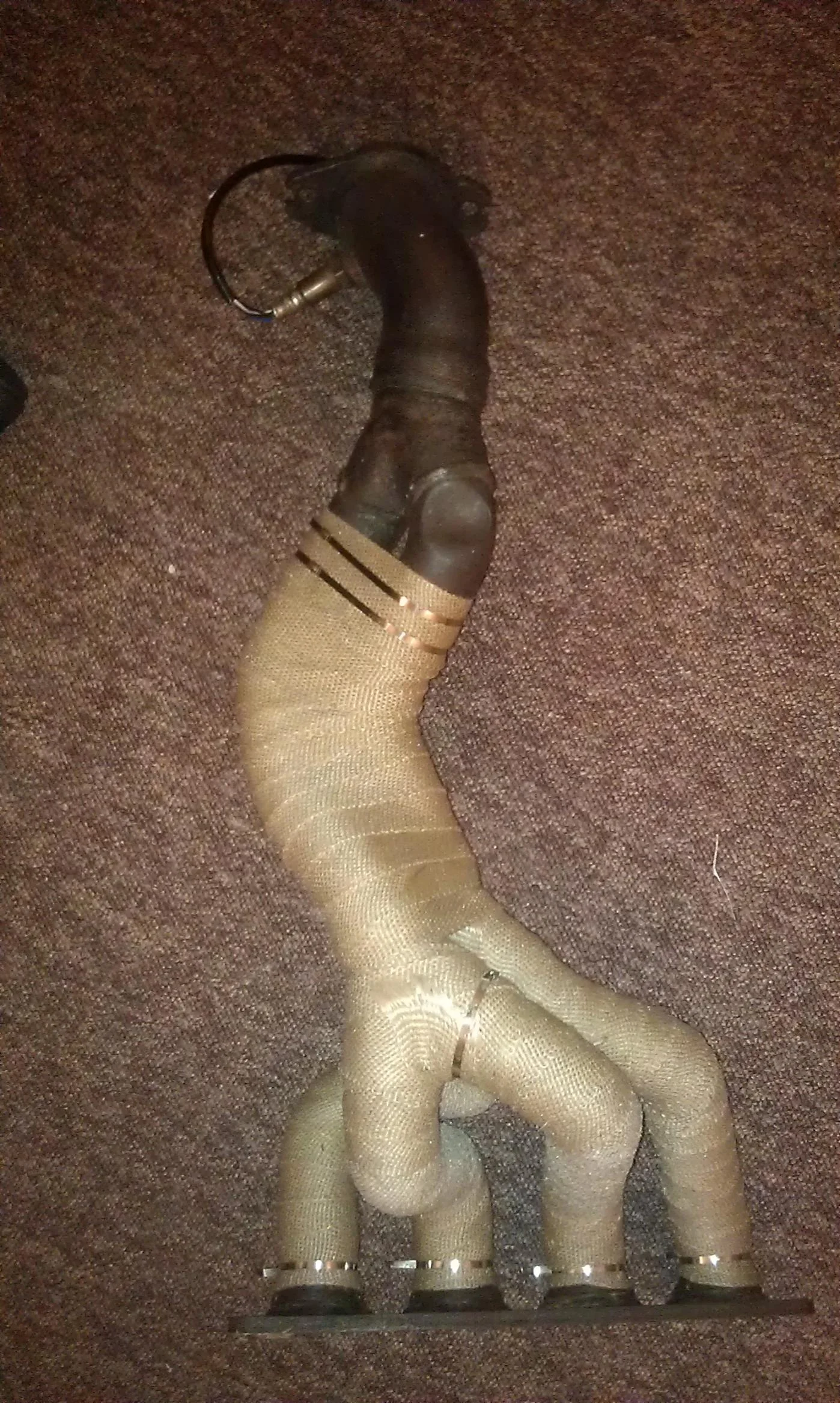

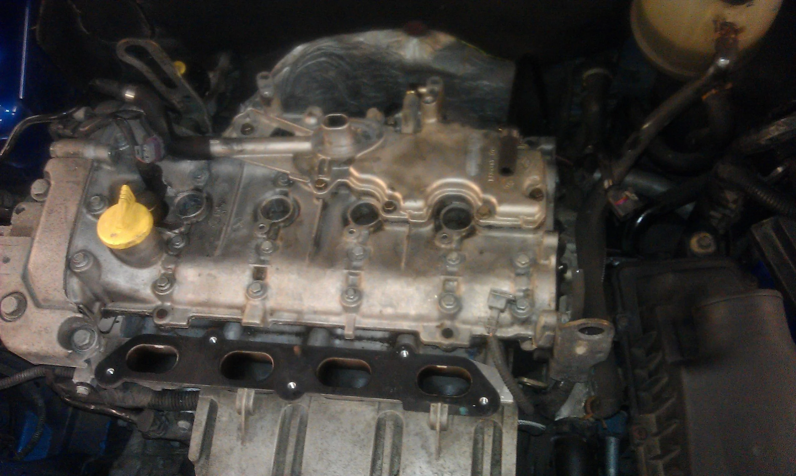

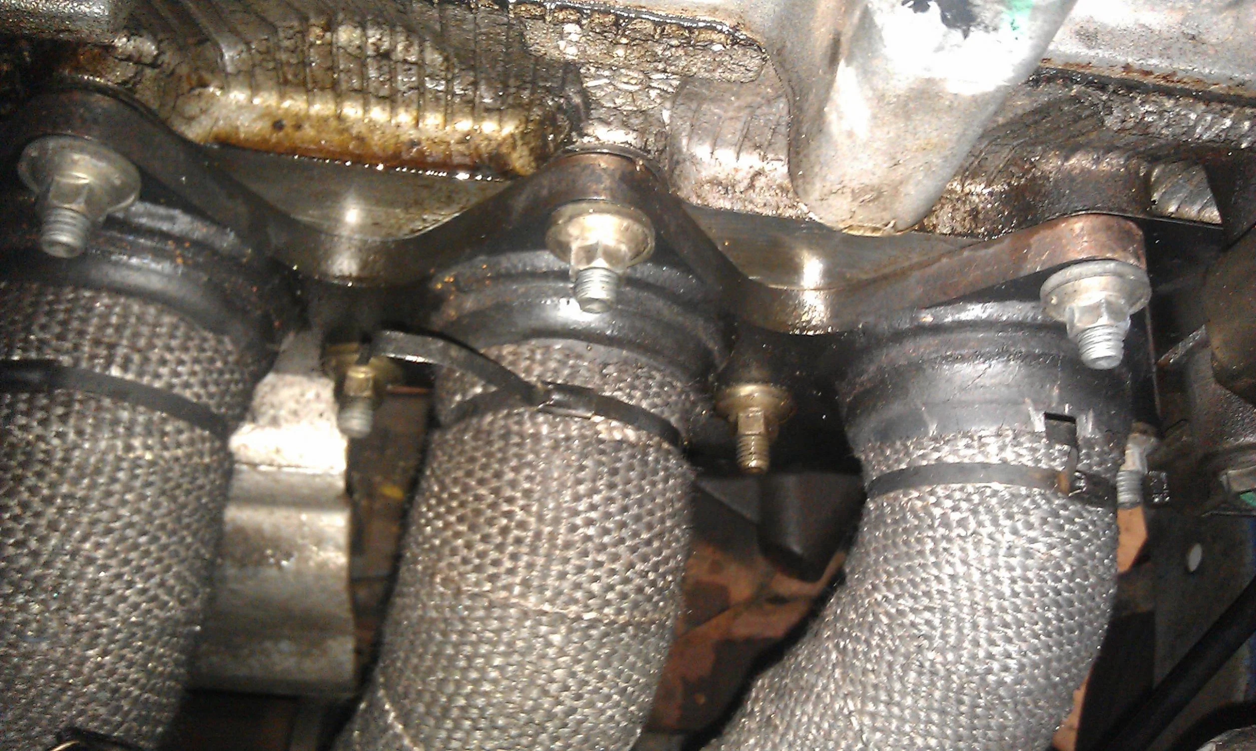

182 manifold (heat wrapped & silcone coated) with k-tec decat/conversion pipe.
Clear side repeaters.
This was my first attempt at heat wrapping. Didnt wrap all the way to the flange as I wasnt sure how much clearence would be needed for the ARB. The pic is before I used silicone heat paint.
These are all fitted now along with a gearbox oil change. Car feels great now :) I will take some pics of the car once its been polished!

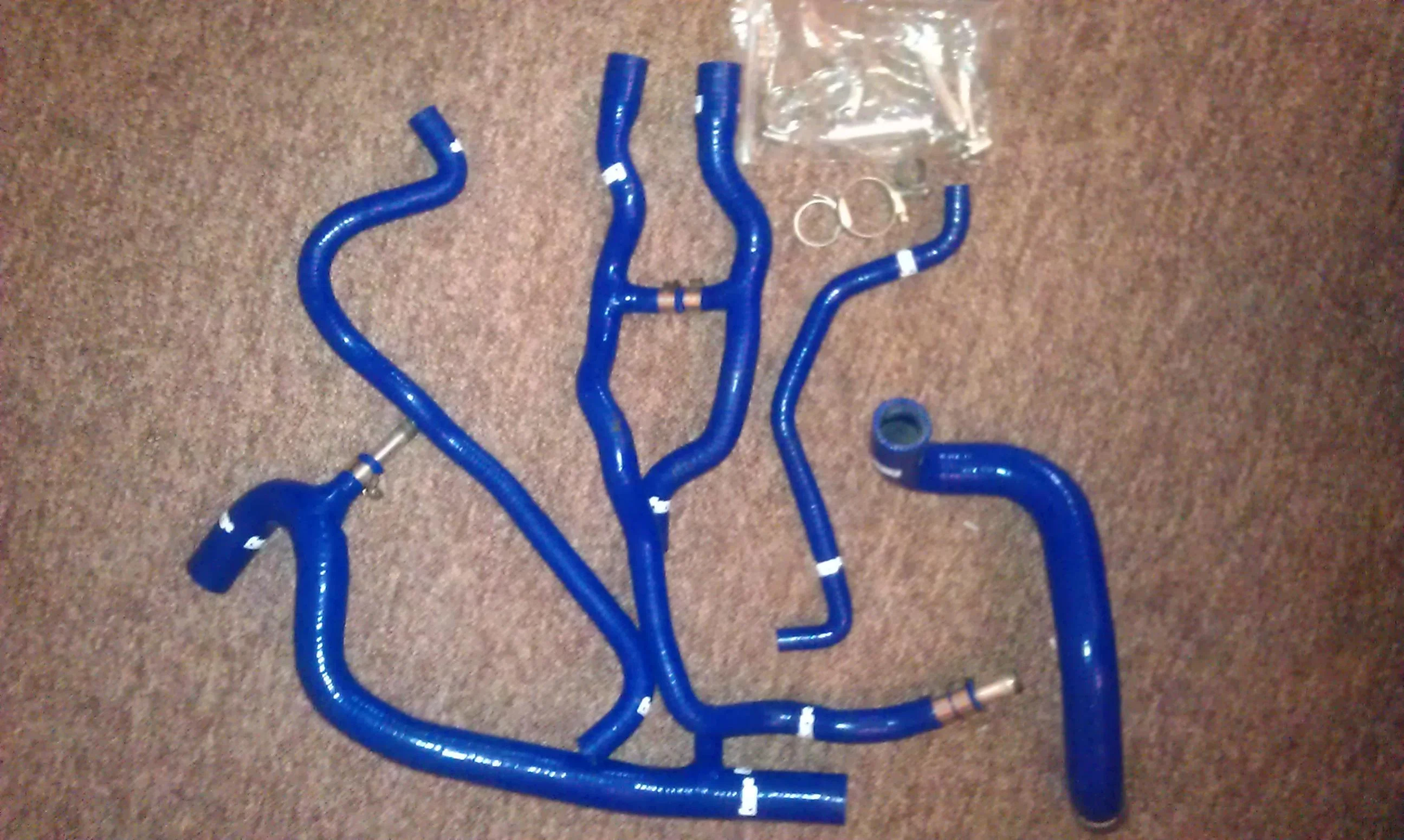

Managed to get a set of Silicone hoses off a CS member, so these will be fitted next along with track ends, lower ball joints, engine & gearbox mounts :).

Just a quick update.
Skoda splitter now fitted.
New track rod ends and ball joints fitted.
New offside CV boot fitted due to lots of oil on the inside of my wheel!
Did have photos but my phone packed up the other days and had to be wiped by HTC. So I took some this morning with the splitter fitted. Poor quality though!

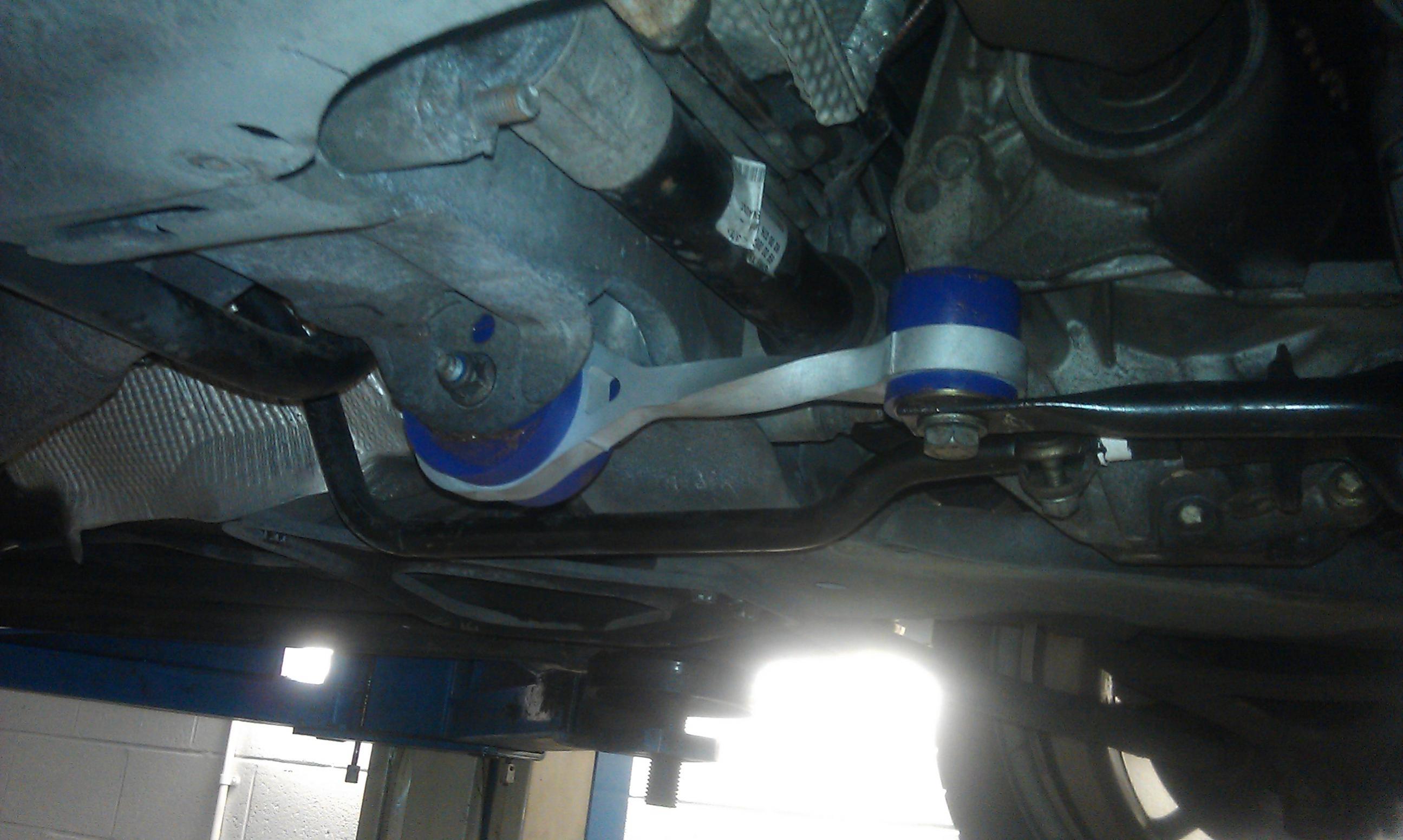

Gear changes were a bit slack, also noticed slight damage to the heat wrapping on my manifold due to engine movement. So fitted a poly torque restrictor. Wow what a difference. Instant power now. Gear changes are alot more solid.
Not much, but what a difference to the drive!

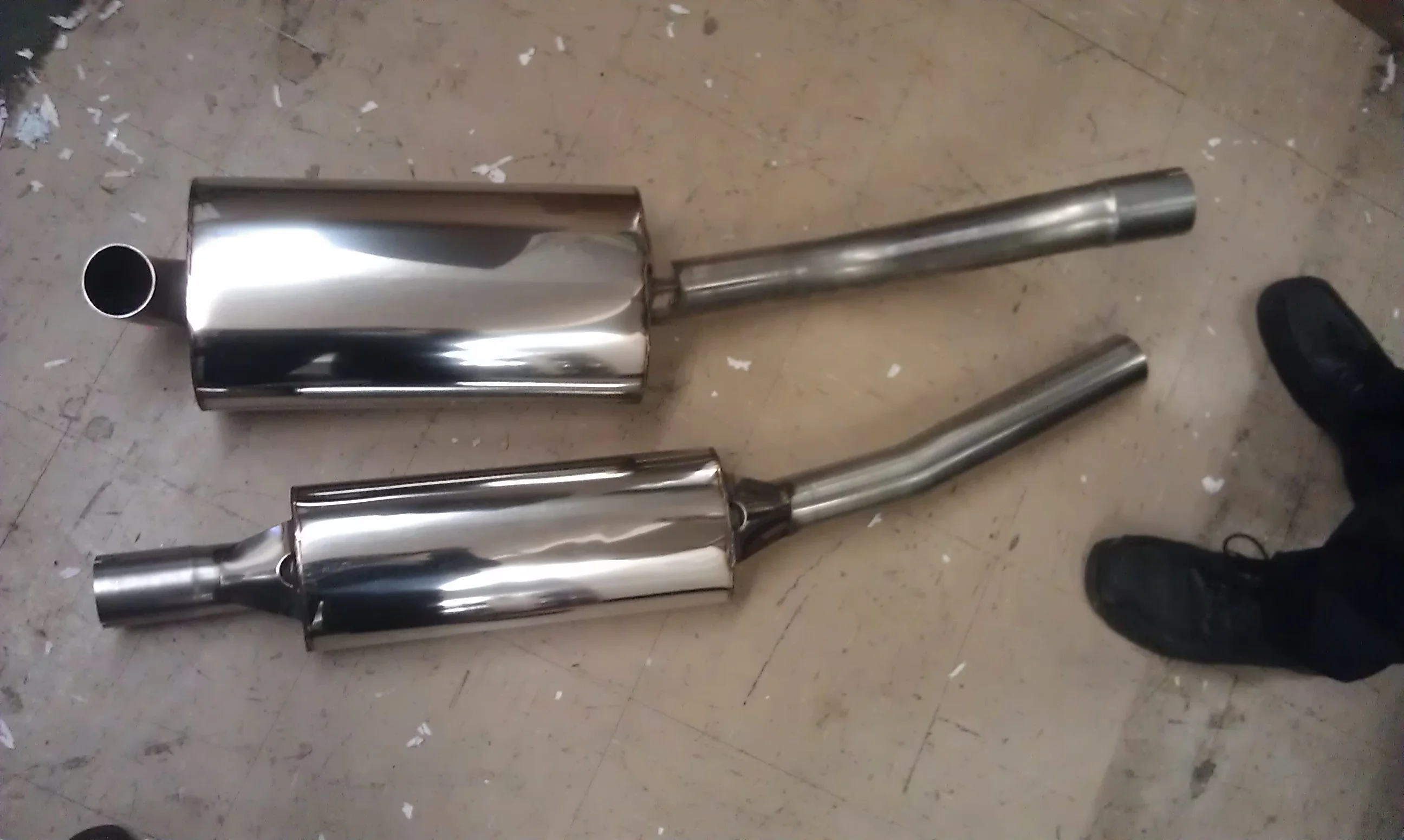

Just ordered a new stainless stealth exhaust and some yellow HT leads. Also getting a new windscreen fitted tomorrow,

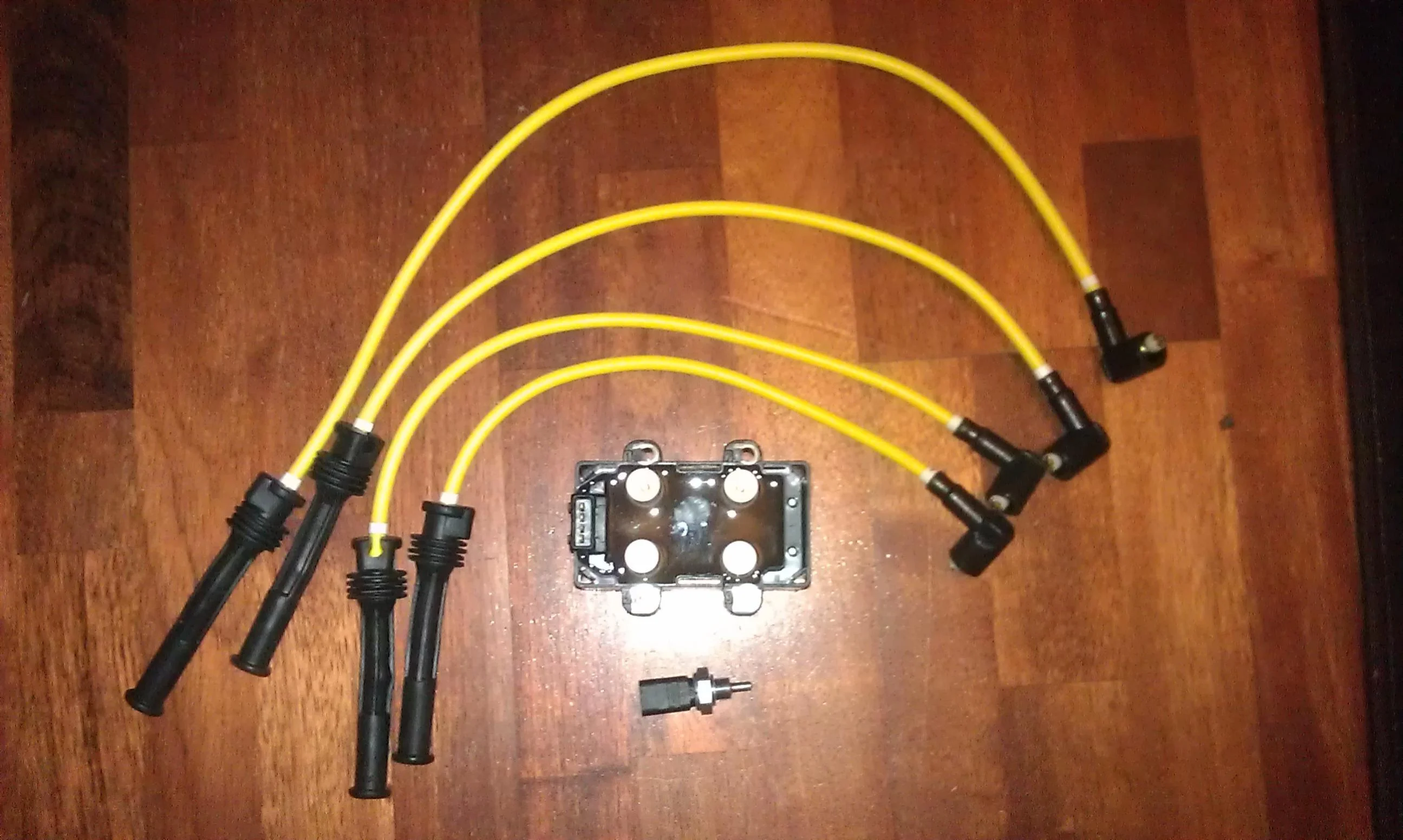

looks like my coilpack has failed yesterday, its running like crap and misfiring. Allso my temp gauge has stopped working. Considering I changed the temp sensor 1 month ago with a repro part, im guessing thats failed. Its my fault for trying to save money! lol. So just ordered a new temp sensor and coilpack from Tom@Wests along with some custom made HT leads. I have noticed some burning on number 4 plug so hopefully its not injector related.
  172 cup
Look what arrived for me today. Thanks to Tom@wests and Ktec for great service as usual :).

They are from Performanceleads.co.uk. Seem good guys to deal with and knew there stuff when i spoke to them. They also entrtain sad peeople like me describing the yellow I wanted :)
  172 cup
theyre just a little more expensive than tom@wests could do OEM for. But I was keen on yellow haha! TBH performanceleads charge £7 or £8 for postage which seemed steep. But they are 8mm leads, and alot cheaper then magnecore!

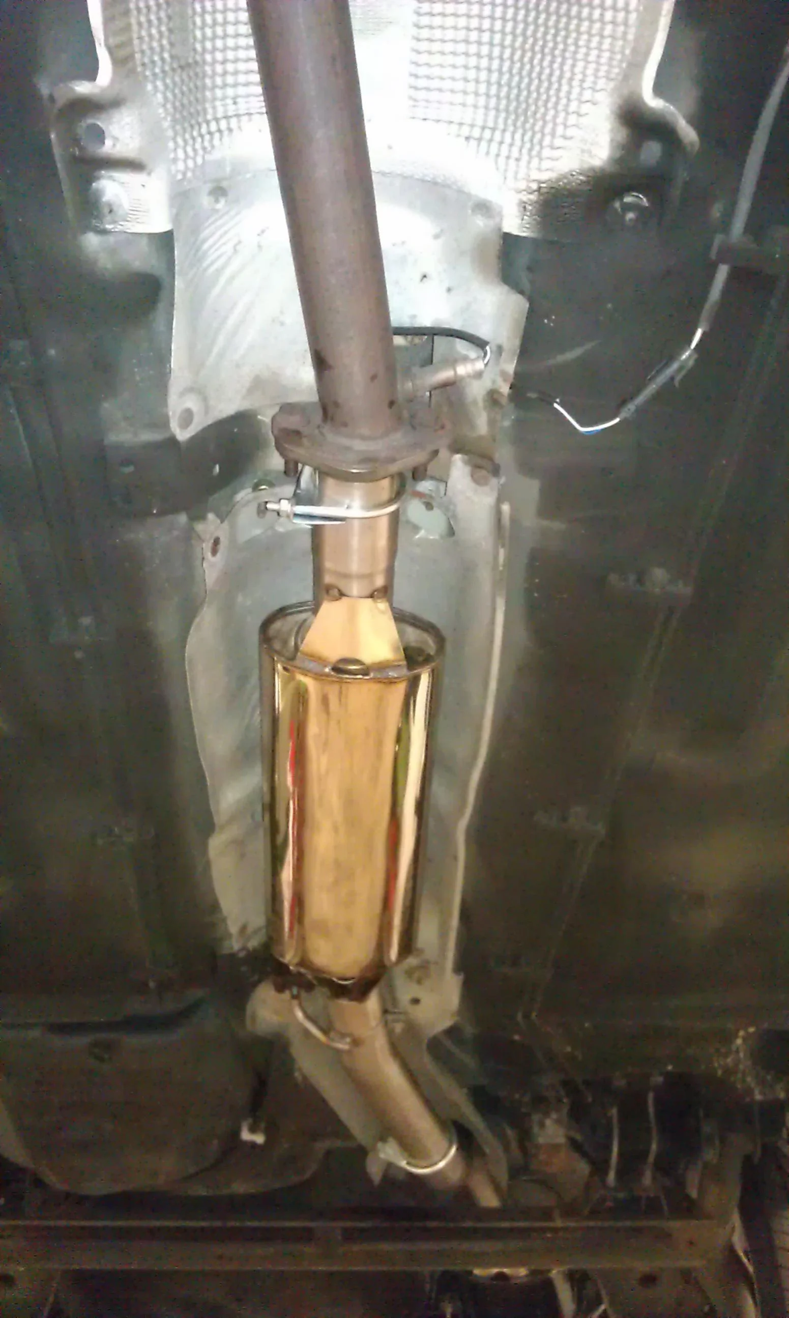

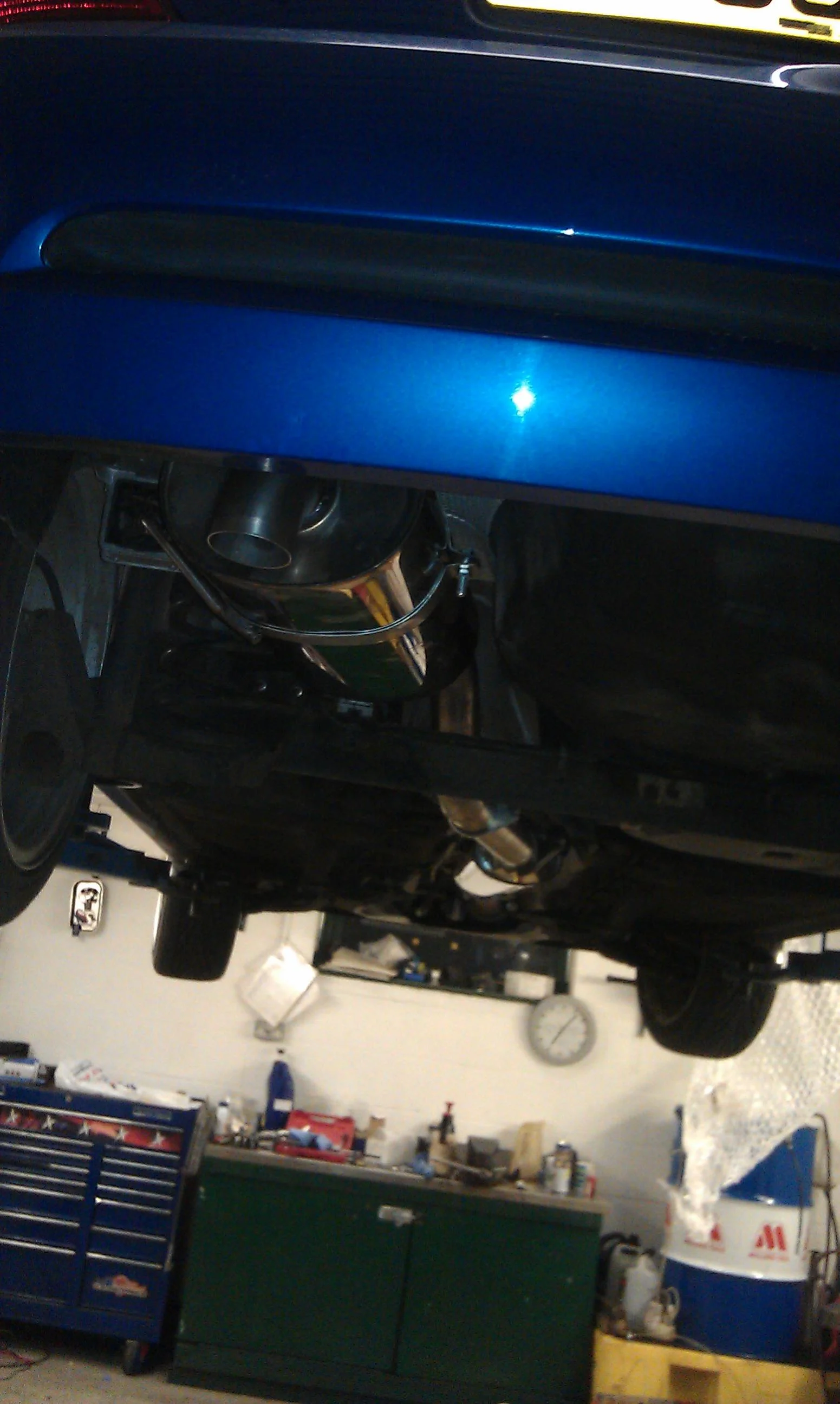

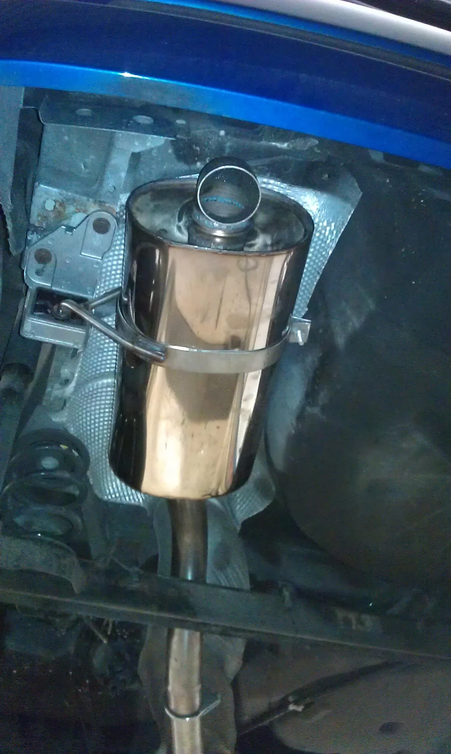

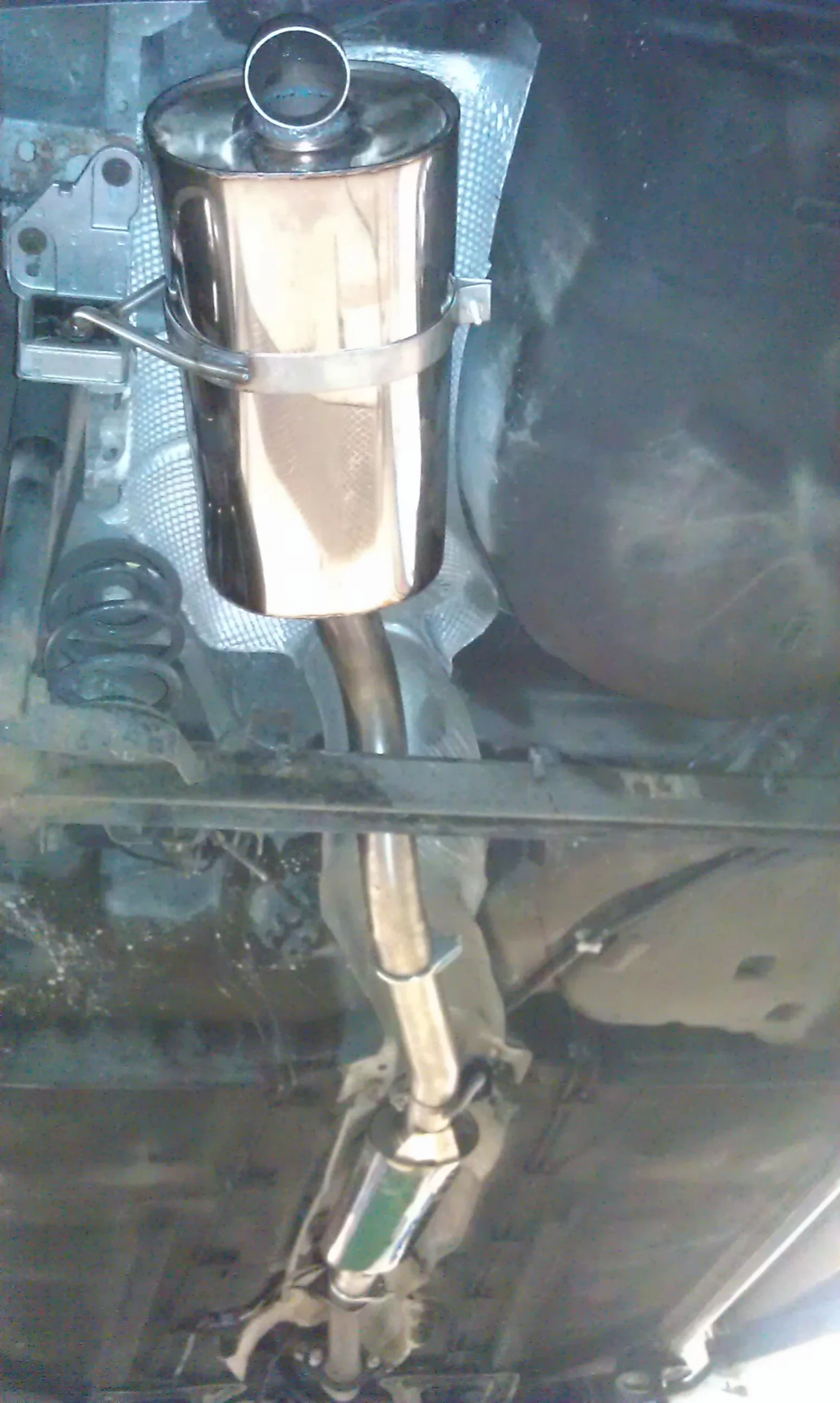

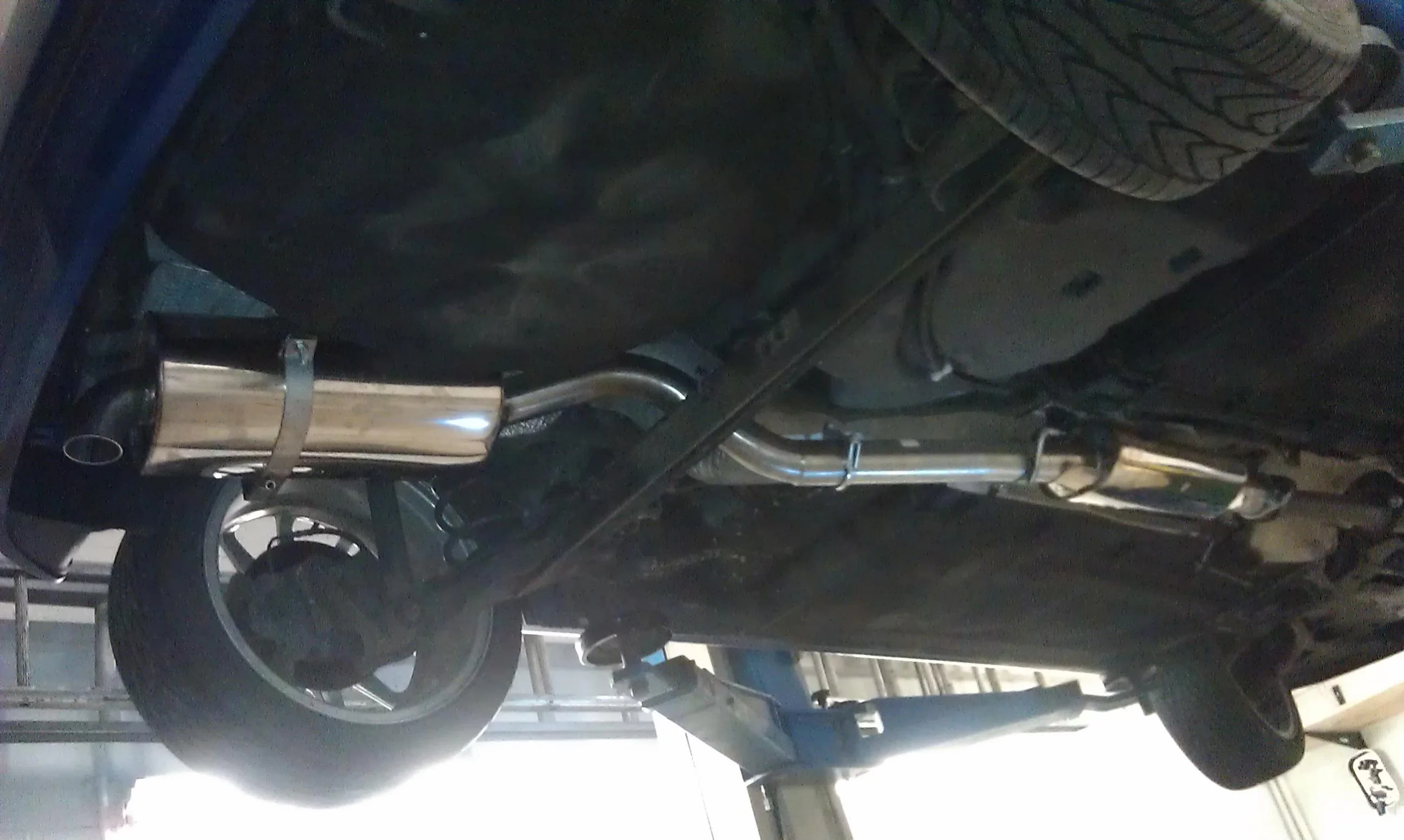

So... after an hour or so, exhaust is fitted along with 2 new mounts :).
also, when changing the HT leads and coil pack. I remembered I was getting a slight burning smell (like oil on the manifold) so had a quick peek with a mirror. Found a bolt weeping a little on the upper cam cover. So whipped that off and re-seated it.
  Trafic 140dci
Looks good mate :) having never seen one before, it looks exactly the same as there mild steel stealth exhaust i have in my garage, but stainless steel.
Cheers mates. I like the mirror finish :). Dont have to put up with the holey exhaust sound now either! Oh and my caliper has freed off now haha! strange!
Looks the same as mine, with out being rewelded and rusting! ha.
