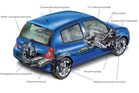

Difference on the 182 is that it has the twin exhuasts and also a lot better and less restrictive manifold. Changing this they would of had to change the calibrations on the ECU.

RenaultSport made lots of little changes:
