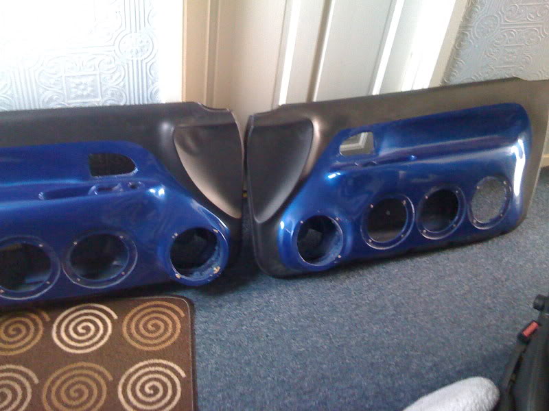

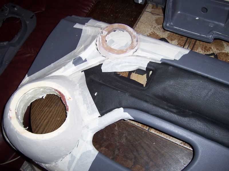

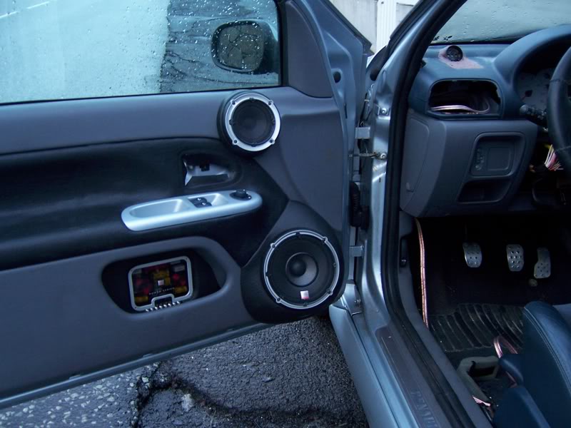

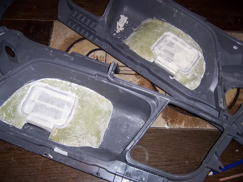

I’ve had my door trims totally dismantled and made molds for mounting the 3way component speakers, fairly easy task, but very time consuming. Bass and midrange in the door and tweeters in dash.
As this picture shows, I’m still working on it. But the door trim is back on and cables are run into the cabin, some bits are out for painting and the top half dashboard will be too.

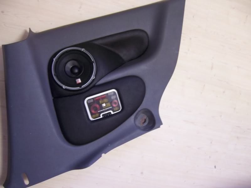

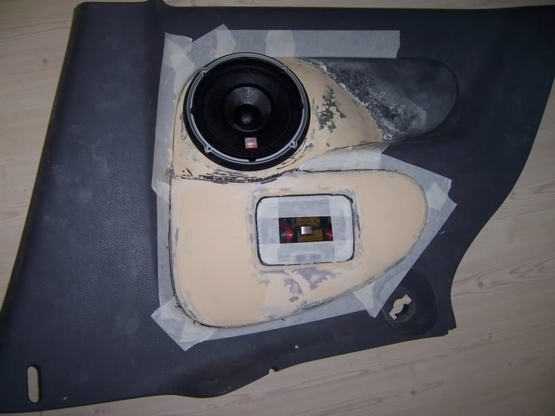

And then there is the rear speakers, went for the same set as the ones in the front,
The side panel:

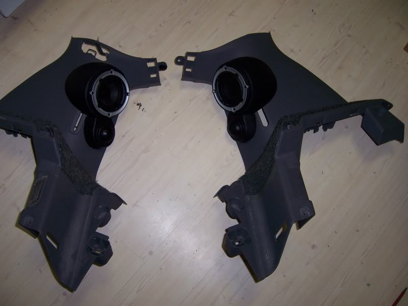

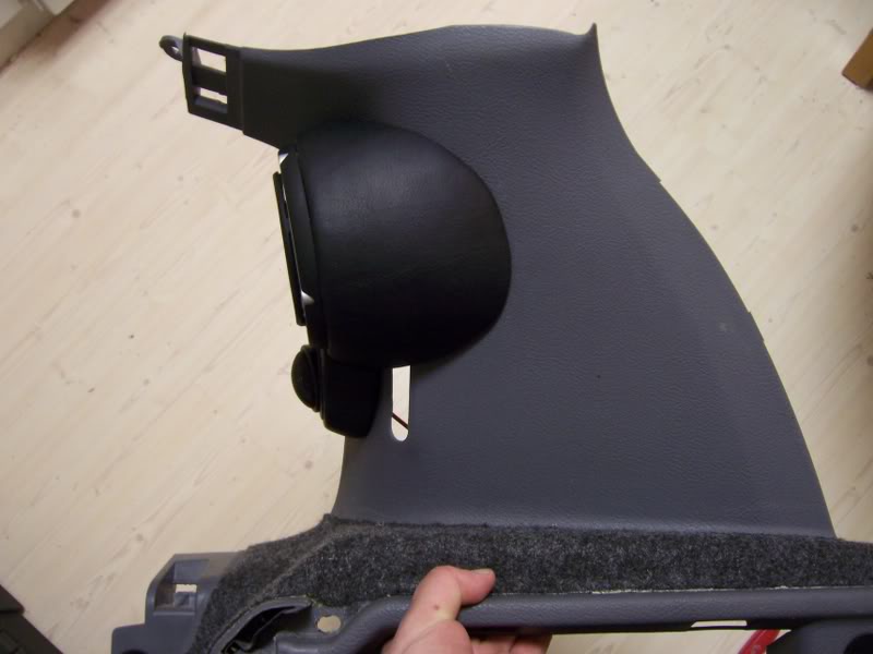

The midrange and tweeter will be mounted in the C-pillar, don’t have pictures now but will put some up.
Now upholstered with leather and ready for fitment, I’ve used real leather in the back and I went with some fake look-alike stuff in the front, and I’m really regretting that. So now that will have to be reupholstered with leather later on. Looks much better in real leather.

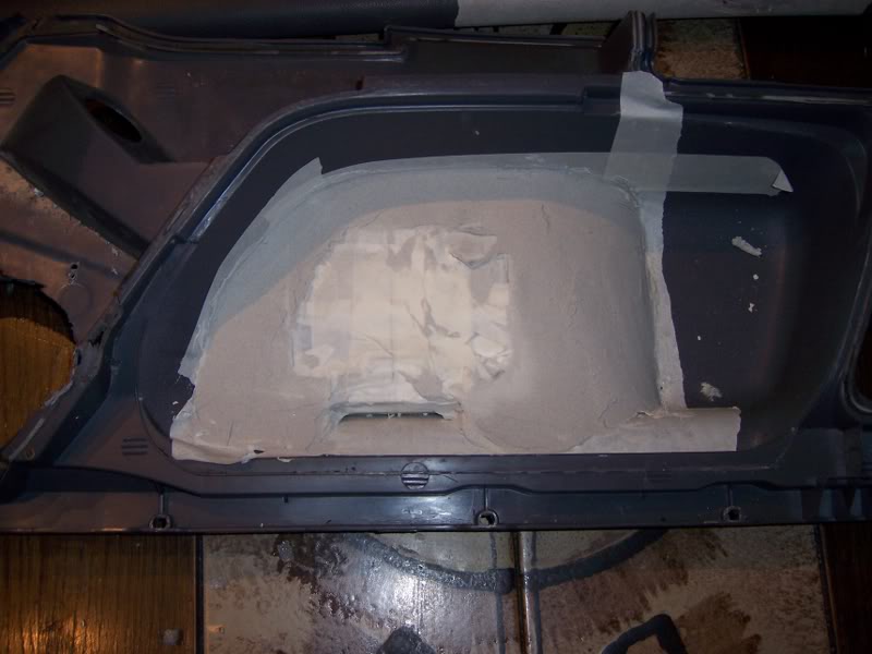

that looks amazing!! very brave for going with the 3-way imo as theres always gonna be a lot of work/fabrication involved when fitting them! have you got any more pics of the build process - sound deadening and fibre-glassing?
the JBLs look lush to ...what model are they? how do they sound?? have you got an install in the boot?
  172ph1
Thanks for the feedback, as for sound deadening- I’m going for dynamat in the doors and rear sides were I’m fitting the speakers. Don’t think I’ll do any further deadening for road/engine noise.
Speakers are: JBL P6563C
I’ll try and find some pics of the build progress, but don’t remember taken many. Boot is clean look, I’ll have some pictures later.

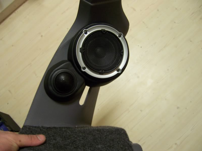

Here are some pictures of the c-pillar plastic; I’ve fitted the midrange and tweeter, now all the bits are ready for mounting.
The reason why I upholstered part of the plastic is to match the rest of the boot install; I’ll have pics of it this weekend.

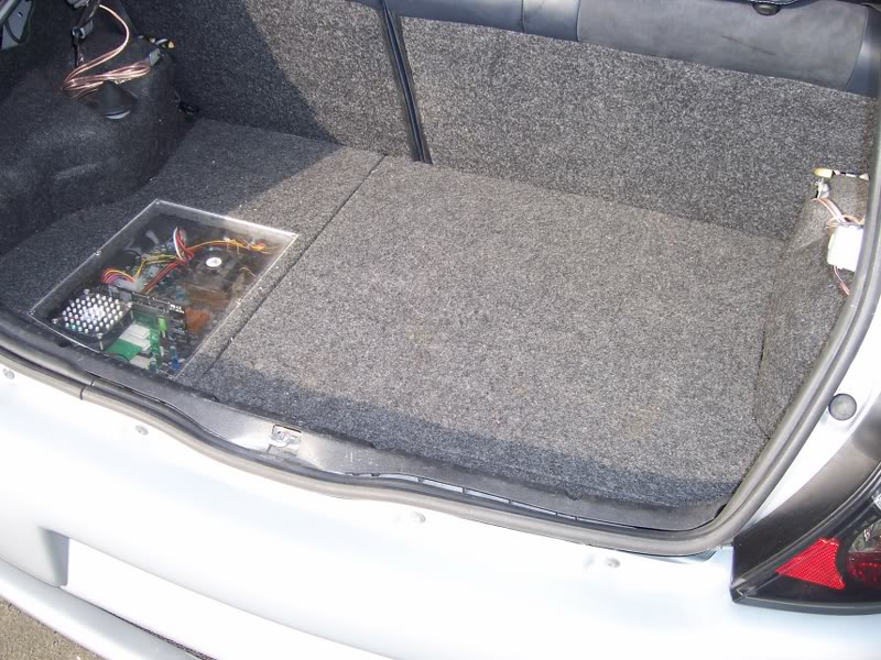

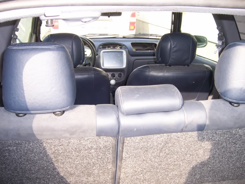

Then there is the boot; I wanted a clean and practical install.

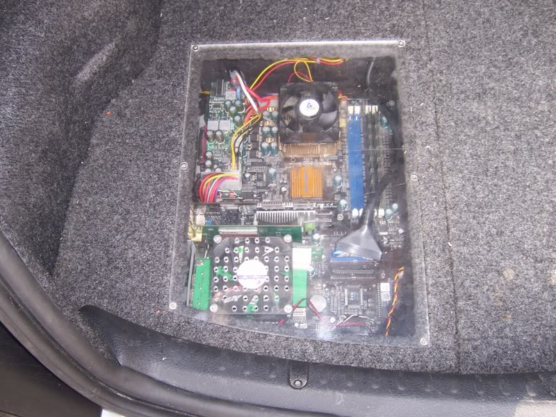

I raised the boot floor about 4-5 inches. I used it to hide all the cables and fitted the amp up under the floor I made a little Plexiglas window or what it can be called to show off the PC I fitted for audio & video playback.
It is nothing much; if I remember correct it was an amd 1.3 GHz on a full size motherboard. It is enough to run mp3 and videos

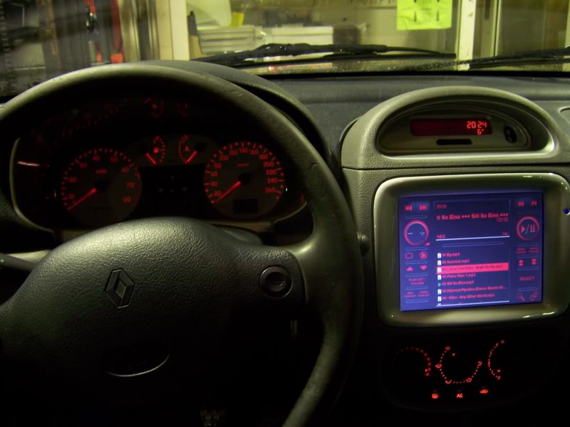

a picture of it running in mp3 mode, 8, 4" touch screen and very touch screen friendly software. Simple and functional. LOVE IT!!:cool:
Not running at the moment but fits very well in the Clio dashboard

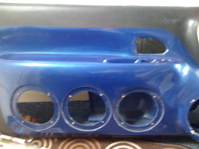

There is still one mod I've not posted that's the boot shelf, put a lot of work into it too,

As for the carputer, on the picture it’s running with "in car terminal" a very basic and simple software, but the moment it's running with standard window XP and centrafuse
