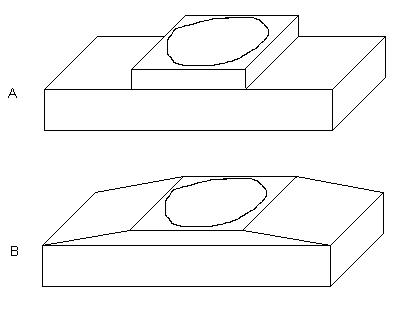

Also, if I was to do this, would there be much of a difference in sound between the to following designs (assuming that that is the shape of the inside of the encloses)
Obviously box b has less sharp internal corners, is this better? (if the internal volume is more of a pig to work out :D )

The two designs would sound the same, only consideration with regards internal shape is in relation to air movement around any ports fitted, no ports, no worries....
