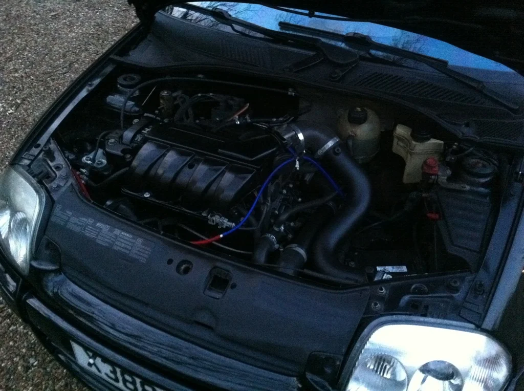

here are some of the lastest pics of my setup..
the engine makes about 110kw atw.. and feels very strong between 3k8 and 7k rpm... as thats where most of the torque is made.. other then that it drives like a normal clio while commuting..

currently im looking at diffrent exhaust setups, but due to financial constraints i cant do anything for the next 12 months :( im hoping to unleash a bit more bottom end, and considering some 182 extractors, de-cat vs metal race cat, and a selection of mufflers..

well that was the point of this mod.. in aus placing a ecu into a car can raise alot of questions from the authorities and from insurance.. some companys just wont insure a car with a aftermarket managment.... by keeping the management stock you can do as you please.. with out breaking emmissions laws..
as for swapping the head.. i think that there are a few changes to it and while it would of bolted up not everything may of lined up.. and buying a 197 head here in aus was compleatly out of the question. as it would of come with a compleat bottom end ;) (local breakers or wreckers wont seperate even 172 heads from blocks!)
but im unfimiliar with the diffrences b\w these 2 engines.. you guys would have a better idea about that then we would as you would of seen more of em..
