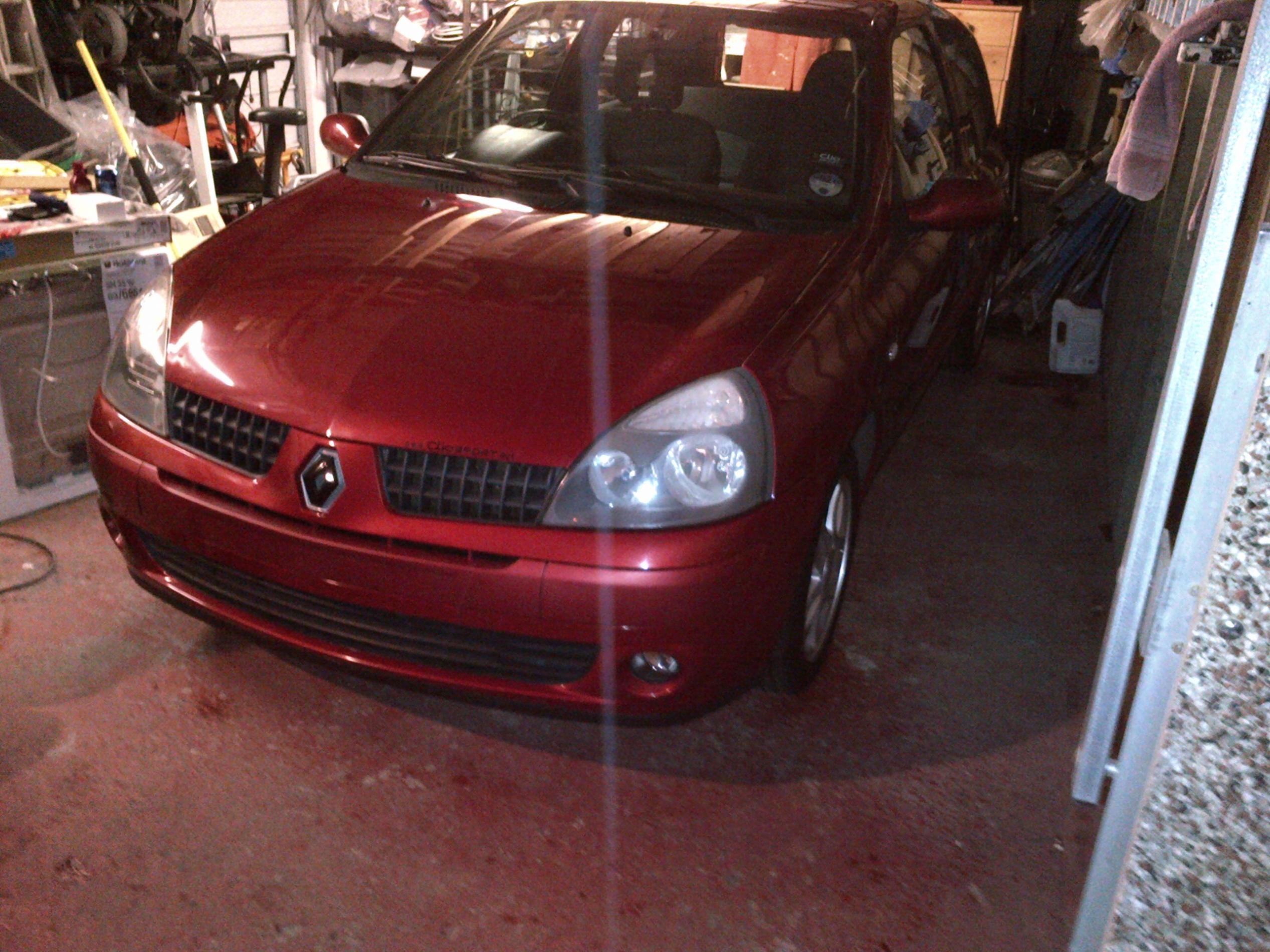

Cheers for any advice given, went to halfords today and bought Meguiars ultimate compound, Meguiars clay kit, Meguiars NXT generation wash and wax kit and Meguiars scratch X2.0. I used the NXT gen. car wash with the meguiars wash mit, then dried the car using the microfibre towel supplied, Clay and polished, wax supplied with clay kit applied using the applicator pad, trim, number plates and freshly painted badges re fitted, job done. Fairly happy with the results for my first time I've not seen the car in the sun yet but, just under the lights in my garage but it looks pretty good, heres the best pic I could get
