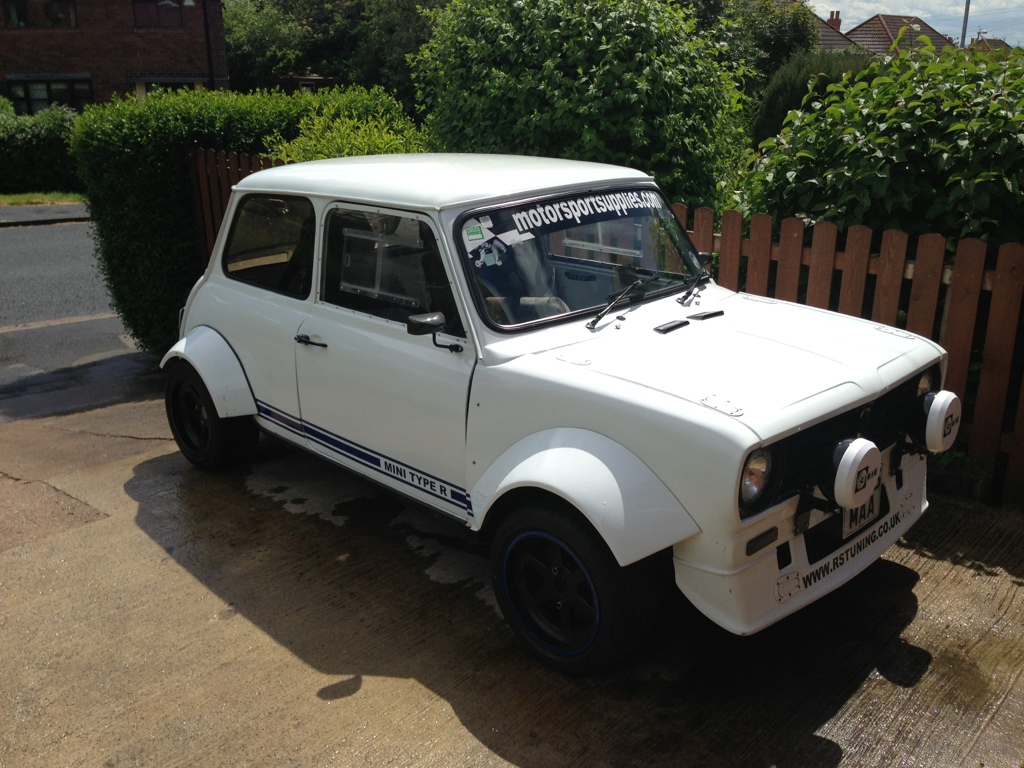

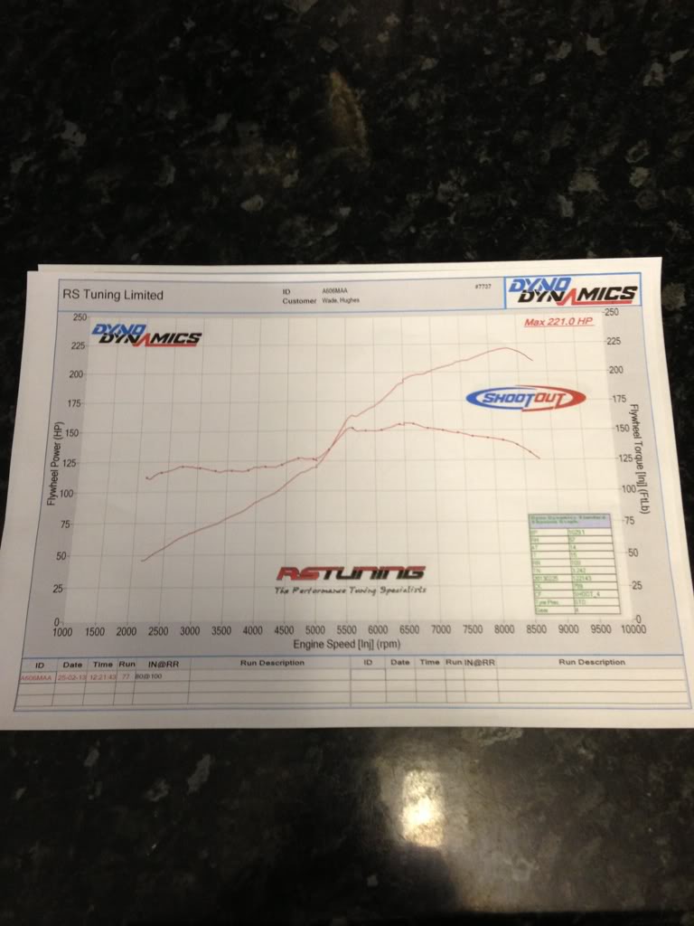

well yesterday i managed to get the mini booked in at rs tuning for its tweak on the map for the new injectors 2.5" exhaust system and the longer 90mm trunpets, to be honest i wasnt expecting it to make much of a difference from the previous session where it had made 203bhp
well after paul had worked his magic it made 221bhp and 156 ft lbs torque which on a dyno dynamics rrd is very respectable, its like a different car and goes very well now as the car only weighs in at 650kg :)
engine spec is b18c6,
diy headwork (by me)
b16b high comp pistons, around 12.5-1 compression
dc sports 4-1 manifold,
jenvey 48mm itb's with 90mm trumpets,
2.5" exhaust system

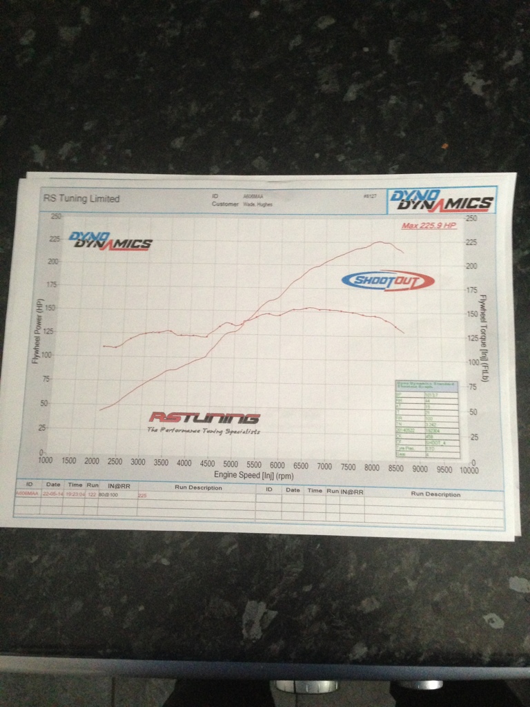

well its been a while since i updated this, i decided to fit some skunk 2 stage 2 cams to up the power a little more, i had to fit a rhicker head gasket just to make sure there were no clearance issues between pistons and valves so it dropped compression a little,
end result was a healthy 226bhp ::

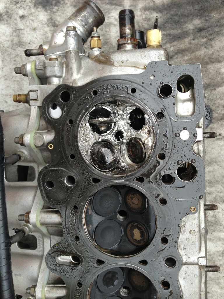

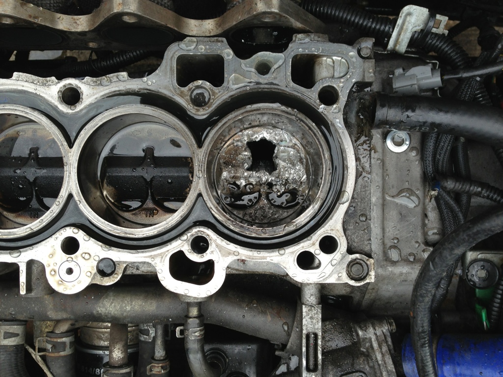

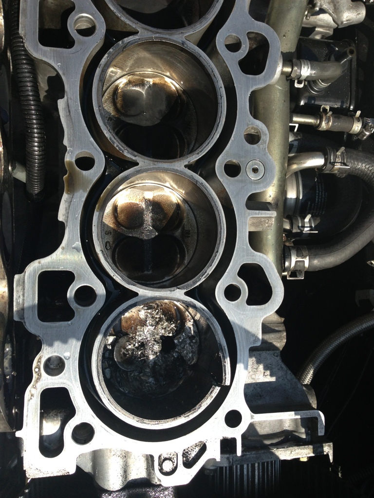

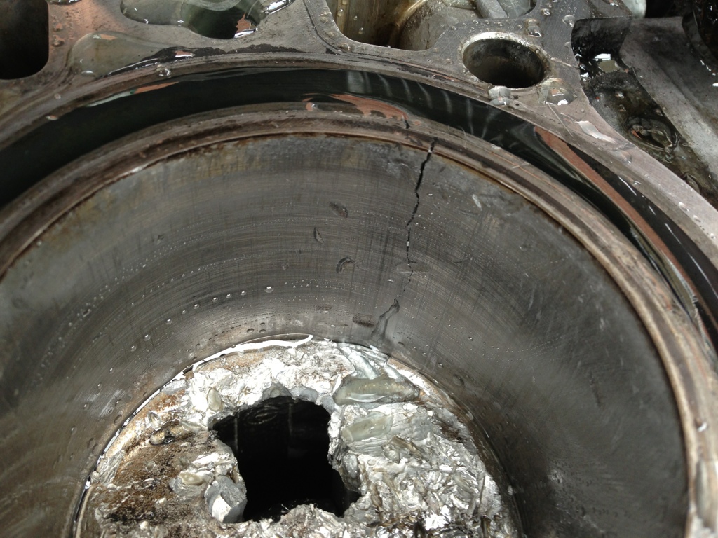

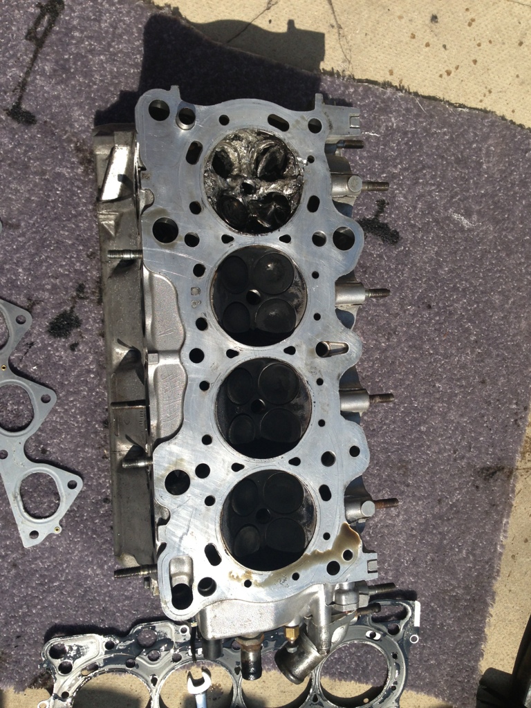

On my way home the car decided to drop a valve and destroy the whole engine :( I was advised to fit the uprated valve springs and retainers but stupidly ignored the advice and paid the price :-(
this is what happens to my poor engine

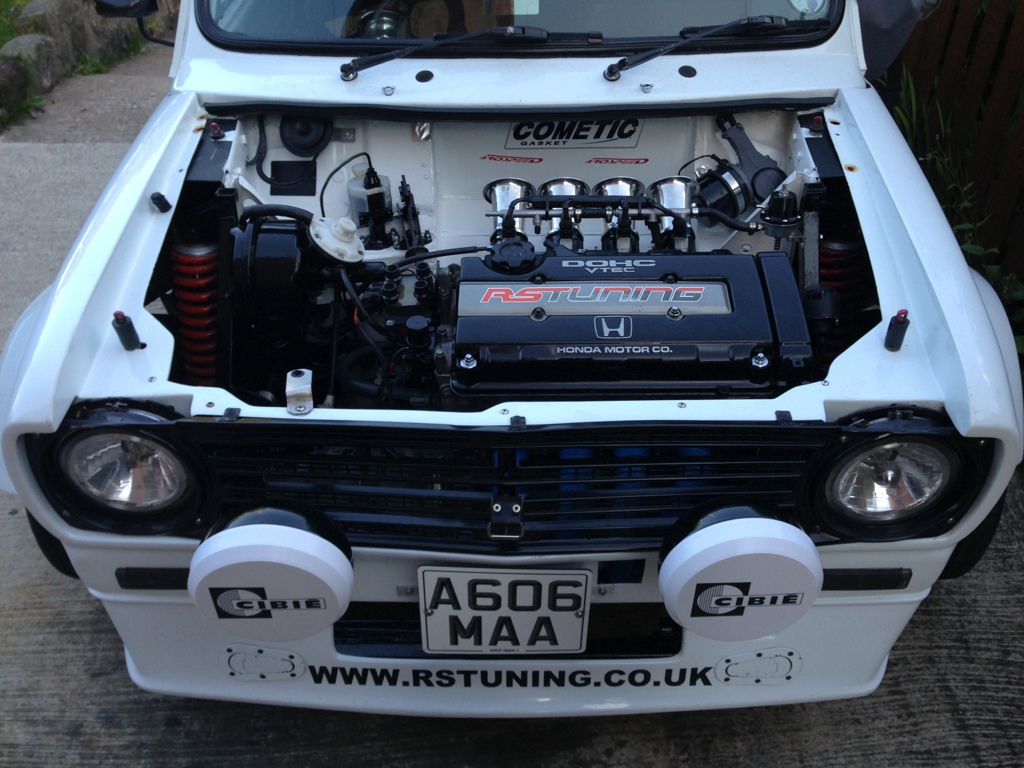

so after a big cry I decided to get hold of another block and get it bored out to 82mm from the standard 81mm taking it to about 1840cc :)
i used my spare ported type r cylinder head and parted with near on £500 for some skunk2 pro series double valve springs and titanium retainers to hopefully keep it in one piece, the car is currently up and running being run in ready for mapping, hopefully I should see 230bhp once done :)
here is how she sits now, I also added a set of cibie oscars for that retro cool look :)

God knows how or why but the engine is a mess, probably worse than last time, my suspicion is that the cams are to far advanced on the verniers.
​i think it's broken lol
