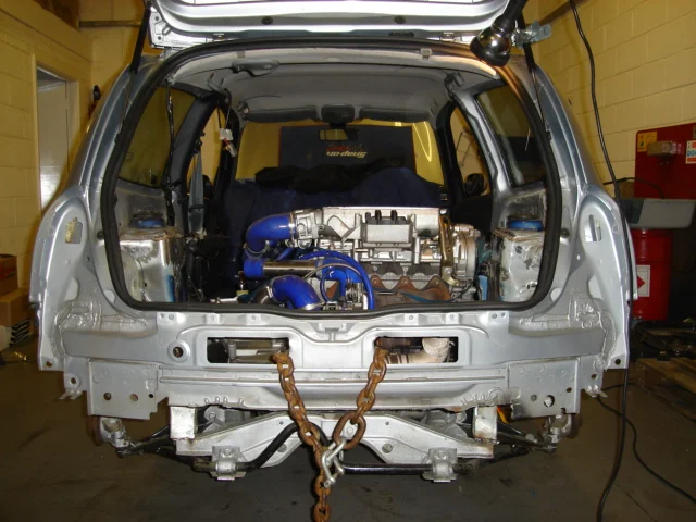

thought id post a thead my self with updates and progress of my
clio172 rear wheel drive project:)
mybe same pics as other thead posted by dan.clio but i want to post my own pics.
any suggestions welcome!
and yes i know i could of bought a v6 clio lol:rolleyes:

How are you cooling the engine? Could you leave radiators up front and run the coolant pipes along where the exhaust was?
stevo172-RWD
  clio 172 rwd
Re: 50% complete 172RWD!
you read my mind lol;)
im thinking polycarbonate side windows with scoops/vents
also exit heat vents on the rear.
dont want it to look silly though.:)

Will you need to uprate the water pump if the water is traveling a greater distance?
Are you going to give the car any form of additional air cooling, side vents and fans (Turbo II style) where is your source for the induction, any plans for a FI conversion?
It's good to see you are going for the 'measure twice cut once' approch to the build, there's nothing worse than a rush job.
Sorry for the list of q's but I'm really looking forward to seeing this complete.

The trick with a water-cooled engine in the back and radiators in the front is to get the heights right and the air out of the system. Most people don't think about the fact that the fill point (normally the radiator cap) and the overflow has to be highest point in the cooling system. There can't be any higher points. And if there are any other high points isolated by a pipe running down and back up there'll be an air bubble there that won't do any cooling. Which can be a real problem if that high point is, for example, the cylinder head. And you won't even know it if the water temperature sensor is below the air bubble. You'll have a good low water temperature, but your cylinder head will be overheating. And the only way to get rid of an air bubble is tilt the whole vehicle on end.

the engine is the same set up for cooling as before but i may use too rads one front and one rear.
im using the header tank in the fron as usaul.
im using a extra water pump,mybe electric.
gear linkedge is a pain too!

How about a V6 style design, 2 scoops from behind the doors on ths quarter panel, with 2 small radiators, one fitted on each side of the car.
Have a roof scoop for the airbox / filter.
good good but i dont want it too look like a v6!:eek:
i like 172 looks.
in going to put hose from polycarbonate window on rear.
not sure about cooling yet lol
anyway it will be winter when its done lol:lolup:
stevo172-RWD
  clio 172 rwd
the engine will be a lil lower than usaul at front.
famous last words itl be ok lol;)
