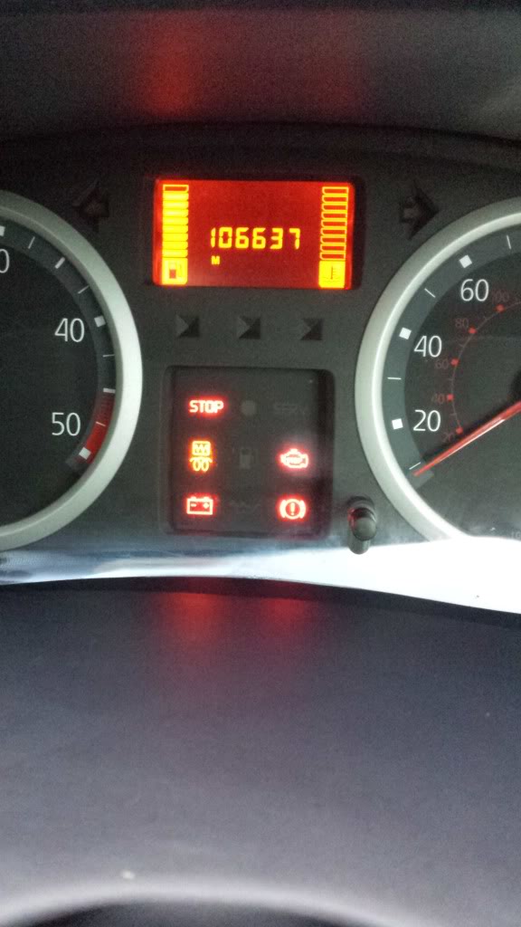

Can anyone help ? Cars been running fine no indication of any faults parked up this morning come home , waxed the car went to start it and nothing :( engine turns over but just wont start i get the engine light constantly flash and what i thought was the brake wear pad light stays on
Its a dci 1.5 100bhp
Heres a pic for the lights

Light on the left is the glow plug amd general fault lamp. The one on the right is the serious fault light which normally illuminates when a fault is present that prohibits the engine from starting.

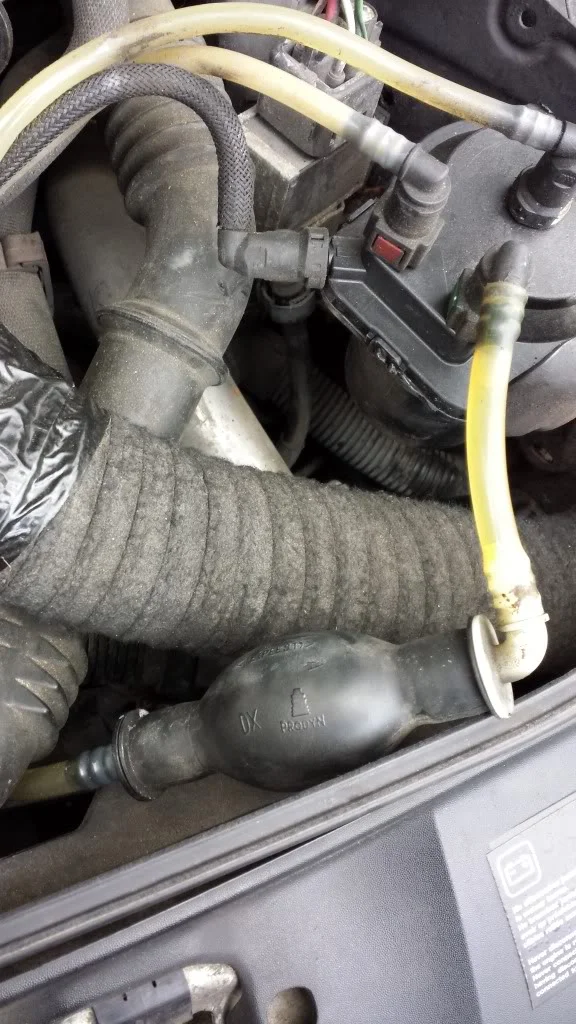

Air in the lines by the pump bit at the front of the engine bay ya mean? There was some air gaps in the longest pipe i believe but there isnt now

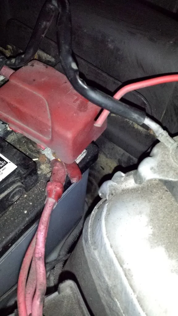

I think this wire may be from a sub but aint followed it back yet, do all dcis have this amount of connections to battery as standard?

That wire is an extra and not an issue... Diags first... everything else after.

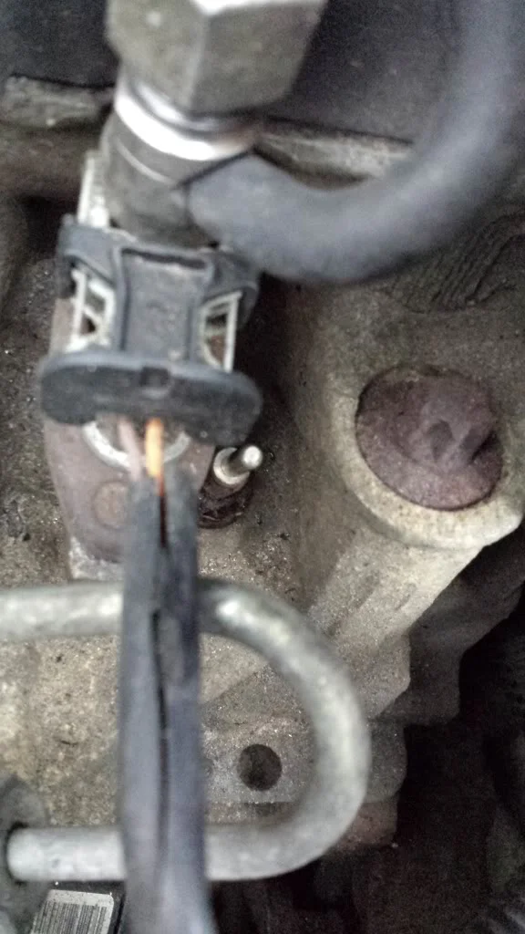

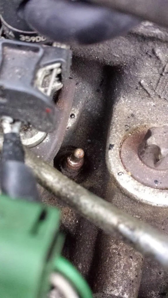

Ok first of all this probably will sound stupid as i dont know much
are these the glow plugs?
if so does it being this rusty make it not start?
also i think theres air locks in the fuel system - would these cause my issues?
can i fix the air by pumping this lots? Or will i flood and brake something.
sorry :) hope this helps
Yes the glowplugs are where the spark plugs are on a petrol vehicle.
some air is apparently normal, a lot of air is not - You really need to have it on some diagnostics mate, that'll show if there's too much air as the common rail pressure will be too low or whatever other issues there might be.
  2004 100bhp dci
Can i not release/pump the air out i know i shud put it on a diag but i literally have 50 to last the month so if i can fix it for free would really help me out
You could try - if that's what that hand pump does, try it and crank it to see if it starts, after a bit of reading, they can sometimes take 20 seconds of cranking to fire up if there's air.
If you can't afford to have it on a diag just yet - you should do as much research as you can, try the cliodci forums and also Renault Forums,
.i.e here's an issue that sounds pretty like yours - engine stop light flashes ~10 times on starting, has air in the line up to the primer ball (which i'm guessing is that hand pump)

Air in the lines leading up from the tank is normal, won't really affect anything since it pulls up more fuel than the pump needs anyway. It's air in the lines between the pump and fuel filter that'll cause problems. It's a complete guessing game without diags though. The light being on in the first place is usually what causes the starting problems. It puts the car into a limp mode or something
