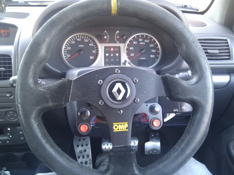

This is mine:
The mount (and red buttons) are from demon tweaks with the black buttons from ebay.

This is mine:
This looks good. Can you suggest a list of all parts to do this conversion please. Is it easy to wire up the horn and CC buttons?
