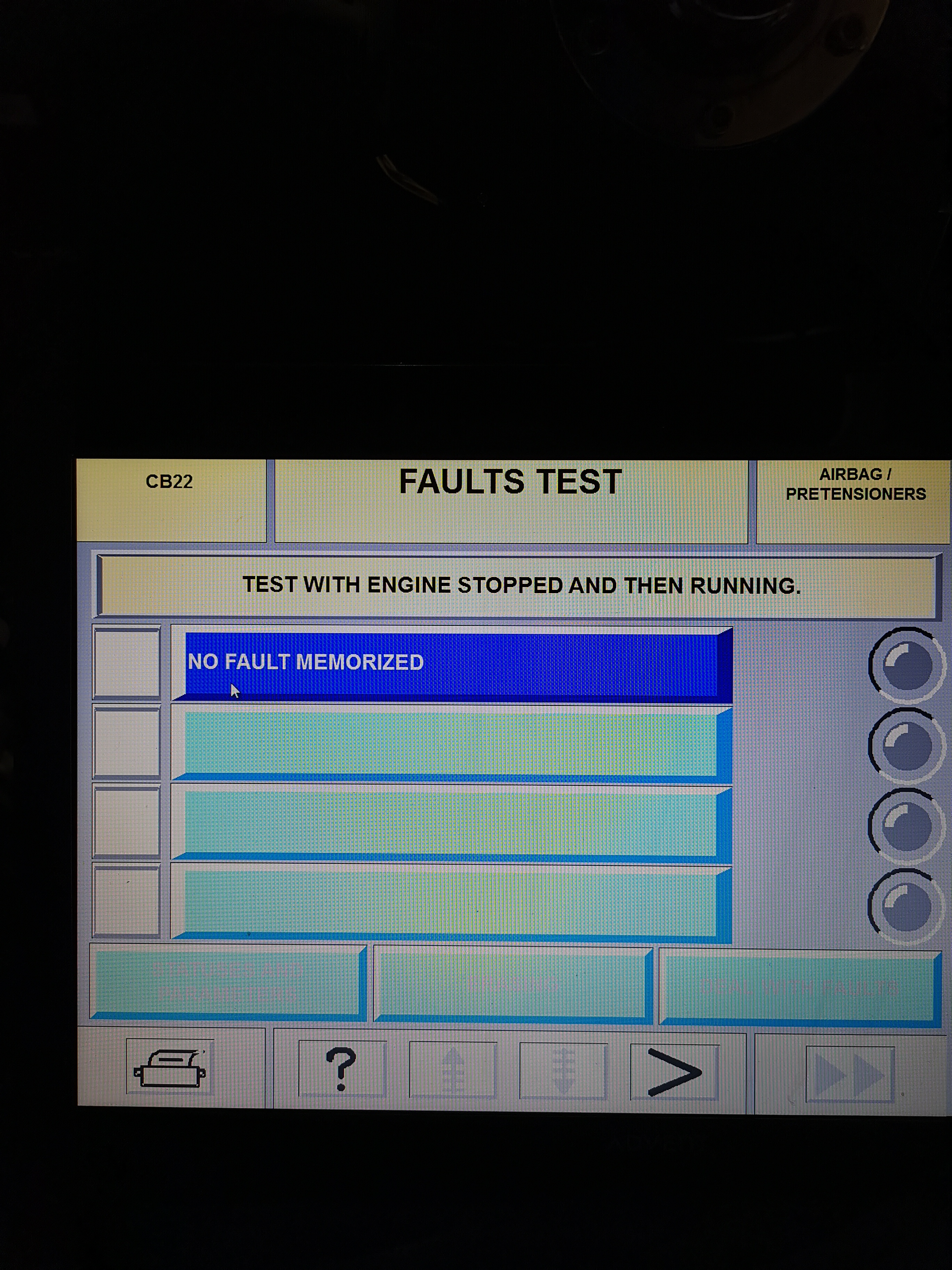

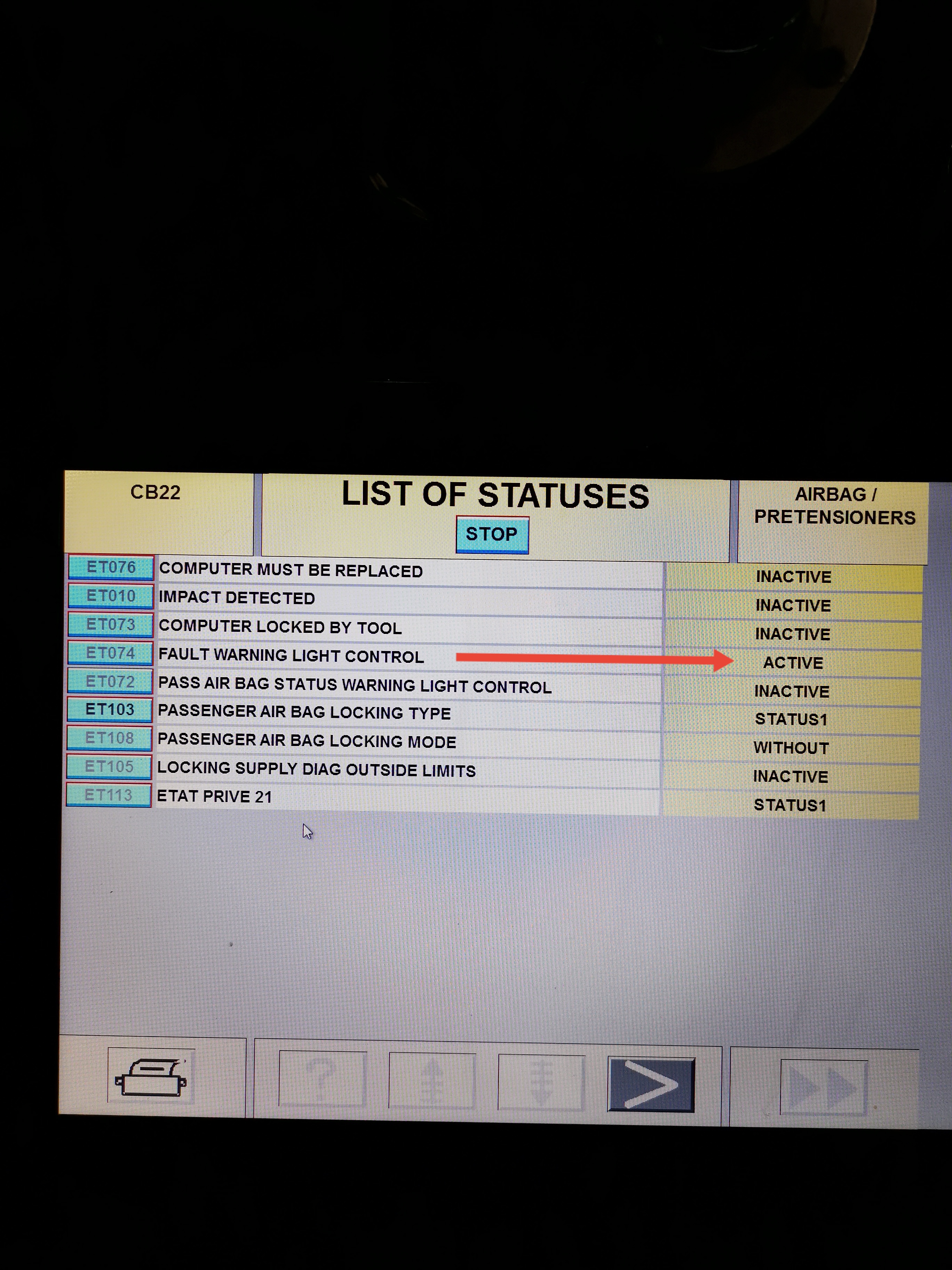

A lock/unlock and ign cycle then allowed me to erase those codes!
I now have 0 fault codes, but a airbag warning still on 🙄
There's still a request from the airbag ecu for the warning to be on. May require more digging! Lol

I had similar issues to this and i cant remember how i got round it. Serv light on?
  Clio 182
Ahhh get thinking! 🤣
Yes, SERV and Airbag light on. I haven't checked, but had a thought this morning that maybe there's a fault logged in the UCH for the airbag ecu from when I first plugged it in?
  Clio 182
So, to update, I had a code stored in the UCH for Airbag multiplex.... Presuming from when the changes were made. Cleared the code, and didn't seem to make a difference. Disconnected the battery (as its a race battery so I always flick the isolator) and next time I came to it were all good
