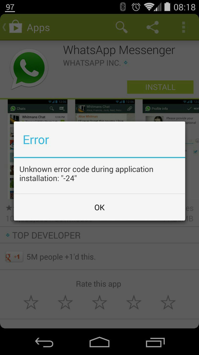

Just got 4.4.2 and it still won't let me use what's app on ART. Do I need to go back to the old one and install then turn ART back on?

Well this is the error I get running android 4.4.2

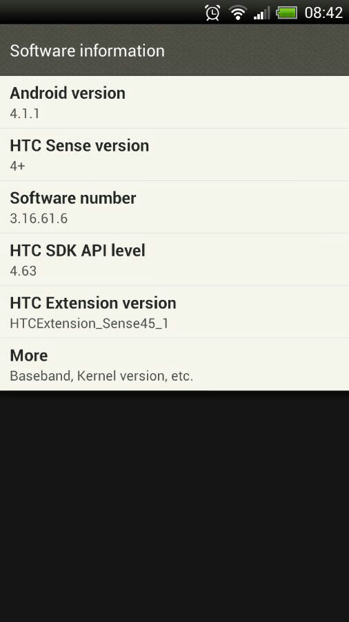

I have a HTC One X but I'm still running on this:
Just checked and there are no updates to be found. Why aren't I on 4.4.2?

Well I've tried the above and it still doesn't work and comes up with the same unknown error.. Email sent to the developer.
I now have the answer. Apparently if you tried and failed with ART before it updated to 4.4.2 then the only way is to reset the phone or root in order to get to the directories.

Dan, I don't think the HTC One X will ever get the update over the air.
As it's a few years old now and a few versions behind.
Should be able to root and install manually though, can someone confirm that is possible...

You won't get the 4.4.x update for months mate, just the way it is with HTCs, Samsungs, etc. The only way to get these updates this quickly is with Nexus devices.
