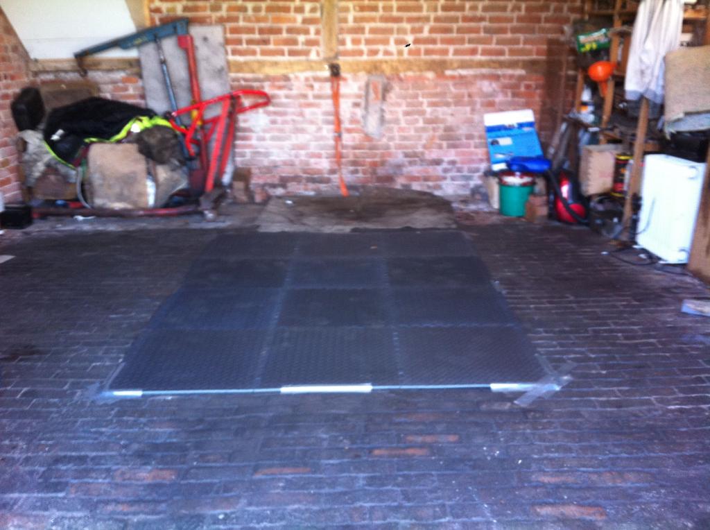

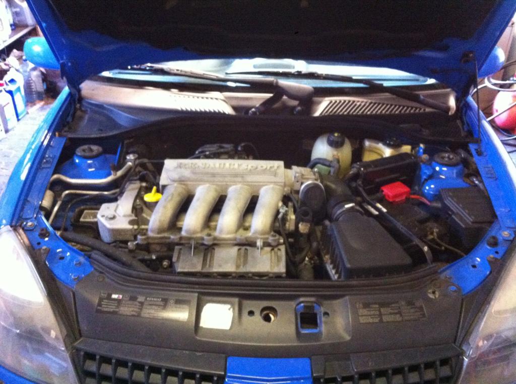

So I've started this now.. I'm swapping out a noisy dephaser pulley and be silly not to do the cam belt while doing it! So Ive done a fair bit of research on this now.. I was going to pay out and get this done by a specialist and to be honest by the time you've bought the tools and belt kits etc, you won't save that much in the end.. but.. I do like a challenge..!! Im doing the job in my shed and taking my time. My shed:

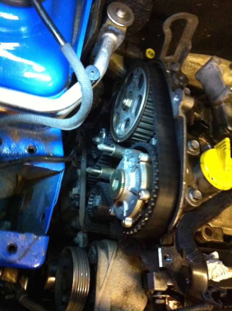

So far I've stripped everything down to the Cam belt and pulleys, from here:

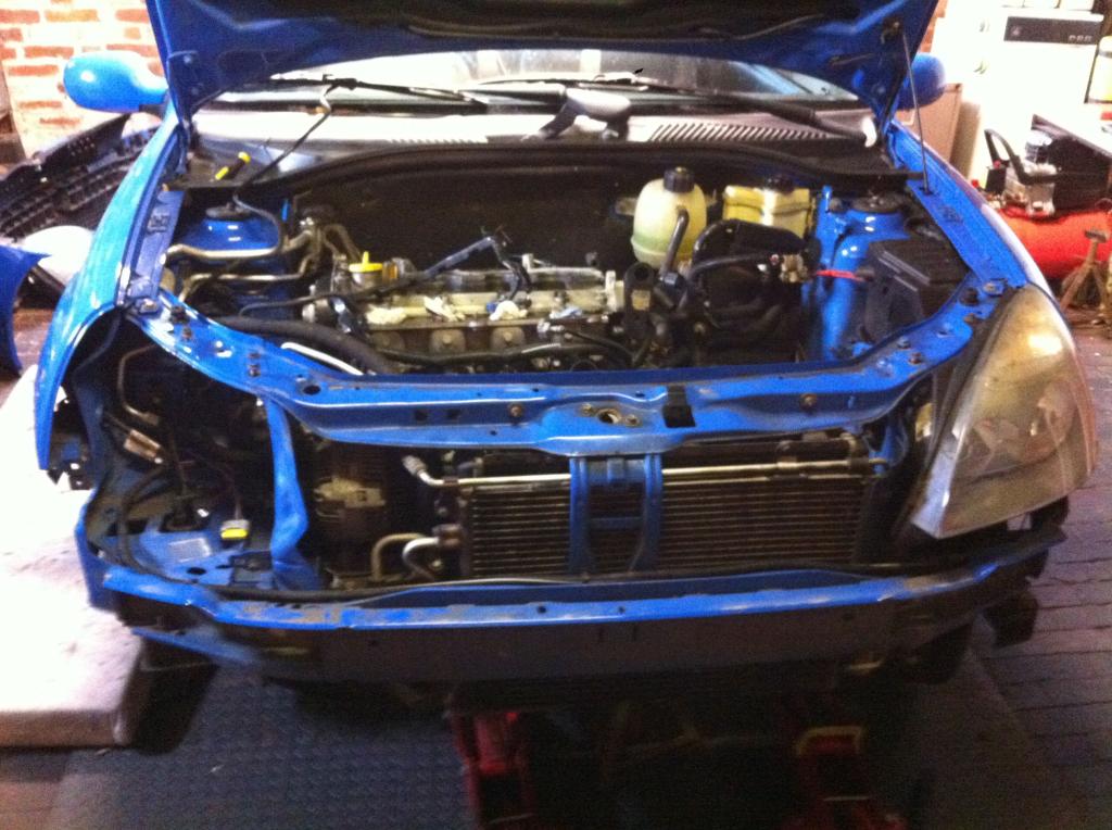

to here:

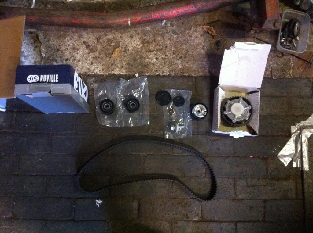

Probably didn't need to take the bumper off but just seemed easier for access. Now I'm waiting for the timing tools which I've ordered from Adams place above. (Thanks Stu.) Don't think Im going to be able to get back on it now till next week but any pointers appreciated. I know the cam pulleys are floating, Ive done a head gasket on a zetec engine so assuming will be like that ish.. Ive got all my bits from GSF:

Cant really see from my rubbish pic but some kind person has nicely rounded the ex cam nut on every damn corner so that will be fun to slacken off!!!
The hex nut shouldn't be too tight, its only a cover with a seal, there is a fastener underneath that holds the dephaser on.

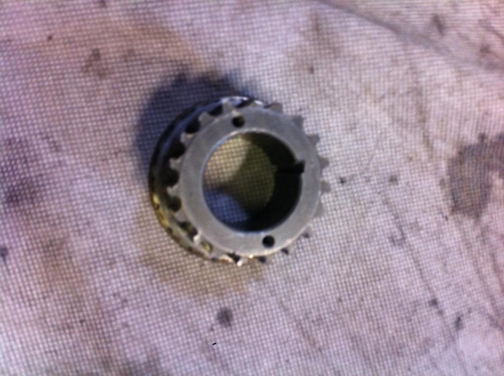

Was going to get this job finished today as i have a free day. So off i toddle to Renault to pic up new crank timing pulley as mine didn't look to clever by the time i tapped it off

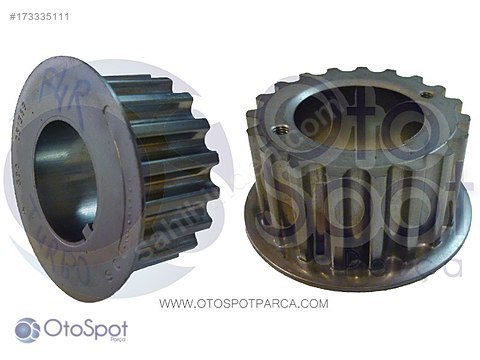

So i wanted to play it safe and replace. The pulley they have given me has a keyway in it and is not the same part as the one thats come off the engine. The keyway in this one means that (if it fits) it will not be floating on the crank, it'll be keyed. Anyone know the right part number? Part number i got is 8200251569 which seems to be right but the timing pulley is defo not the same. Its a 2005 182 btw
  MG ZR x2, Polo, CTR
I think that's the megane pulley.
iirc it's an updated design as its not unheard of for the old crank pulleys to slip in use and put the timing out, the key stops that.
Your old one looks well hammered!
  clio 182
Yea it was pretty narly, so i just whacked it off with a large screwdriver as i knew i'd be replacing it anyway. Renault have just come back to me to say the official Renault documentation, references the wrong part number!!! So the right one for future ref is: 7700108817

There's no need to hammer these off. All you will do is knacker the pulley. They have two threaded holes in them that allow you to put two bolts in and turn it to free it up from sticking to the crank with corrosion.
It needs to be freely moving in order to be able to accurately set the timing and tension.
The woodruff key on the new pulley may be removable. Give that a try.

Finally finished this job on Friday! Haven't test drove it yet as I need to put bumper back on and didnt have that much time Friday..... but it fired up and was idling nice and smooth on cold start. I reckon all in it took me about 10-12 hours lol but I was taking my time and cleaning up bits and bobs, tidying scruffy brackets and stuff. thanks for all pointers, quite a challenge if you don't do them all the time..!
