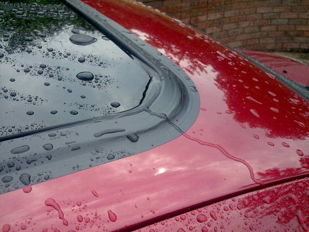

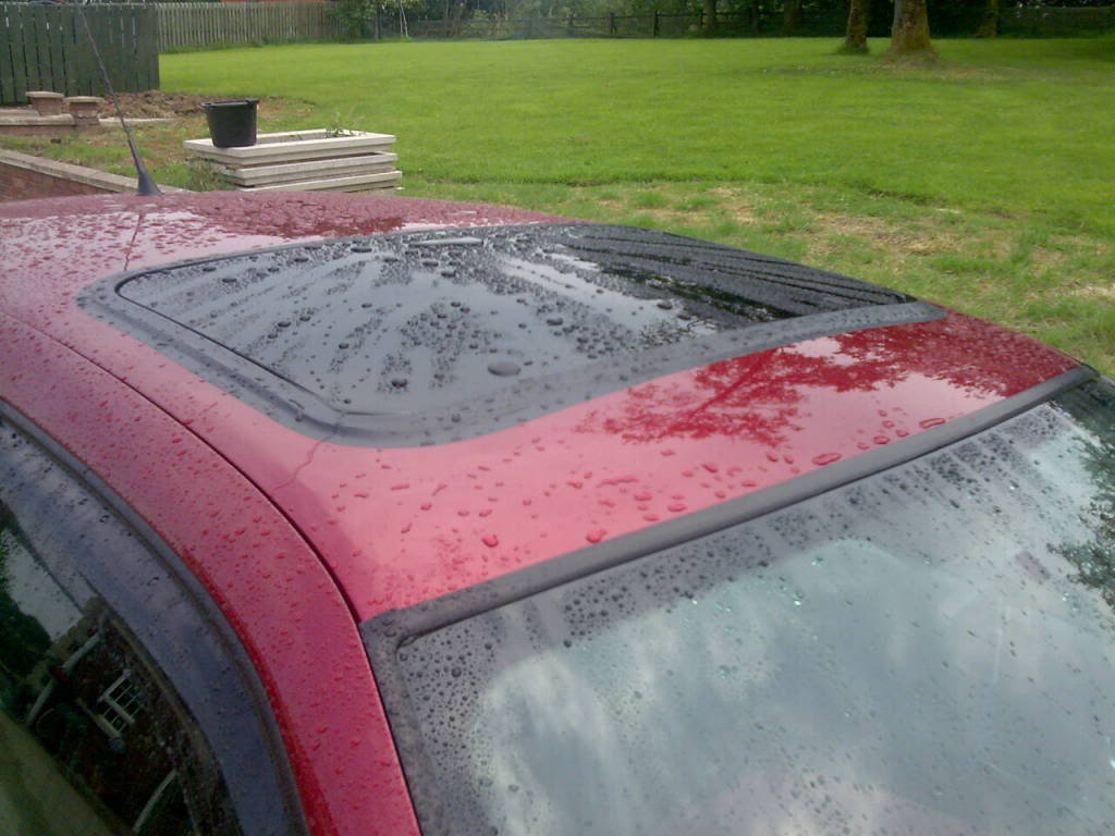

after weeks of getting soaked via my water feature/mk2 sunroof, i decided enough was enough. having spent an hour or more trying to unscrew all the hidden 10mm bolts to release the pastic sunroof casing in order to reseal it, i discovered that one of the bolts would not unscrew. after hours of battling, i decided on another route.
quick trip to halfrauds for some black insulating duck tape after failing initially with some loctite flex sealant on the outside. i had tried to seal from the outside-in with the loctite but that looked a complete mess. so i decided to tidy it up. took about 20-30 mins to do patiently so as to try and keep straight lines etc, but here's how it looks now....
I know its not perfect but it was the best i could do given my cirumstances and its completely waterproof. the tape has been on over a week now and no shrinkange or peeling with cold or heat.(fingers crossed)
much better than paying 100-250 quid to get it resealed by someone else :)

cheers mate. it was surprisingly easy. i tought the corners would look like a dogs dinner but the tape is very flexible and doesnt retract once its been stretched slightly. when your standing a couple of feet away you wouldnt really notice it unless you were really looking for it. just though i'd share this with other members thinking of getting there's sealed who would be happy enough if they could do a DIY that would turnout like mine.
i used some alcohol impregnated wipes to totally clean the plastic casing and the metal bodywork of the car and used 3 layers of tape. 1st layer was the seal between the frame and the bodywork. 2nd layer was drom the edge of the plastic casing nearest the glass, followed all the way round so as to overlap the 1st layer. 3rd layer overlaps the 1st layer on the bodywork end to give more support. hope this helps a few peeps.
plus the duck tape was £1.39 from halfrauds for 10m and withstands temps from 60C to -5C :) result

doesnt look that bad. ive seen worse silicone efforts. believe me i would have done it right had i been able to remove the frame but if i forsed the issue i would have probably broke the frame and kinked the tin roof and THAT would have looked worse. sometimes you have to make the best of a bad situation matey:eek:

thanks for that, just to clear up, the sunroof still works perfectly as its should do. i've only sealed it around the frame. its had flood like rain, snow, frost, and not a drop has got through it or damaged the integrity of it. i showed it to a mate of mine who's quite the car enthusiast and told him i'd done somethin to the car and he didnt notice it. it works and thats all i'm concerned about as i'll probably keep it till it stops as it wouldnt pay me to sell it at the moment
