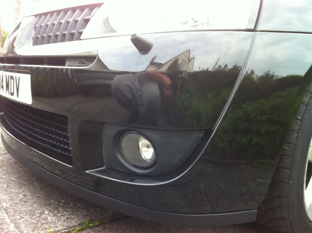

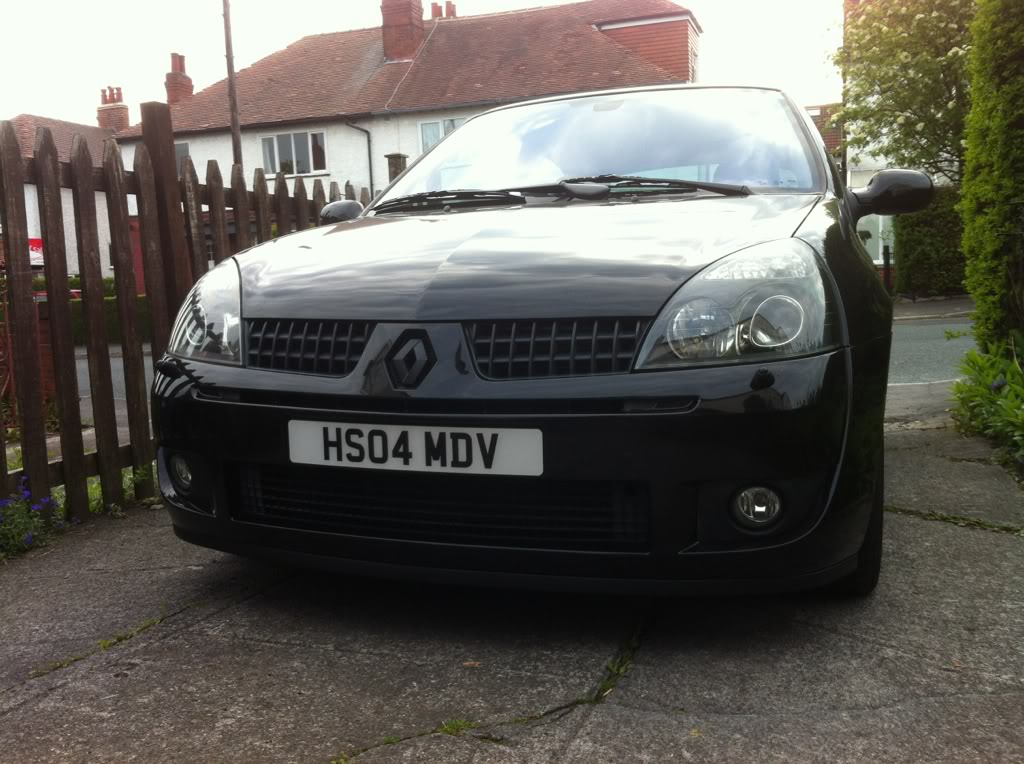

Picked up from skoda today after work and fitted with my brother (readie) only thing i have done to my clio so far as ive just bought it! not planning any major work just little touches here and there will keep updating

Hi mate, love this 172. Always wanted one. Can't yet, as i'm 16, s**t! anyways, I've ordered a fabia splitter for my clio, should be here by the weekend, is it easy to fit? I got self tappting screws ect ect
  Inferno 182FF
very easy we attacked it by finding the middle of the splitter and the middle of the car then put a screw straight through the middle we also drilled holes at even spaces but you need a few more to pull it in around the corners and a sharp knife to trim the tags off where the screws are in the original bumper
