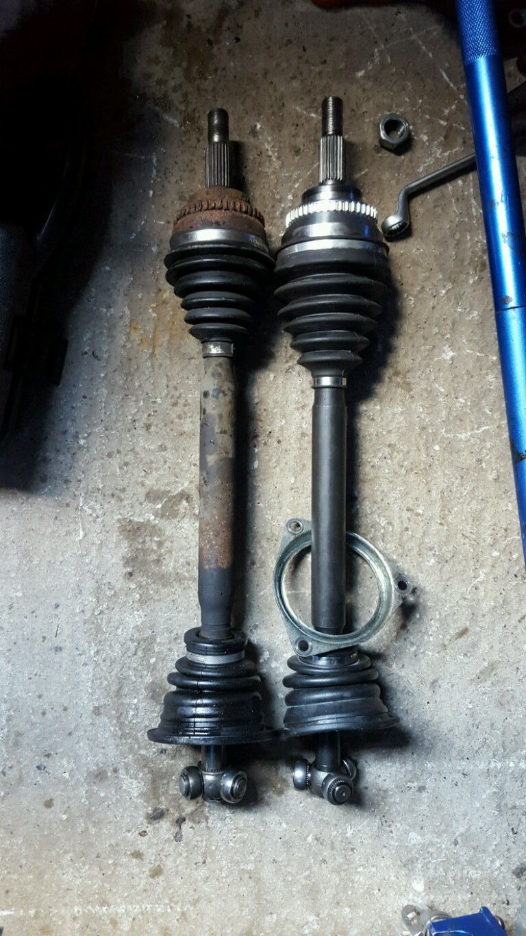

The 209al was the one i bought i will put a pic up of them side by side

Heres the driveshafts together you can see the shaftec one is just slightly too long. I have found somewhere to refurb my original for £90 now so this one will be up for sale iam assuming its for a standard 1*2

There appears to be a few extra threads on the shaftec piece,but in what way would this compress/load the CV joint?
The critical length is between the gearbox & the hub/wheel bearings.
Was the Ebay listing a private or business listing?Have you a record of the item number?
Too my eye,judging by the extension of the CV boot,the shaft is too short & is probably a non cup PH2 R218AL thrown into a correctly numbered box.
I do not have a personal axe to grind,other than that ill informed comments nearly swerved me to paying more than twice the price of the R218AR that`s doing perfect service on my non cup 172 PH2.
If Cup shafts are NLA from Renault,& K-Tech are £249 a side for Cups,then I feel that is it appropriate that there should be some feedback from someone that has purchased Shaftech from a reputable source.

All i know is its too long i managed to bolt it up but it took some effort and i had to use a lot of force to get the balljoint to line up with the holes and then it was making a strange clicking grinding noise when turning by hand its obviously not supposed to be forced on. its probably is a standard 172 driveshaft as for the quality its fine. I bought it as a cup one but it was months ago i didnt have anything to compare it to till i took mine off.

Sorry,I do not have figures for LH shaft.The RH is 430mm standard 172,440mm for Cup.
