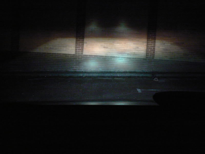

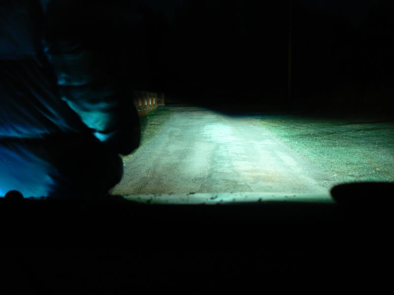

Only done one side but the other will follow next week. The settings on the camera are wrong but you get the general idea with the light spread etc.

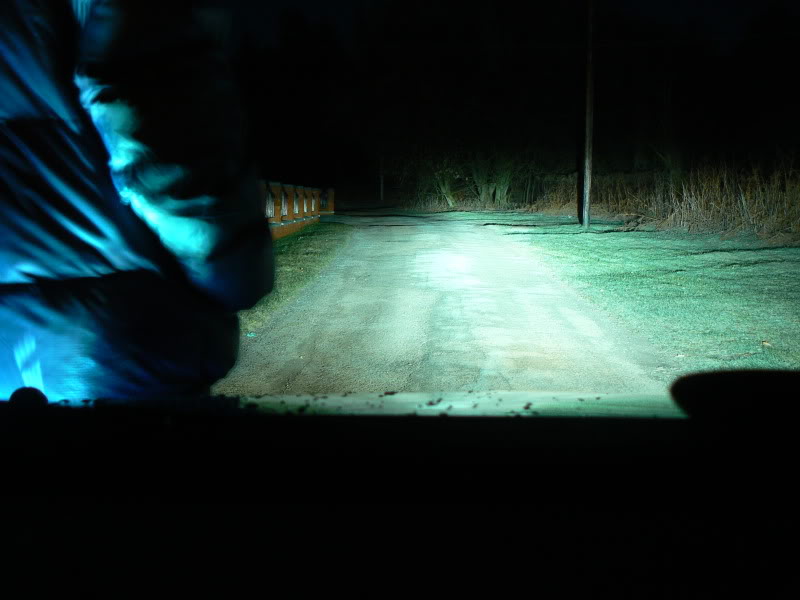

Factory halogen projector
Dipped beam
Main beam

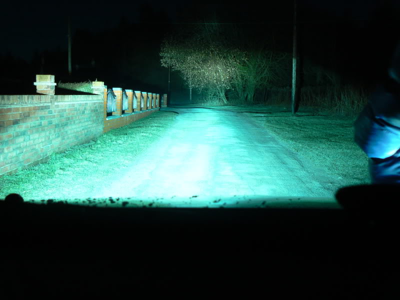

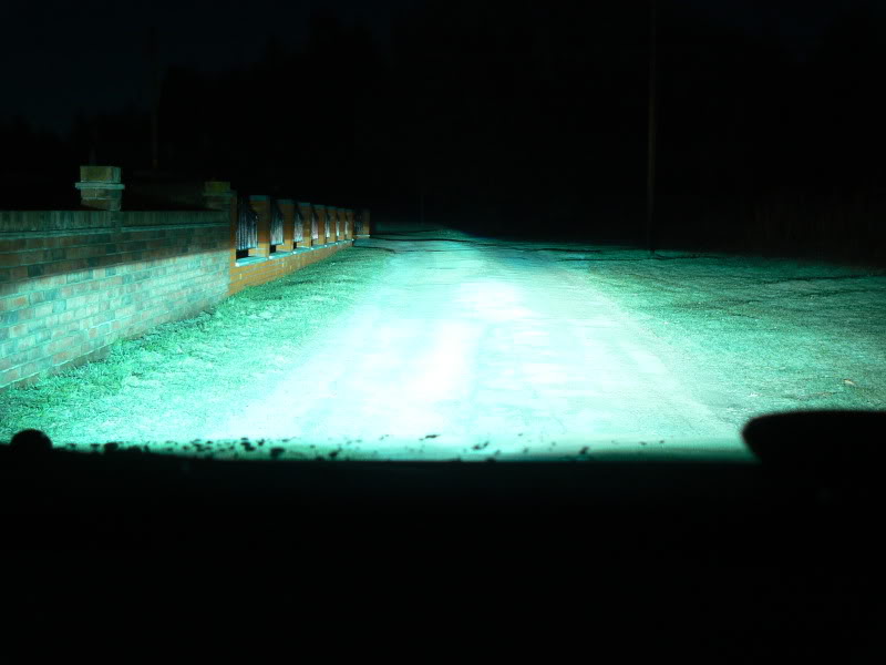

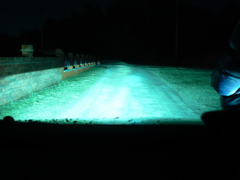

Bi-Xenon
Dipped
Main
Using Morimoto Mini DS2 projector with Osram CBI bulbs.

On the test run it was proving much better. Can't wait to have both in.

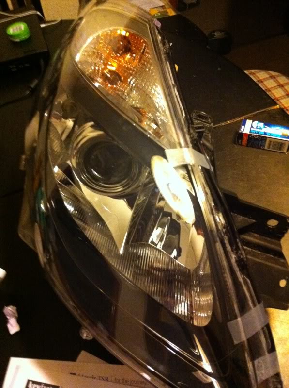

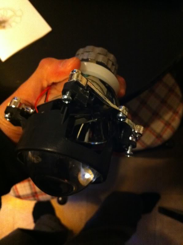

It looks the same as the normal 200 projector headlight. Is that what you were asking?
Projector in question.

Just remember there is a bumper support bracket (I think?) that's riveted onto the headlight itself. You need to drill it out and replace onto the new one.

It's really quite hard to capture the difference in the pictures. The intensity is better on the dipped beam but main beam is so much better. You also have to bear in mind it is only fitted on the NS right now.

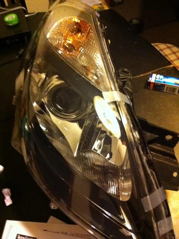

Headlight pic.
I'm fittng the other side today so should have some cut off pics by tonight. There is a slight colourband from when I fired it up in the living room.:)

I think i understand now..
The Main beam and dipped are both in that projector? but you also have the standard halogen one?

That's correct.
I have put everything back together so will get some finshed pics tonight.

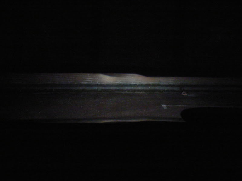

Now finished.
ISO 800, speed 1/4 and Aperture F8.0
I'm trying to see whether I have installed the height motors correctly as they seem to be pointing quite low.
