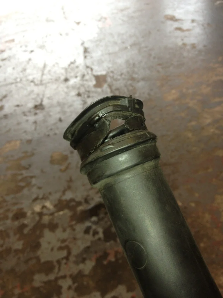

My Laguna recently hasn't been pulling as well as it does normally but I took it to see Paul at RS Tuning for its remap regardless and en route noticed peak boost was down and it struggled to hold a decent level but thought nothing of it until it ran up on the dyno... Then we noticed the power/torque dropped off a proverbial cliff at 3.5k so investigation required:
The words "b****cks" instantly appeared out of my mouth and luckily Renparts are breaking a Laguna Turbo at the minute and Kat saved my ass!
New pipe, massive smile on my face again and the car pulls like a train once more. What I'm saying is that even though every chav in a boosted car has one (AndyRG) they also perform a basic but vital diagnostic function to no matter how much power you are running.
