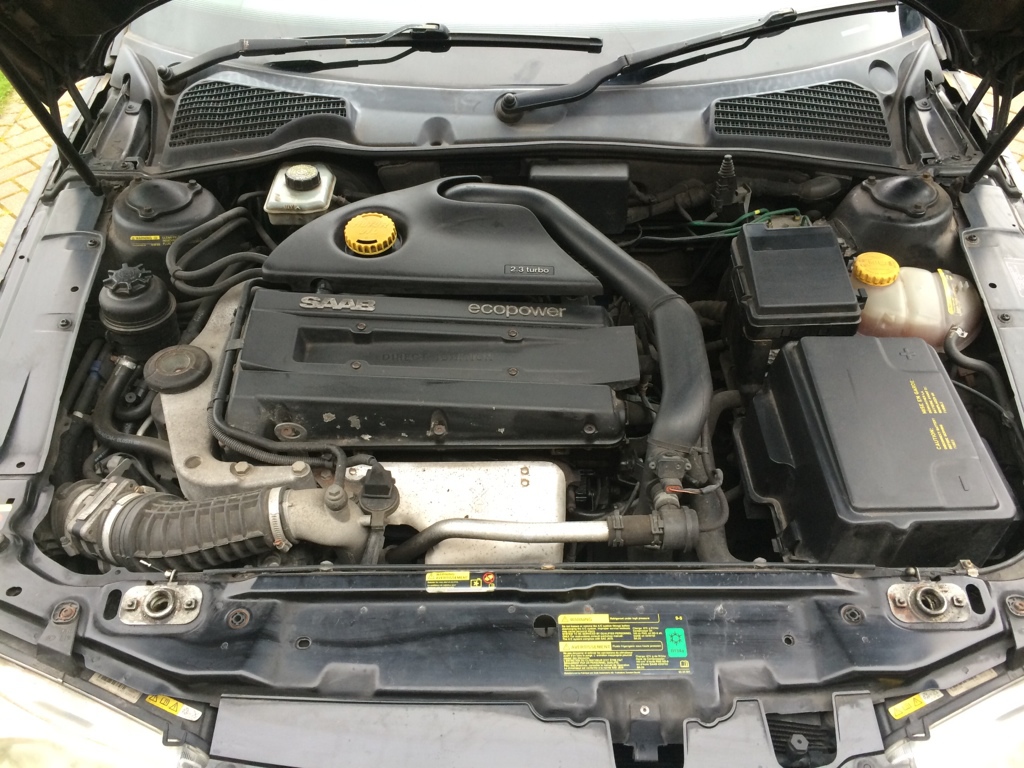

Didn't feel like it was as healthy as it should be on the journey home so investigated today and found a loose vac/boost pipe and a one off completely, this restored the list performance for about 2 mins until it blew the top hose of the tb! Once that was refitted and tightened, all is good and certainly goes well now.

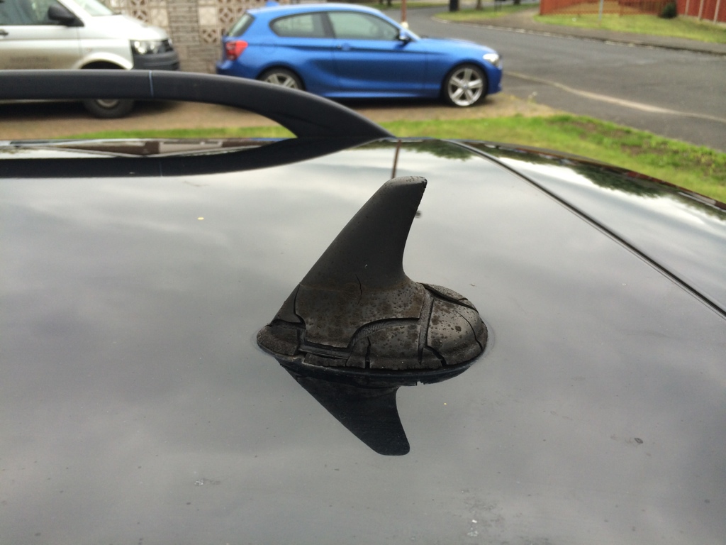

Got some cosmetic bits to sort, new shark fin required

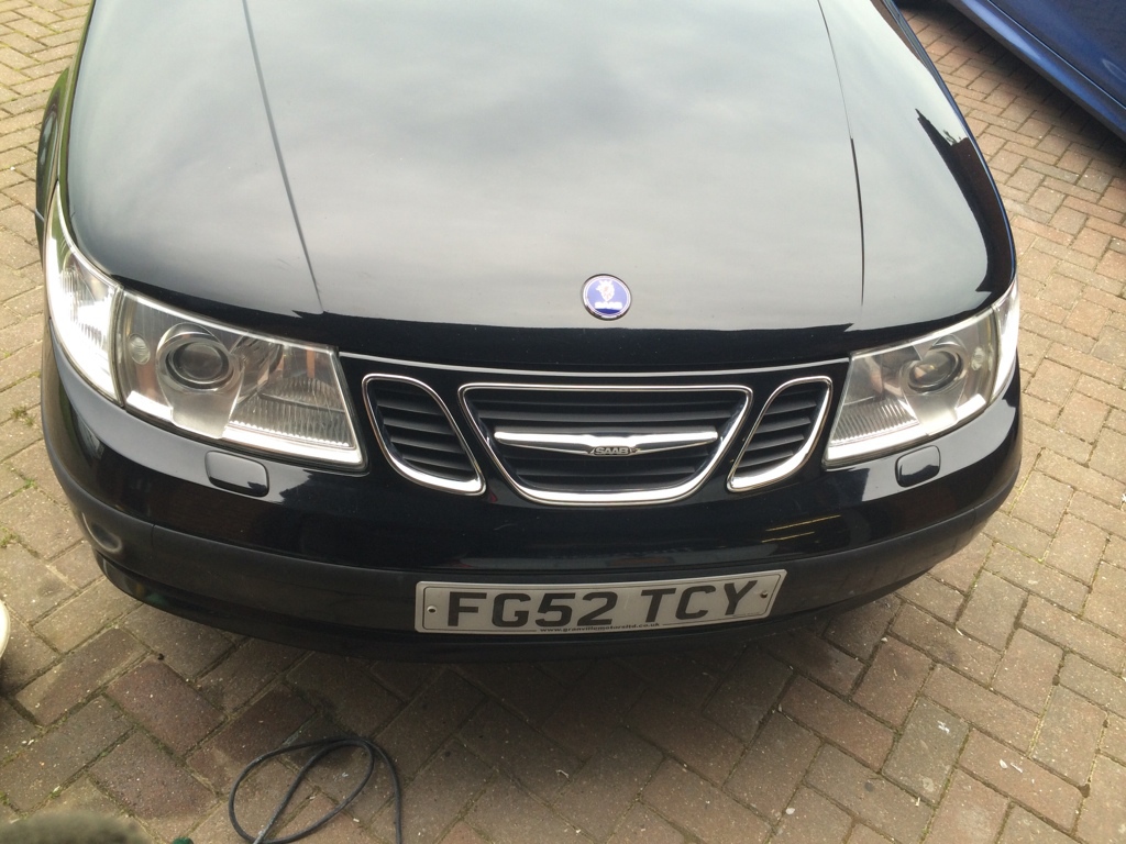

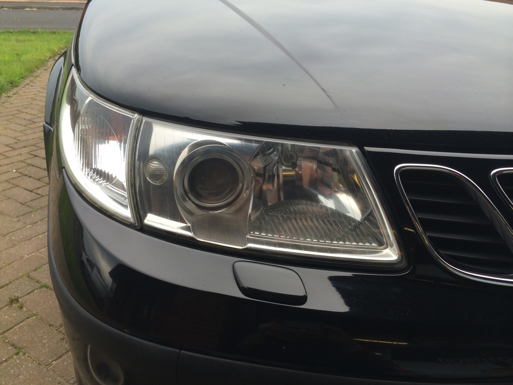

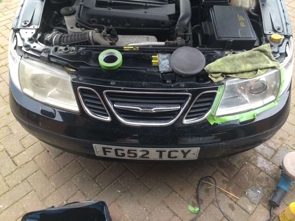

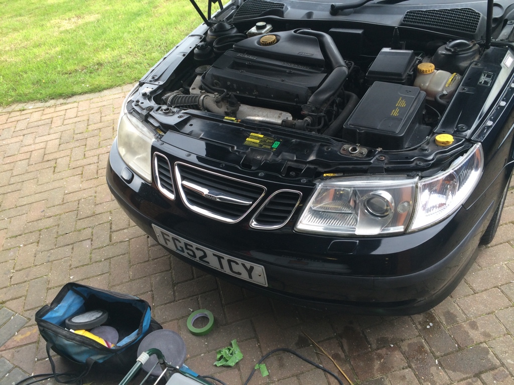

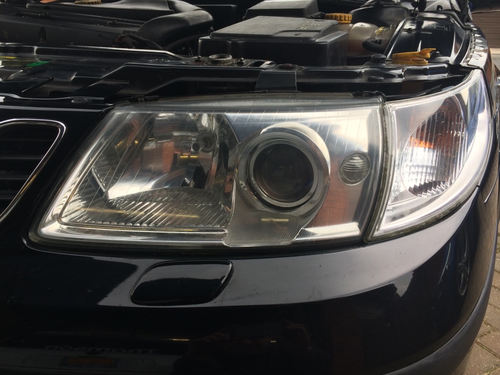

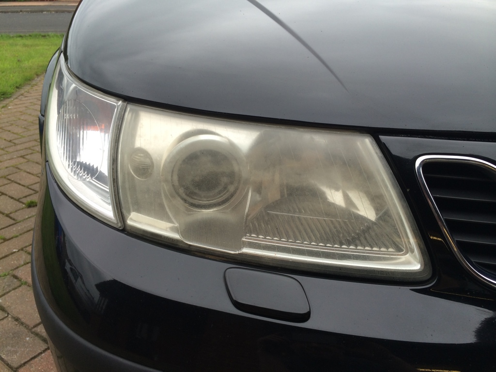

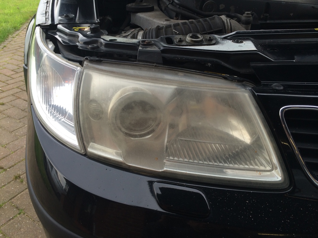

Done a couple of jobs today, managed to polish a nasty scratch out from the rear quarter but more importantly sorted the headlights. Just the usual method of various grades of wet and dry followed by a machine polish with some compound and a final wax.
Before
During
And after
They're not 100% but they're a thousand times better than before. It has however highlighted the fact that the side light bulbs look a horrible yellow against the the xenon main beam + one of the high beam bulbs has gone so I'll see what's available as an upgrade that matches the xenons a bit more and also improves the visibility.
