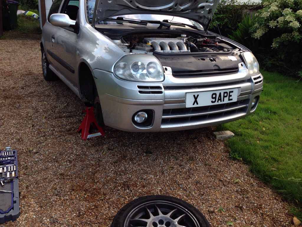

Today I have been tickling my brakes and giving them a cheeky bleed after some spongy madness. The o/s/r won't bleed at all. The brakes feel better but not quite up to standard performance. What can cause one not to bleed? Knackered caliper? Blocked hose? Hoes :)
Picture for fun
