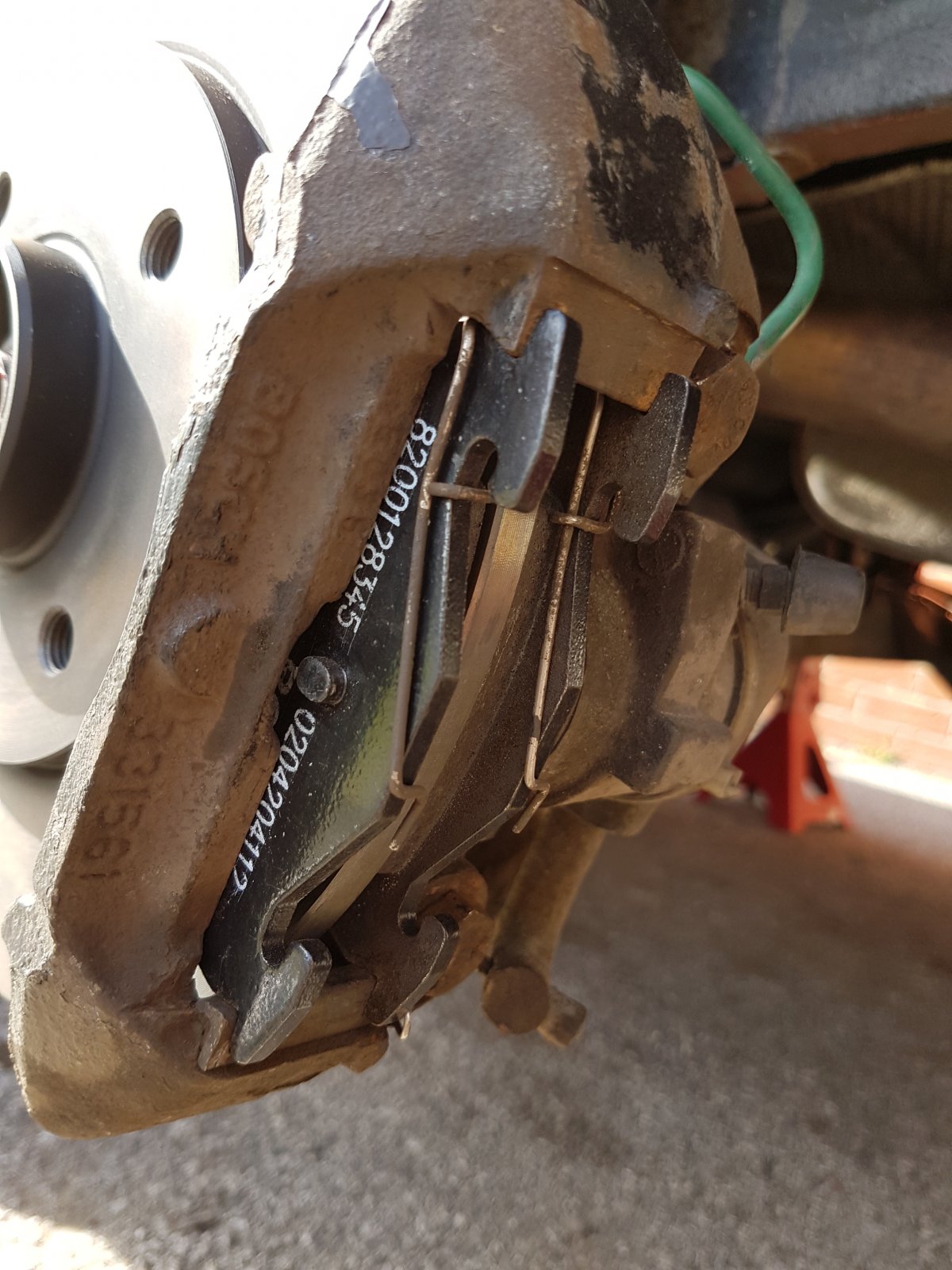

They should be like this

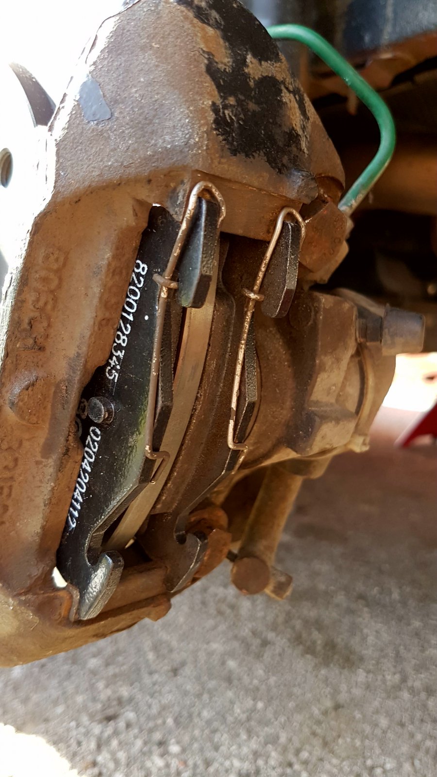

Not like this
Please ignore the calipers, this was before painting them.
  Clio 172 cup
That makes sense now cheers lol haha at the bottom picture lucky I took pictures of mine before taking them apart so I had a rough idea but I was trying to fit the clips before the retaining bar and couldn't get my head round it
