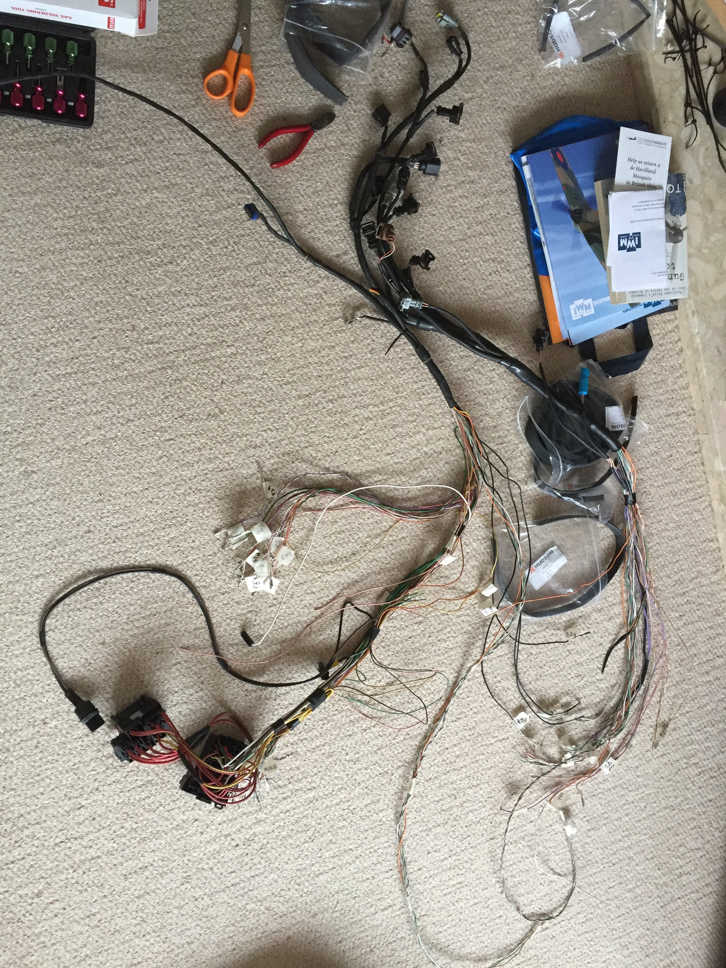

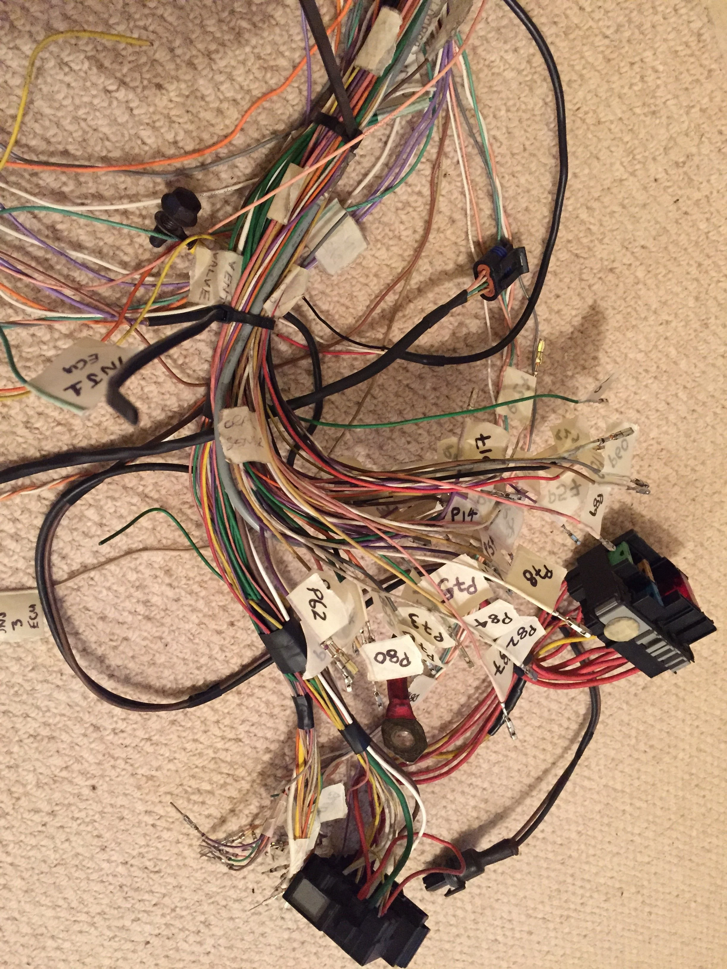

Here's a pic just for fellow wiring pervert @Russ_16v
This just needs the raychem over the top and new terminals crimping on for the ecu plug. Doesn't sound much, but it's still a good few hours of work.

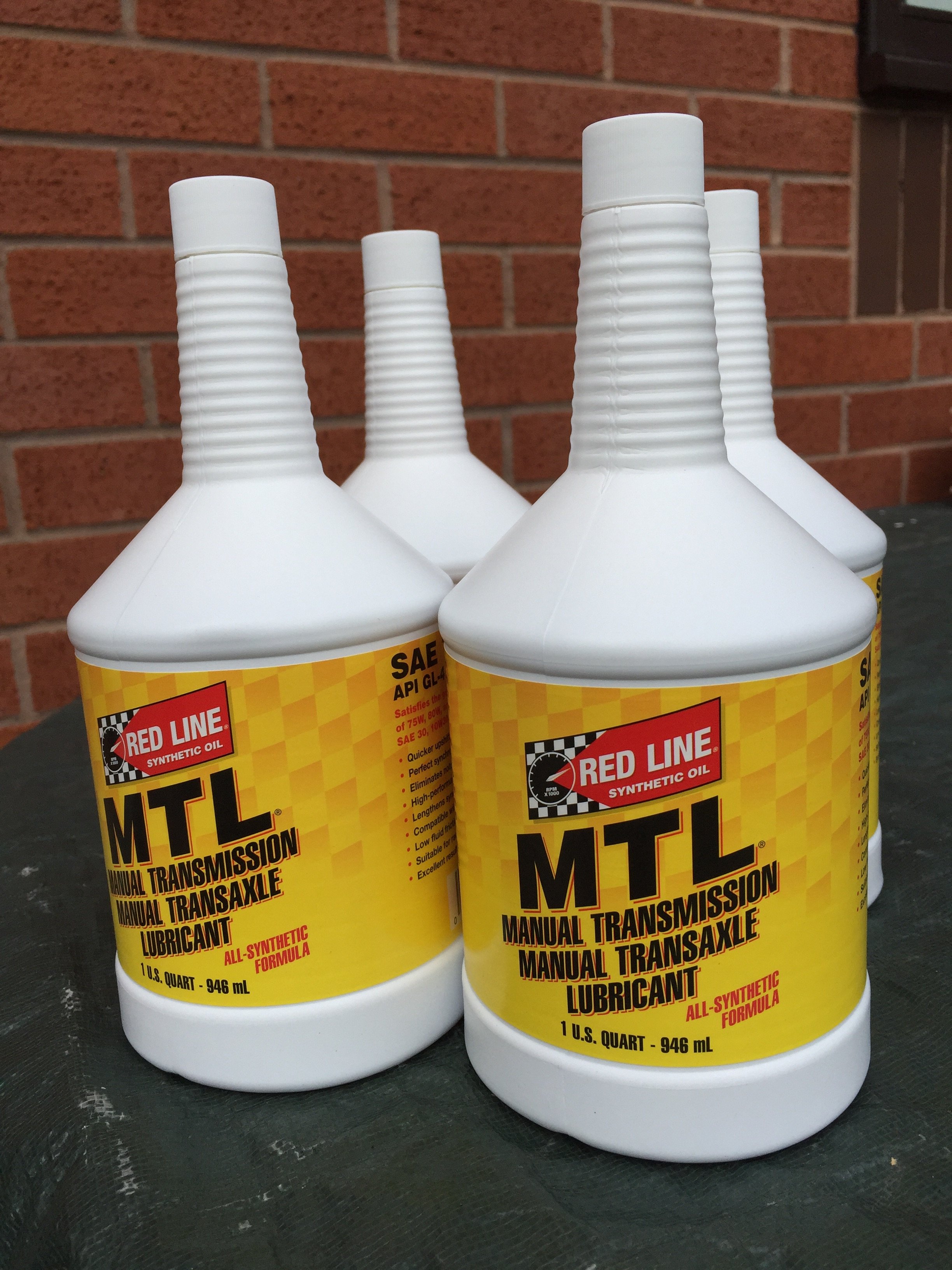

Ordered the gear oil when I was on holiday. This arrived on Tuesday. Redline mtl. Worked wonders in my stressed straight cut quaife gear kit vaux box, so this will do for the Cadbury jc5. Just to put into perspective why I think it's so good, the vaux box was an f20 designed for not much more than 200lb/ft of torque. I doubled this with 400+hp and more than 400lb/ft and when the box was stripped for inspection after a hard 3k of use, zero wear or damage. The box covered over 7k with me in its lifetime and guess what, when stripped for the new owner to inspect it, zero damage or wear!!

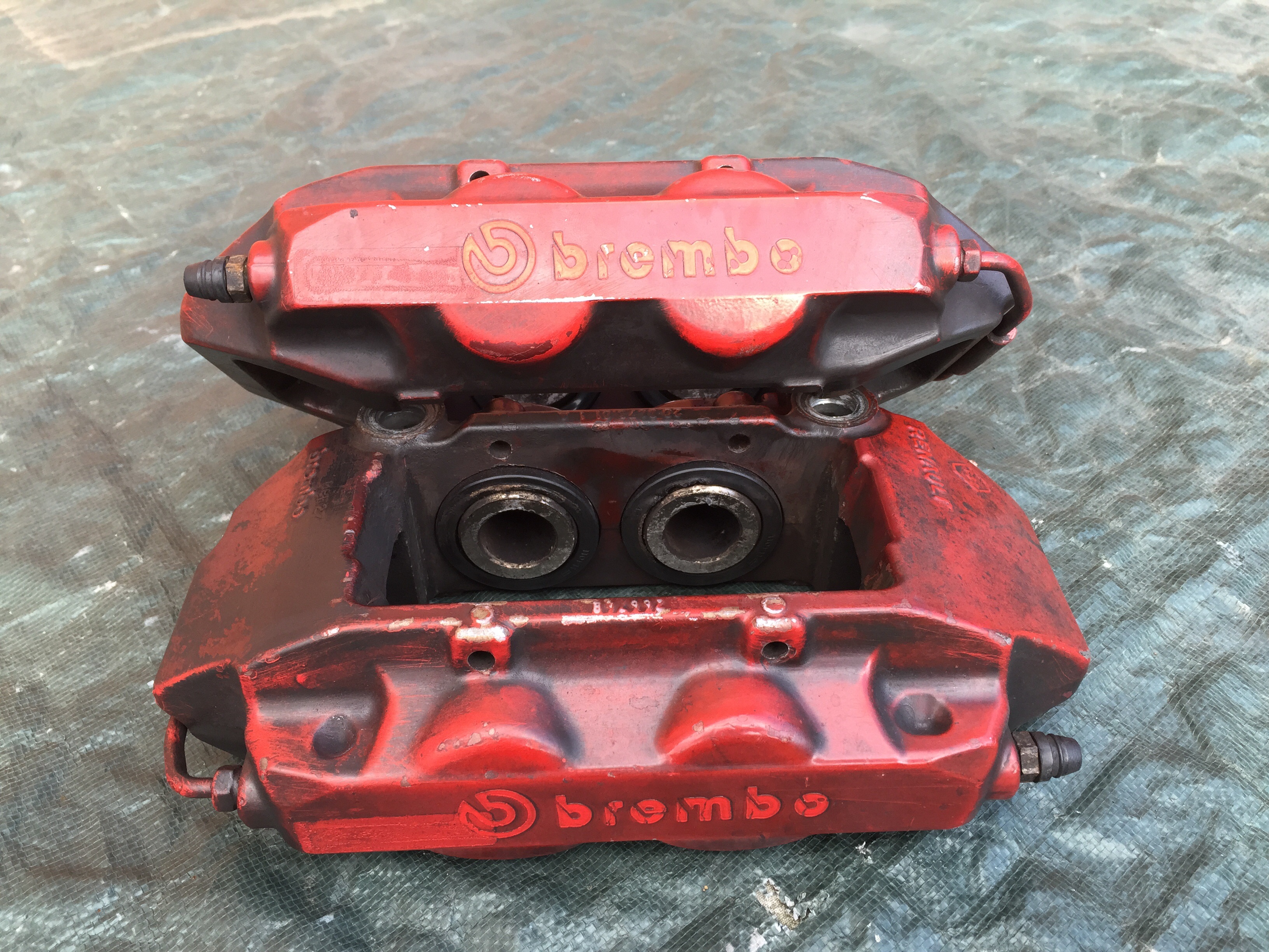

And finally for today, I've picked up these with thanks to @not normal dan. Much cheapness.
Condition wise they need a refurb and some dust covers for the pistons, but they're getting bead blasted after they've been machined. Make the most of it, because this is the last time you'll see them looking like this. :up: They won't be red either. Or green. :wink:

Being as your not sticking to your colour scheme it could be any colour, so i will say black.

Here's a pic just for fellow wiring pervert @Russ_16v View attachment 136552This just needs the raychem over the top and new terminals crimping on for the ecu plug. Doesn't sound much, but it's still a good few hours of work.
Ordered the gear oil when I was on holiday. This arrived on Tuesday. Redline mtl. Worked wonders in my stressed straight cut quaife gear kit vaux box, so this will do for the Cadbury jc5. Just to put into perspective why I think it's so good, the vaux box was an f20 designed for not much more than 200lb/ft of torque. I doubled this with 400+hp and more than 400lb/ft and when the box was stripped for inspection after a hard 3k of use, zero wear or damage. The box covered over 7k with me in its lifetime and guess what, when stripped for the new owner to inspect it, zero damage or wear!!View attachment 136553And finally for today, I've picked up these with thanks to @not normal dan. Much cheapness. View attachment 136554Condition wise they need a refurb and some dust covers for the pistons, but they're getting bead blasted after they've been machined. Make the most of it, because this is the last time you'll see them looking like this. :up: They won't be red either. Or green. :wink:

Ooh looking good! wiring is coming along nicely! Boring fact for you, my Dad worked for Raychem for years and helped design one of the machines that made the heat shrinkable plastic wiring sleeves :)

Ooh looking good! wiring is coming along nicely! Boring fact for you, my Dad worked for Raychem for years and helped design one of the machines that made the heat shrinkable plastic wiring sleeves :smile:
No worries mate, and congratulations on the marriage!
Wiring would be coming along better if I could be arsed to go in the garage. Lol!
How cool is that about your dad! Kudos mate!
