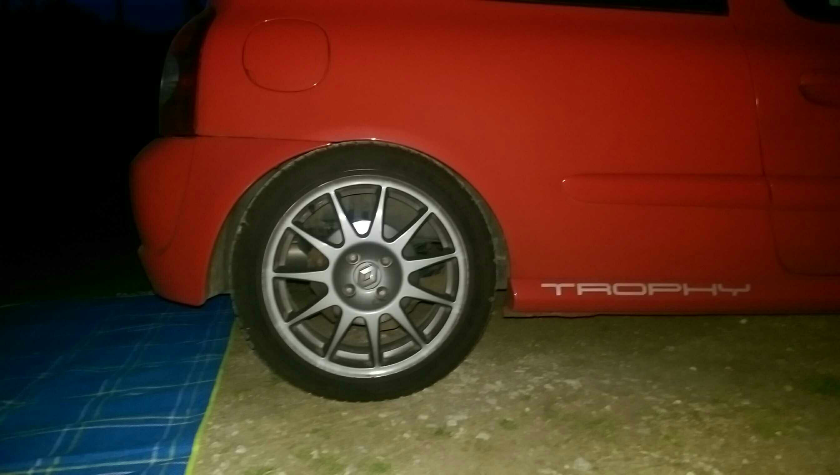

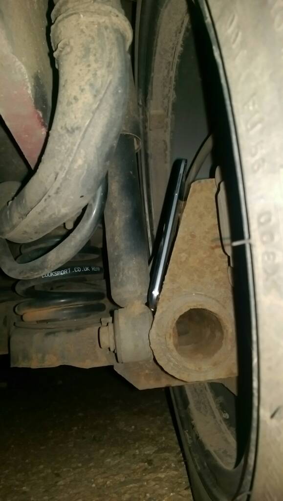

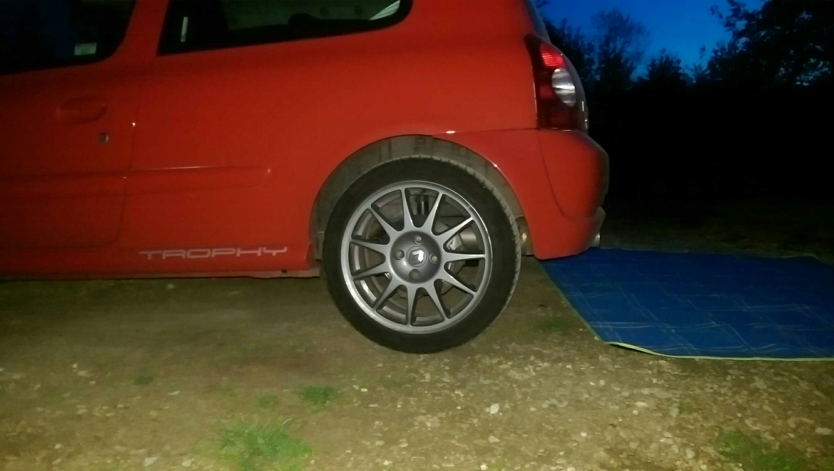

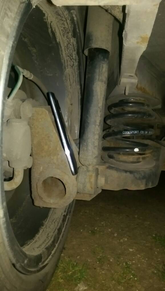

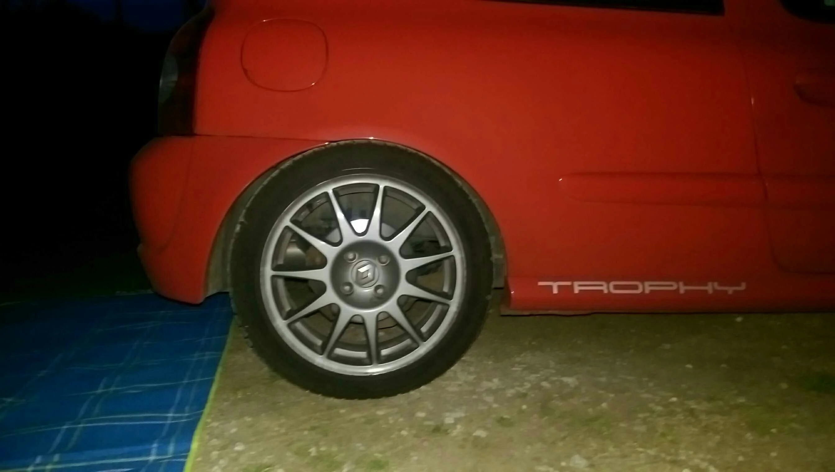

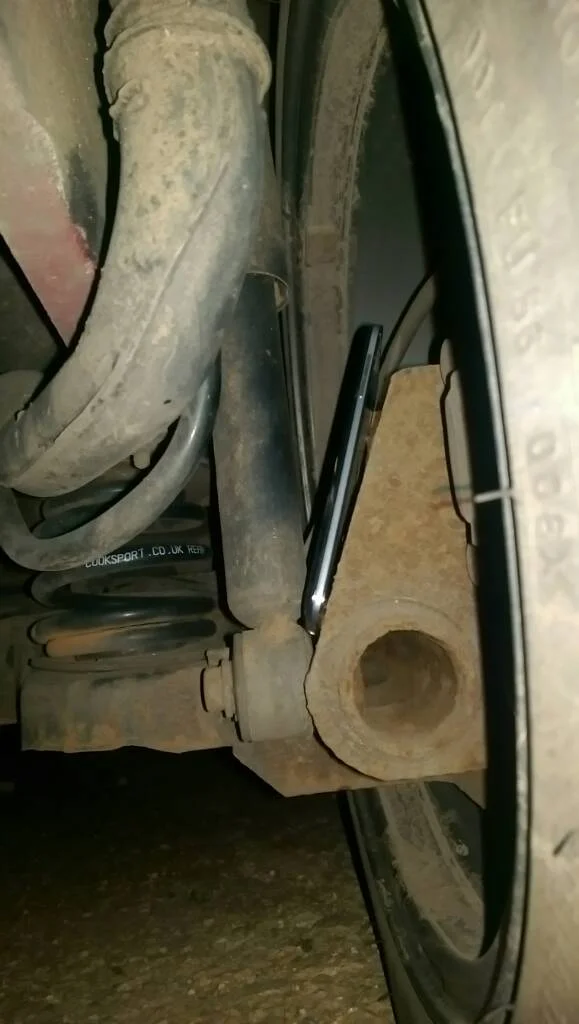

Just noticed that my rear drivers side is way lower than usual so had a little look underneath and took some pics. Used my other phone as a ruler. Anyone got any ideas? Also, safe to drive on?

Looks like that bottom ring on the spring has collapsed vs the other one, so the spring? Get it jacked up and you'll see for sure.
  dan's cast offs.
looks like spring has snapped on divers side. unlikely for it to of collapsed.
seen and heard of a few now, think mark had one on his trophy snap after not long as well?
