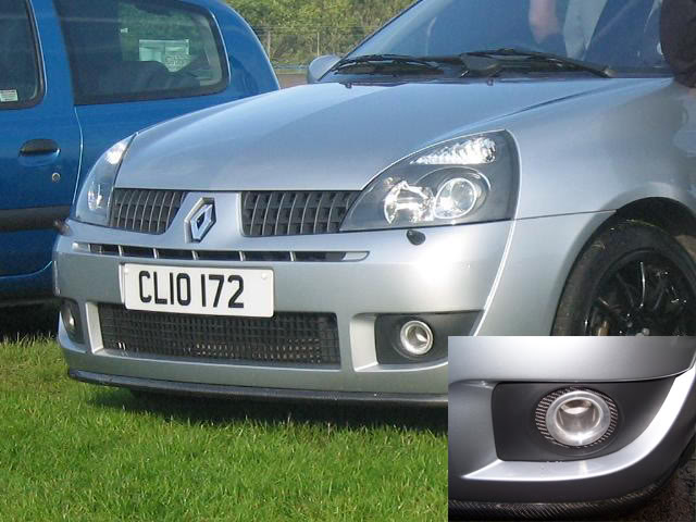

You see these trumpets in just one side often alot of 106 owners take out one of the lights in a morette headlight conversion and put trumpet in
  Civic Type R EK9
Yeh i know but im just going for additional cooling into brake/engine bay
and looks will make people wonder when you go up behind um

so is the ''caf'' just 2 let air in2 the engine bay?
how much are these things, they look pretty cool an i wud like my engine bay alot cooler, coz frm my temp gauge, it sits halfway all day.
  FF Blackgold 182
No but its extra cooling better then nothing!!

To cool the brakes you need them on both sides, and you need to cut a hole in the inner arch. You then run a length of tubing from the fog surround, through this hole in the arch, to in front of the wheel, to direct cold air at the brakes.
What you've done is doing bugger all fella, wont cool anything.
The people that have caf's on one side have them linked to their air filter in the engine bay via tubing.

I know im just trying to justify it LOL its for looks and its going to put some extra air somewhere so its cool lol
  Chelsea tractor
At the moment it's giving extra air to the inside of the arch so I'd guess it'll give you about .0003kg of extra down force and increase the drag co-efficient by about .05 ;)

Course it wont make any diff to performance!! lol its quite a big open space behind there mind and theres slats to let air back out in arch liner at bottom

As for the brake cooling, if you're serious about doing lots of trackdays, remove the other fog light, and get hold of a second trumpet. Pop to halfords and get some flexi tubing, cut a small hole in the arch liners on both sides, and zip tie the tubing in place so it points at the brakes. Easy and cheap enough to refit fogs and fit new arch liners come sale time.
But to avoid cutting anything... Have you thought about uprating your front pads? A set of ds2500's is probably one of the best mods you can do fella, and wont cost much.
