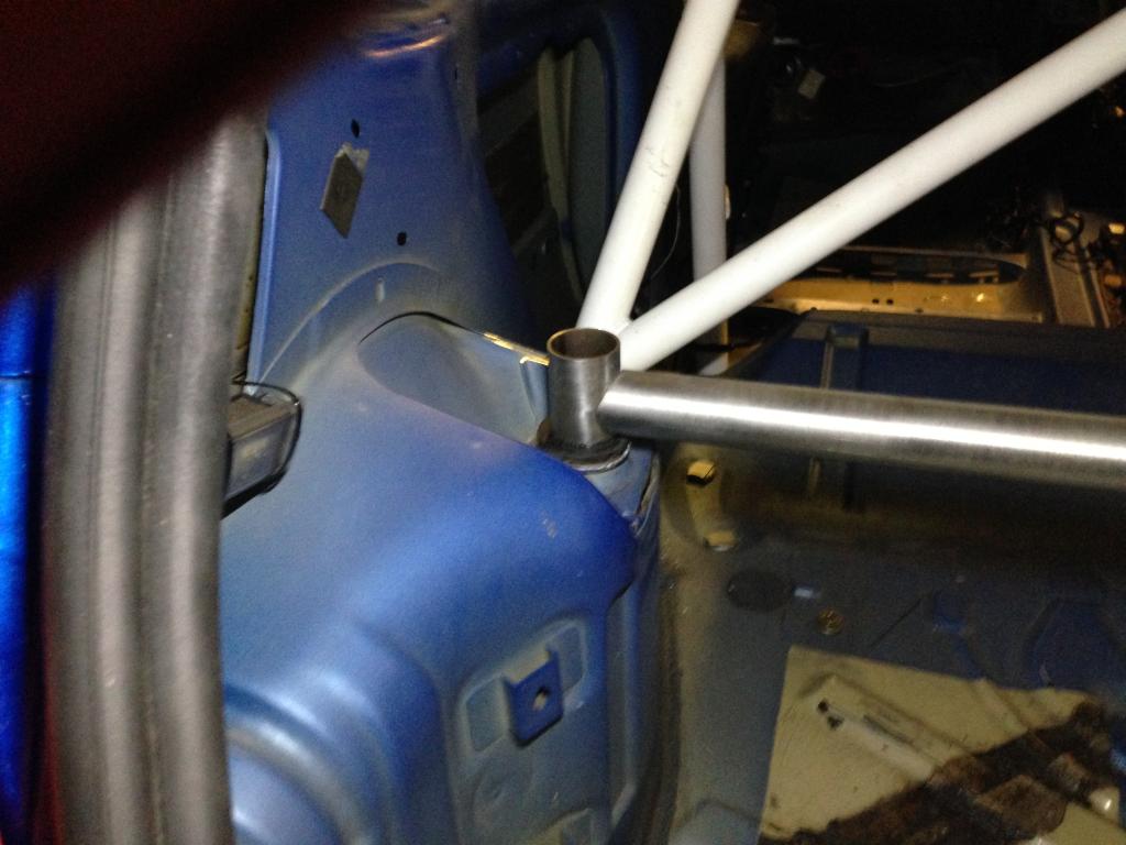

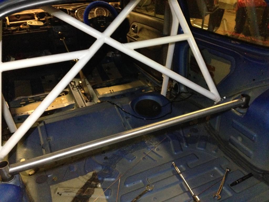

I'm currently in the process of fitting a half Safety Devices cage to my 182 and the guy who is doing the majority of the work is ex WFR engineer so knows his stuff! And is such a decent bloke too! We have both been toying with the idea of triangulating something from cage back to rear damper towers/ strut tops (solid type mount) with a custom nylon bush. So he made a (for the time being) essentially a strut brace that we are looking into welding back to the cage with two pieces.
He is an accredited FIA welder so he wont have any problems getting new certificates made or whatever for splicing into the cage.

I cant see the advantage of splicing to the cage, why not just a brace?
Also if he is talking of certification I'd question his experience, Im pretty sure the 6 point SD cage isnt FIA ROPS certificated, its just built to the basic specs set out by the FIA or MSA blu book. If it was ROPS certified you would not be allowed to make any changes to it at all.
So providing you use the correct materials and the welding is neat and appears to show good penetration, then it will comply. Having said that, is this for track or racing? If racing then many series limit the number of pickup and triangulation points, they want the car safe, but want to limit exploitating too much chassis stiffening.
loggyboy
Also, Its worth remembering when using standard spring pickups, there is very little force on the damper turrets, they dont take any loading of the acctual weight of the car, only the forces exerted when absorbing the bumps, which isnt much. You will be adding unnecessary weight.
