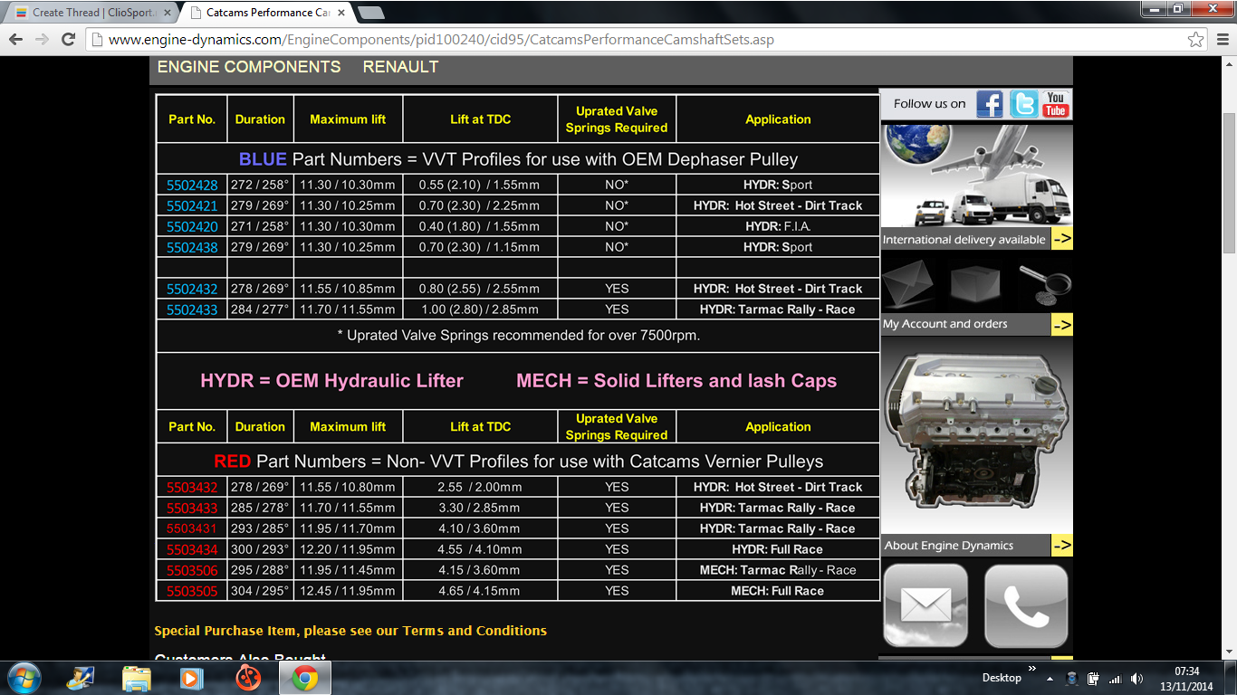

I all ready have a set of 428's in my engine (still a undergoing project) but now iv'e purchased ITB'S and with the car mainly being a stripped right out track car with the occasional road drive i was looking for more aggressive cams, i know a lot of people put 421's but as iv'e already purchased uprated valve springs i was thinking something along the lines of 5502432's or even 5502433's.

What i'd like to know is are there any advantages of going for the more "race" type cams over the 421's?, if someone could explain roughly what these 432's/433's would be like on revs that would be great.
I know that i'll have to compromise on rev range somewhere but what i don't want is under 5k the car not being able to pull at all.

Any explanation as to why not dan, have you had them in any of your previous cars?. From looking at the duration/lift on the 432's there pretty similar to the 421's.

You'll need forged pistons or some other way of gaining valve clearance for anything bigger than 421.
Piper now do a BP285 cam which is similar to 421s. Its £300ish for them to be reprofiled. I've got the one below that (BP270) which makes 207bhp on mine with ITBs so with the 285 you should expect more.
Sell your 428s, send some standard cams to Piper and for roughly £100 you've got yourself a nice upgrade.
Not seen some of those cam profiles before. Maybe catcams have updated their range. Probably worth talking to ED about it.
http://www.catcams.co.uk/acatalog/Renault_clio_rs.html
I think you need high comp pistons, or the std ones machining to have deeper pockets for the valves to go into for 422/423 profiles, which look similar to the 432/433.
There are a few cars on here running 422/423 cam profiles with high comp pistons - you're likely to make in the 220-240 bhp range. From looking at the power graphs they don't seem to be too compromised lower in the rev range.
Not sure it'd be worth the expense of switching from 428 to 421, you're probably talking 5bhp.

Ah didn't realise that it needed work for the valve clearance going over 421's, a bit stupid of a company not explaining that when giving the options to buy cams.
Wow that's cheap in respect for the price cat cams are, maybe i'm a idiot but I always think that you get what you pay for so don't think i'll go down the route of piper re-profiling standard non billet cams i'd rather spend the extra and know that there the proper ones.

Thanks for that mark, I like the thought of having 220/240bhp in something that's going to be around the 800kg mk. Think i'll speak to ED and see what he says regarding gains-££££. To go down the expense of a extra £450 after selling the 428's and only gain 5bhp doesn't seam the best option imo.

Haha cam snob!, thinking about it i wonder if i could use the existing 428's i have and get them re-profiled to 421's?.
NorthloopCup
You could enlarge the pockets on the oe Pistons to run 422's or 423's. Iirc you need to increase the pocket depth around 1.5-2mm.
But those profiles work better with higher comp ratios. You could always fit a set of 197 Pistons if you really wanted to do it on the cheap and not bother with forged pistons.

Thanks for all the input guys really appreciate the time you've taken to write your info, given what has been mentioned I think i'll just get my 428's re-profiled to 421's, going down the 422423 Seams to be hassle and not to mention a extra £1000 on forged Pistons/pins/bolts.
I know i could do the cheaper option and get my standard pockets enlarged or go down the route of 197 but there's still the headwork to get the compression ratio right to get the best out of the cams.
