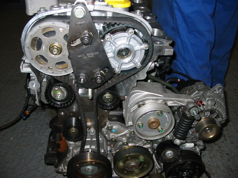

the clio 16/williams dont need the same tools as the F4R engines... these are specific to this engine group... and dont interchange....
all the pullies are friction fit and have no keyways etc.. so the cams have to be locked at one end and the pullies at the other with two separeate tools. there is supposed to be a crank locking tool as well but you can keep that lined up other ways.
http://i4.photobucket.com/albums/y122/AndyGDI/141-4139_IMG.jpg

Andy gdi, thanks for the help, information and even the effort of putting a pic up for me, but you have totally confused me(Im sure half the forum are thinking f$%king idiot) but Im mechanically illiterate. Anyways is that the tool in the picture ( the black plate thingy or is that part of the engine)
Engine looks sweet obviously a new one.
