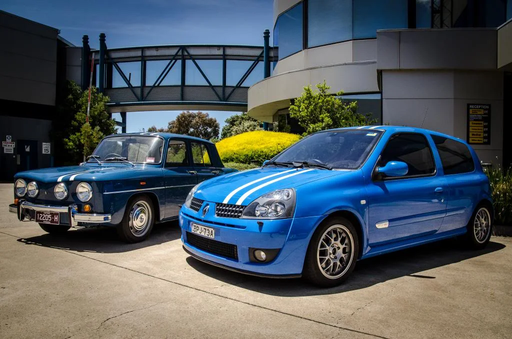

Pic of my beast that is i think worth around 10K as it is a later model and a Cup, fresh box with Quaife and alot of other little goodies.

Nice looking RB by the way especially sat next to that R8. One day, I will have an R8 in my life.
Cub.
Nice RB. Before cams I'd be looking at getting the RS2 custom mapped. What RS Tuner Map has it got on it?
