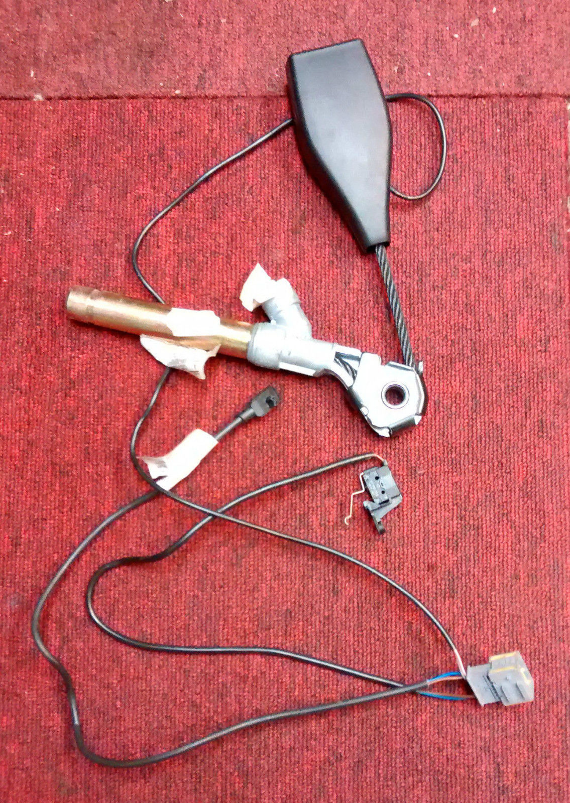

Can someone tell me what this is?
Darren61
I'm trying to trace the reason for my airbag light/SERV light being on and looking under the drivers seat I've found this..
I'm not sure where it should belong? Or if it should be left as it is? Any help greatly appreciated..
Louis
I Park Like a C**t
Is it a connector for the side impact sensors? What car?
Check under the seats right on the edge near the trim.
I could be wrong.
Darren61
It's just loose under the seat sat on the carpet and I can't see anything obvious where it may connect into?
Sorry it's a 182 Cup..
Daz...
  Inferno 182 Cup
If it's the seat position sensor it won't be needed due to Cups not having airbags in the seats.
Edit - I read that wrong..it would be for the steering wheel airbag. In which case it needs to find a home.
Gus
  182Turbo,DCi90

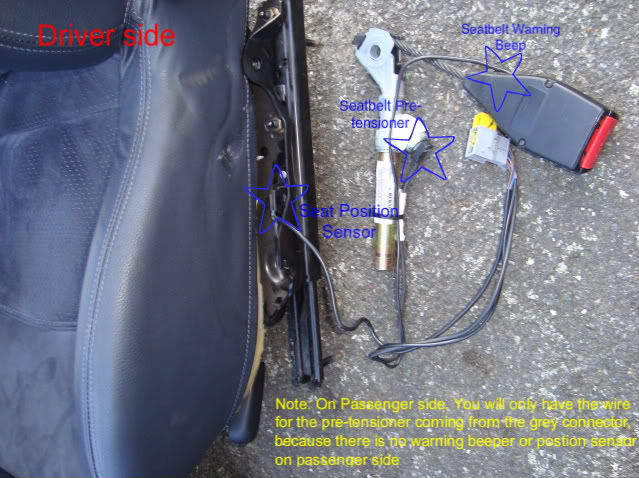

Its the sensor that tells the car if anyone is sat in the seat , use a cable tie to set the cicroswitch to the closed position and leave it at that.
  Megane 225 f1
Dare I ask it`s exact purpose?
Not the 1st time this issue has been raised.
http://www.cliosport.net/threads/microswitch-attached-to-seat-rail.560427/
I`m suspecting the car has had non OE seats at some time.

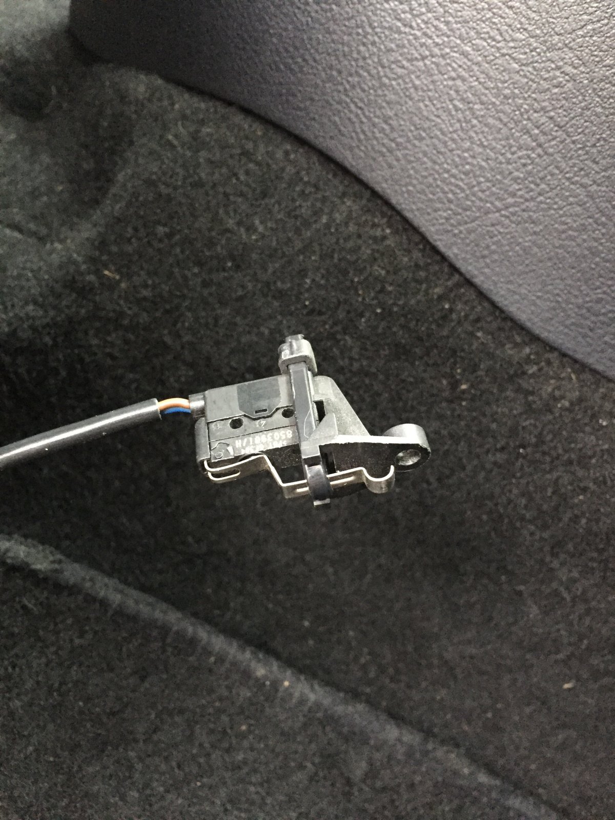

It rivets to the runner and is so the airbag computer knows where the seat is. Imagine you are sat very close to the wheel and the airbag goes off, you dont want it deploying fully. Same as if your sat away from it you want the airbag to deploy fully. Not 100% sure of its location but i know it rivets onto the seat runner somewhere.
  Clio Mk2 II
The switch is normally open.
Pushed and closing circuit when the seat is in the first ca. 5-8 cm from the beginning of the journey (close to the steering wheel)
So, for normal driving it should be left open, not tied. Tied = airbag won't fully deploy.
