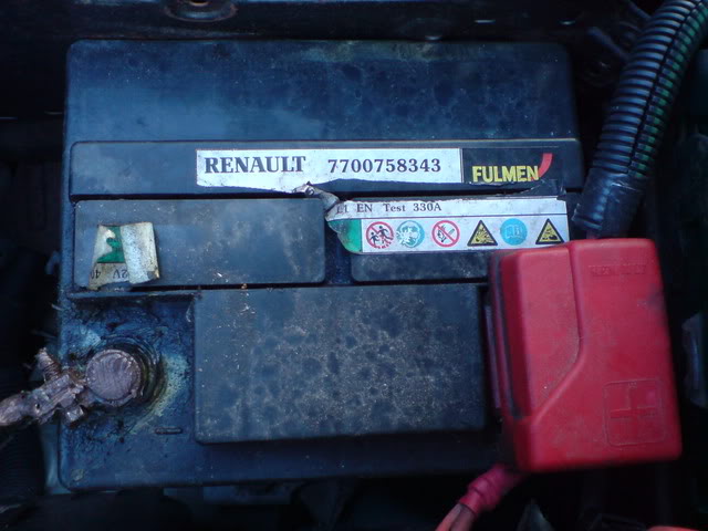

Is this likely to be the original battery? How long do they last? (I know it's at least 4 years old)
