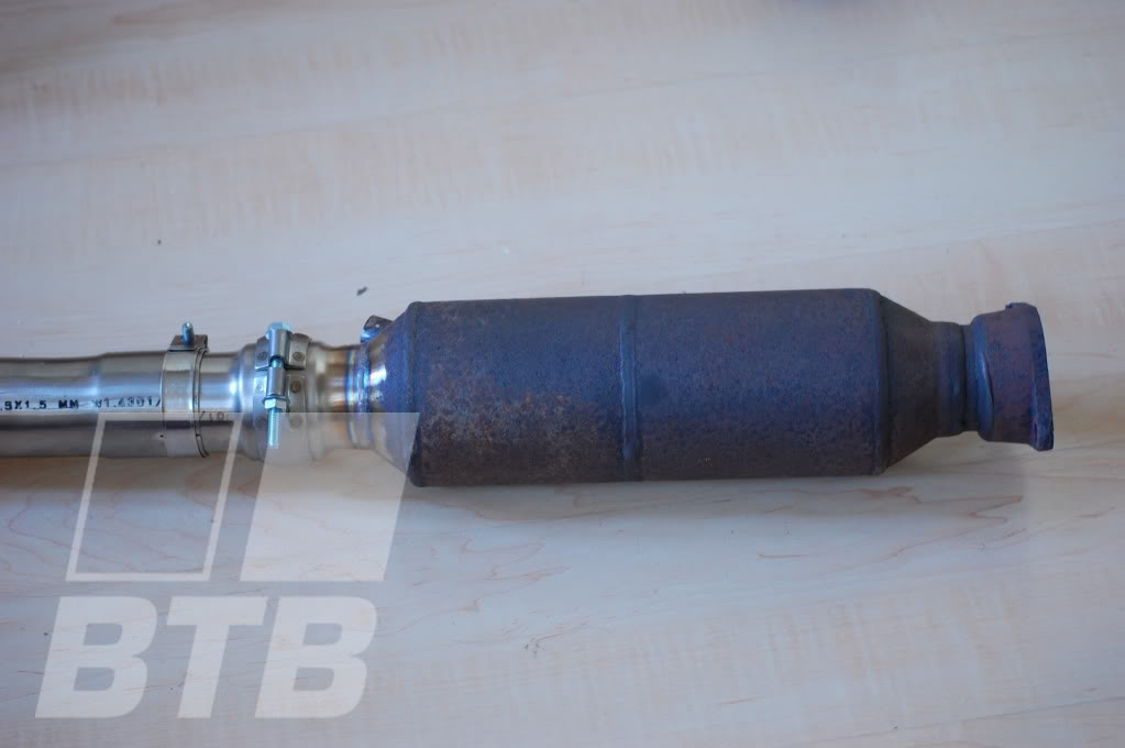

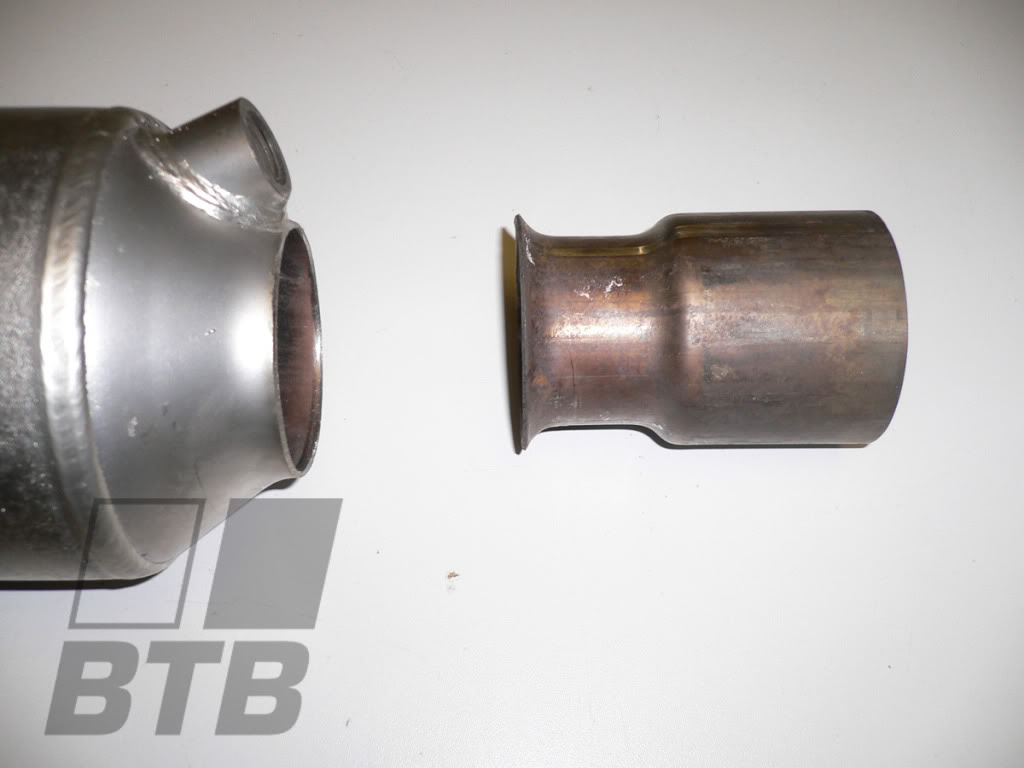

We're mainly talking about the 182 and the bore difference between either side of it's sports cat.
A couple of pictures from BTB to illustrate...
BTB replace the normal join with a tightly clamping joint which is a bonus.
